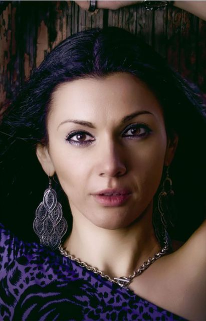

I have been trying my best to get these eyes straight and right and cant do it - I have tried many times in Photoshop and for some reason it just doesn't look right. So I am going to throw this at you all, and see if someone can get these eyes straight and like it should look for eyes. If you want to give it a try I can send the original to you. Let me know.

From a quick glance, perhaps the sclera of her left eye, closest to bridge of nose, should be not so bright. And looking again, maybe my imagination, but the (her) left side of her face seems slightly larger than the right. I realize most faces are asymmetric but this seems accented, perhaps in part by coloring and shading.

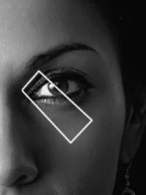

Here's a crop for others to more readily see the area in question.

Thank you Rusty. When a print is made - the eyes are really noticeably off or crooked and makes the print look really weird. Just wondering if there is a way to fix.

Looking at her lower eyelid, it seems as the lighting (assumed Rembrandt effort) has caught a bit more of the eye than just the classic triangle on the cheekbone, giving an uneven illumination to the eye itself as the there is now a key/shadow area cutting through her pupil.
While this appears to be the cause ... the fix that I've tried is to reduce the gamma and exposure for that portion of the eye (near bridge) to better match the farther side so that here left eye better appears to be equally illuminated rather than split down the middle by key/shadow.
In addition to the sclera itself (1st image), I pulled back on the lower eyelid and the bright spot just below it. I also pulled back a bit just below the brow (far side) to try and suggest a more even illumination that doesn't compete for attention with the "triangle". Not dialed in real well, but hopefully you get the gist.

An asymmetrical lighting pattern on a nose-at-camera symmetrical full face view makes a face seem lopsided. The darker the shadows the greater the imbalance perceived. It is one of many optical illusions seen in portrait lighting.
A skilled portrait photographer can use it to make an asymmetrical face look more balanced by putting the key light on the naturally narrower side then adjusting the lighting ratio / shadow tone by eye until balance between the left and right sides looks "right".
"Short" lighting (45 degrees to the side OF NOSE and 45 degrees above eye line)on an oblique view creates a similar illusion because the brain focuses the most attention on the highlighted front "mask" of the face. It's asymmetry (facial angle hides one side of face) + asymmetry (shadows of lighting pattern hide the other side) = symmetrical looking front of the face.
Here we have a very symmetrical face looking lopsided by a poor choice of pattern and ratio. Centered pattern would look more symmetrical on her face. Lighter shadows would be more flattering and a better match to the body language of the expression inviting eye contact.
Read my tutorials on facial analysis at: http://photo.nova.org
The fact the catchlights are at 9 o clock is is also a reason the eyes don't seem to look "right" copy/paste and rotate each eye separately to put catchlight at 10 o clock and compare. Raise bare arm is also a distraction from the face and like the lighting strategy works against the symmetry of the pose.
It's a nice shot, but the perceptual pieces of the puzzle aren't a good match. That's why it doesn't look "right" subconsciously. I just understand what clues trigger that subconscious reaction. Just part of the learning curve I've just helped you leapfrog up...

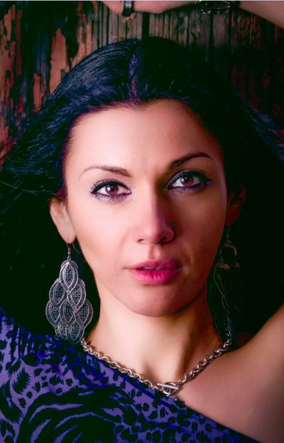

Here's a quick edit in which I lightened the shadows overall with a middle slider levels correction then selectively lightened the nose and other shadows where you side fill got shaded with by the cheekbone with cloning off a brighter skin area. I also rotated the catchlights as I suggested.
Please understand this edit is not a suggestion to fix this one after the fact but rather a suggestion for a more flattering lighting strategy to try next time by moving the key light around towards the front of the face more and using more fill. If you center the fill just under the camera lens you'll avoid very harsh unfilled areas around the nose (fill shaded by cheekbone) and the dark mouth and teeth. Fill needs to reach everything the camera sees to avoid harsh unfilled areas like that in the lighting pattern:
When you approach lighting it can be with the goal of "I want to do a Rembrandt pattern" or "I want to look at the shape of the face and find the most flattering combination of light angle, camera angle and fill ratio". Neither is good nor bad, right or wrong, just different. Set your goal, define criteria for success, then use the criteria to determine if what you tried worked or not.
So if your goal was to do a Rembrandt the original is a success, but I think she's flattered more without the harsh dark shadows. As mentioned I also think she'd be flattered more with a centered pattern. Next time try both and the oblique/short lit combination and decide for yourself by comparison which flatters her most.

Taking RustyBug's crop, applying liquify filter to (her) left side of face, adding gradient in LR4 and backing down sclera another approach - did not fiddle with colors...
Dont' know if this improves or not.

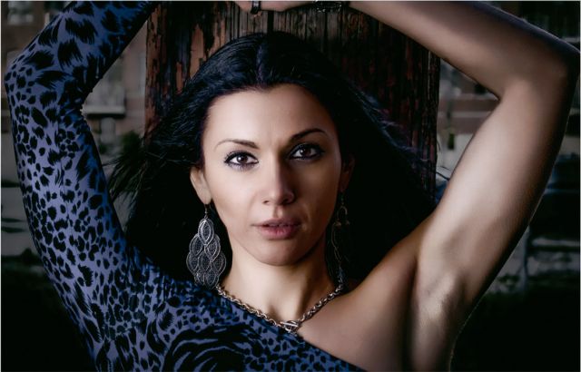

Not to diminish or discourage the retouching efforts by those who don't understand the cause and effect of portrait lighting to the degree I do. The OP should recognize that despite the improvements due to PP, other than cloning out the areas of shaded fill there's no way to fix the root cause of the problem making the lighting harsh and unflattering in this shot: the harsh darker shadow on the nose vs. the one on the side of the face.
Here it isn't a function of the Rembrandt lighting pattern or key light modifier size and wrap, it's due to the fact the shot appears to have been filled with a reflector on the right placed behind the face which was shaded on the right side of the nose and on the right corner of the mouth by the cheek. The upper cheek and lips are shading the fill in the mouth.
Sometimes there is no good way to fix poor lighting decisions in PP. All you can do is learn from them and not repeat the same mistakes next time. To get fill into those areas on the front of the face the fill source must be in front of the face. Fill the shadows with a centered fill source (second flash) THEN add the reflector on the side to nuance them. That's what I did here:
I stood on a stool with camera lens just under the dish "key" light with centered fill coming from the SB with a round mask below attached to the same stand. Two Larson reflectors bounced the key and fill back into the sides for a "kicker" effect. There is a fourth light hidden behind the mat board (to kill spill) lighting the background. I don't have space for two background lights on the sides so I fix white backgrounds in PP.
