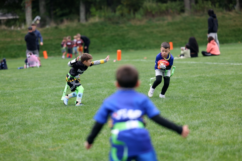

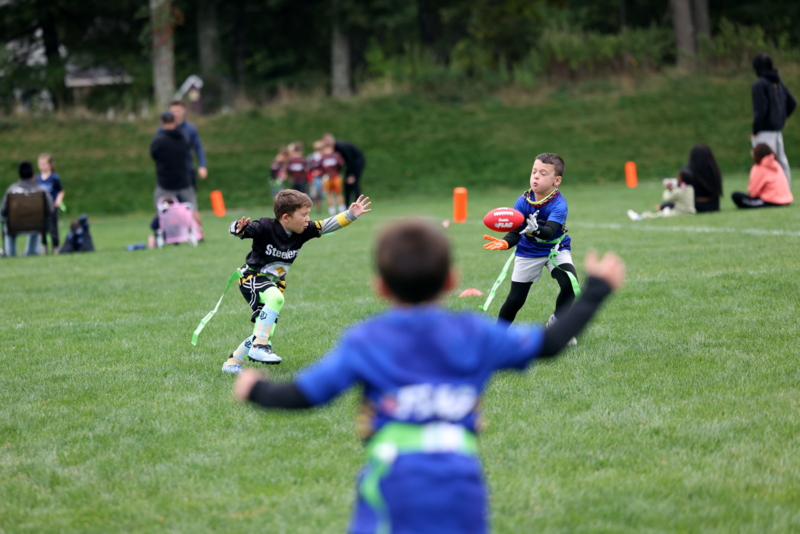

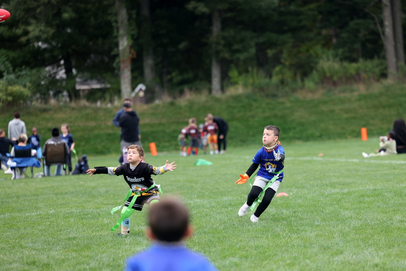

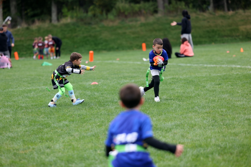

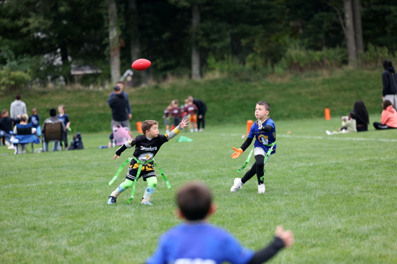

I have a R5 and bought the RF 70-200 f2.8 non Z so I could take pictures of my grandson playing sports. He's going to be 7 next month and he loves any sport that involves a ball and he's very good so he's involved in a lot of the action. He's playing flag football on Sundays so I have been taking some photos. The first game I got some nice shots but I don't think I had the best settings so yesterday I tried a different settings and I think they are better. I wasn't sure where to start my zoom range while also trying to watch the action and anticipate if he would be involved in the action. Any tips on youth flag football or the other sports? I did manage to get a couple of shots of him closing his eyes as he was catching the ball. His mother and father has told him about it but he says he doesn't do that, but now I have proof. This is a 5 shot sequence of a catch and run for a touchdown. The 3rd shot looks like he has his eyes closed, but looks focused. How do we break that habit?

Looking good. I have been doing a lot of youth sports lately, and if you are able to get down low, to their eye level, I feel like that really helps.

Yes, get as low as possible. I sit on a stool since I can't sit with my legs crossed on the ground for too long. If you can sit behind the end zone so they're coming towards you, that's best. The old mantra of sports is "shoot tight, crop tighter". Move with the action or wait until comes to you and fills enough of the frame to get a good crop. The overwhelming majority of images get viewed on phones now so you can crop A LOT and still have a sharp image if the original was in focus.
For camera settings, I'd shoot f/2.8, 1/2500' in sunlight, but not less than 1/1000' if you have the light. I use auto ISO. 70-200 is kind of short for field sports so if he keeps going, you'll want something longer. I shoot almost everything with my 100-400 except the smallest fields or if it's night and I need f/2.8.

It's difficult to say where the right position is because a good photo can happen from anywhere around the field, but as already suggested, if you're covering one team or one player, positioning yourself ahead of their direction of play is generally going to generate the most images because they should be running towards you as much as possible. However, your sample photo illustrates that often a receiver looks back to catch the ball. With football, I'd say it's either from the end zone or 10-15 yards ahead of the line of scrimmage, unless you're focusing on the QB, then ~5 yards behind the line of scrimmage for the classic shot of dropping back to pass. I agree, low angle is good and I prefer it, but watch the background as it can end up looking cluttered. Shoot as much as possible wide open to blur background distractions.
Trying to enjoy watching the game and photographing it might be conflicting interests.
Regarding eyes closed when catching the ball: I don't know what to recommend about that but it's not unique to him because I see the exact same thing all the time with professional NFL players.
