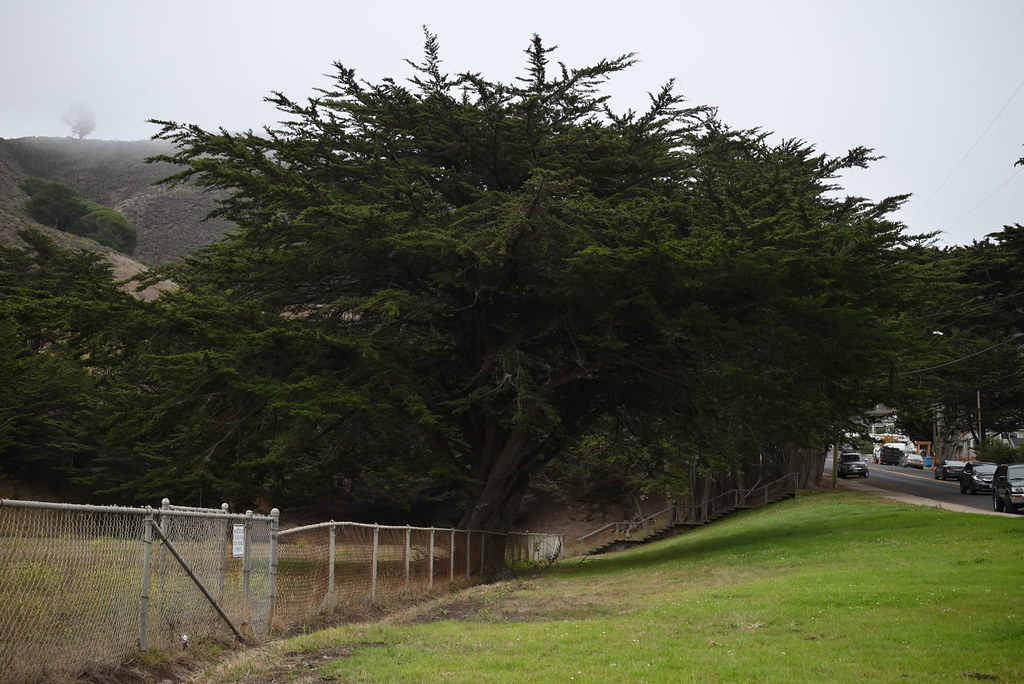

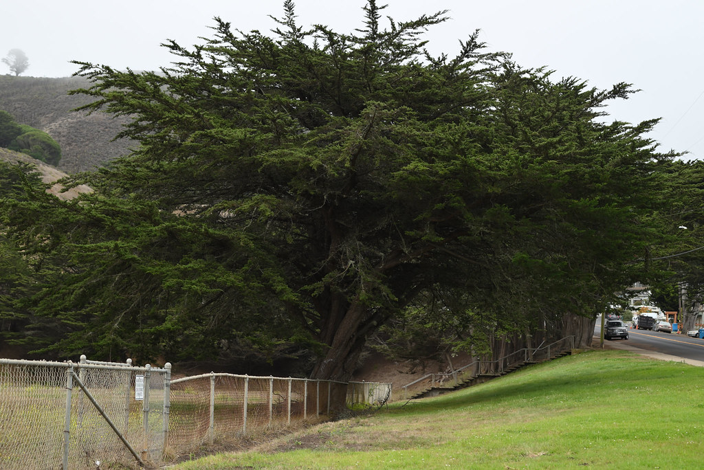

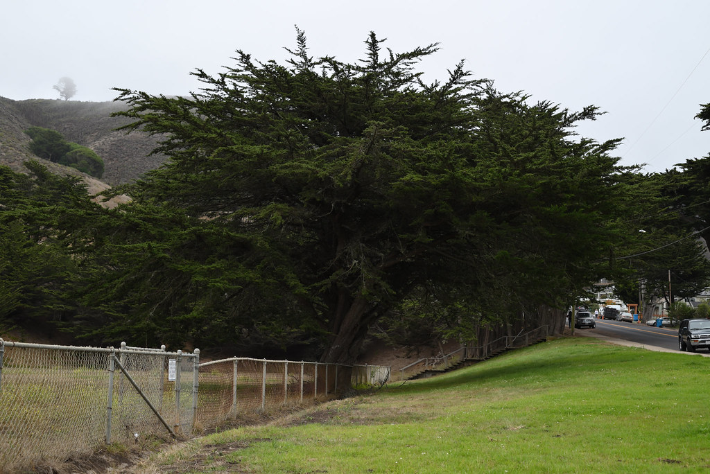

1. Landscape comparison - Zeiss Planar 50/2 M-mount (ZM) vs. Voigtlander 58/1.4 SLII-S Nokton F-mount (VF) vs. Voigtlander 50/3.5 Heliar M-mount (VM)
Taken on my Nikon Z5 (24MP raw [NEF]), Novoflex M-mount/K&F Concept F-mount adapters, overcast conditions, tripod, 5-second shutter delay, F/5.6 1/100s ISO 100, 1 minute apart, re-focused in magnified view on center each shot. First set is the full shot, unaltered except for setting the same white balance. Second set is a center crop where I have adjusted exposure compensation and contrast for each photo to maximize the contrast and colors within the cropped area and equalize for slight differences in light transmission, vignetting etc. The hope is to isolate the color response character of each lens.
Full shot, unaltered except for setting the same white balance:
VM
ZM
VF

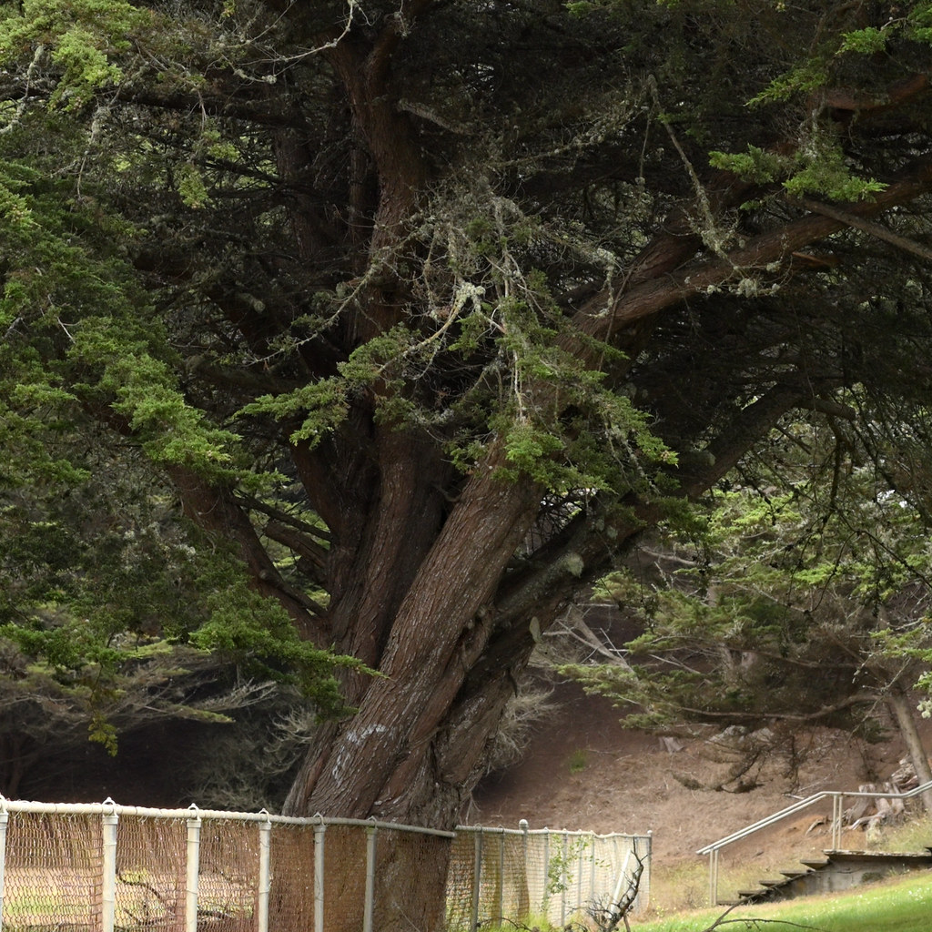

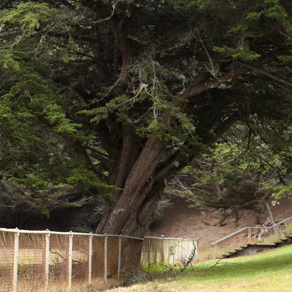

Center crop where with adjusted exposure compensation and contrast for each lens, "spreading the histogram" to the edge of clipping highlights and shadows, as much as each crop could handle.
VM +1.68 EV, +28 Contrast
ZM +1.72 EV, +20 Contrast
VF +1.25 EV, +20 Contrast
Image quality/resolution may be limited by Flickr. Link to full album: https://www.flickr.com/photos/203394938@N05/albums/72177720335331458/
My take on the images, in particular the crops:
Voigtlander Heliar (VM) has a darker warm cast with strong contrast in the reds, which gives the tree trunk good dimensionality, but surprisingly less contrast overall (note it needed the most contrast boost). Or perhaps not surprisingly given how I've been slightly unsatisified with the VM. VM greens are clearly less contrasty, with less "tonality" in the greens as they might say. Voigtlander Nokton SLII-S (VF) is brighter, flatter, with a pleasing but perhaps not-totally-accurate golden tone. VF has less contrast objectively but balanced color, good sharpness in the focused area and smooth focus fall-off makes up for the lower contrast. ZM has good color contrast in all three wavelengths - reds, greens, and blues, as seen in the histograms (not shown here). Some people complain that Zeiss "crushes" shadow tonality, and I can see how its higher contrast leads to darker shadows, but no information is lost in the shadows - we can raise shadow levels if we want, whereas we cannot create contrast if the lens fails to separate tones.
In other areas of the images other characteristics commonly called out are evident: Zeiss Planar (ZM) rendering has a strong center zone of peak sharpness that falls off quickly (the "pop") into a slightly busy blur area. Voigtlander Heliar (VM) is relatively free of aberrations - minimal chromatic abberations, sharp to the corners combined with slower focus falloff creates a "documentary" feel. VM strong red response probably lends itself well to black and white images. Combined with its heavier vignetting, the VM is less satisfying in nature scenes with lots of green vegetation, so I'm optimistic the Zeiss Planar (ZM) will earn its keep where nature landscapes are the priority.
That said, I'm pleasantly surprised by how well the Voigtlander Nokton (VF) does with nature tones and resolution. The lens already shines with portraits with strong subject rendering, low vignetting, and smooth bokeh (at F2 and below) - I should feel comfortable using it more in nature, stopped down further, such as as a one-lens ~50mm hiking solution with family. The Zeiss Planar will be for when I want maximum color fidelity, vibrance, and don't need to have pleasing out of focus background. I've had the best results shooting the Voigtlander Heliar VM in high contrast light (literally noon sunlight in the snow), and less satisfying results in softer light. I suppose that's why they named it Heliar, for pictures in sunlight!

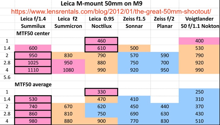

Back in 2012 Lens Rentals did a 'Great 50mm Shootout' on their blog, including a range of then-current M-mount lenses, including the ZM 50/2 Planar.
As you can see from their numbers, it actually kind of underperformed compared to most other options:
That said, it was one of my first M lenses on the M9 before eventually adding a bunch of other 50mm lenses, and never really found it lacking. It was an easy to use, consistently performing lens with good 'Zeiss punch' that otherwise isn't all that unique. Compared to some of my other 50s, such as the 50 Lux ASPH, the ZM does produce quite noticeable sunstars, if you're into those. Also backlit/veiling flare performance is not amazing, but also not worse than the 50 Lux ASPH, which is relatively susceptible to veiling flare.

Cool, that LensRentals blog didn't come up in my research. Good data.
I'll note that the LensRentals analysis is purely about fine resolution - MTF50 specifically, and not other lens characteristics. As they wrote: "Color rendering [emphasis added], autofocus accuracy, chromatic aberration, build quality, flare resistance, and a dozen other real-world considerations aren’t considered at all."
In terms of MTF, the Zeiss "microcontrast" look is supposed to be about higher MTF at coarser resolution (e.g. 10 lp/mm) rather than fine resolution (MTF at 50 lp/mm).
Still, saying the Zeiss Planar MTF50 underperformed is putting it a bit strongly - the values are only 10-15% lower than the Leicas, and they are on par with the Canon and Nikon lenses. At 24MP I'm less concerned about ultimate resolution.
My comparison test has congruent results - the Zeiss shows similar resolution to the Heliar and Nokton. Where the Planar stands out is color contrast and balance. I'm sure the Leicas perform well with color too!

I'm not saying the ZM is a bad lens and of course sharpness isn't everything. I still have it after all these years. However, even on 18 and 24MP, at f/2 it's not as strong in fine detail sharpness/contrast (micro contrast) as the 50 Lux ASPH at f/2. But the ZM does have that somewhat intangible 'Zeiss look' that many are after, at least to some degree.

Agreed, it's not amazing at wide apertures. I'm evaluating it for use at peak sharpness/contrast around F4 or F5.6. At F2 the Summilux does blow it away by 70% in LensRentals' MTF50!

I've come across this chart before, and it always makes me scratch my head. The Leica 50mm f/2 Summicron significantly outperforms the Zeiss 50mm f/2 Planar here. Both share a similar Double Gauss design, but plenty of anecdotal feedback, usually rates the Zeiss as the sharper, punchier lens. LensRentals' MTF data doesn't really reflect that. What does match my own testing, though, is the center performance of the Leica 50mm f/1.4 Summilux ASPH. at f/2. It's easily one of the sharpest lenses available (center and f/2+), only outpaced by the newer APO designs.
