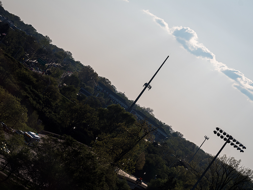

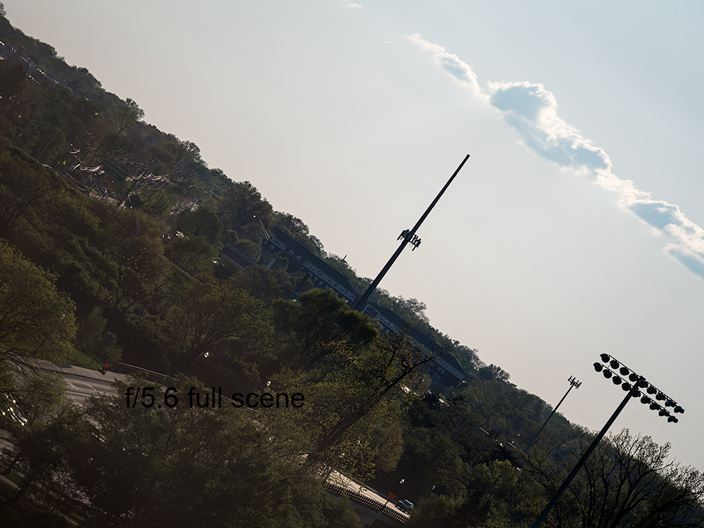

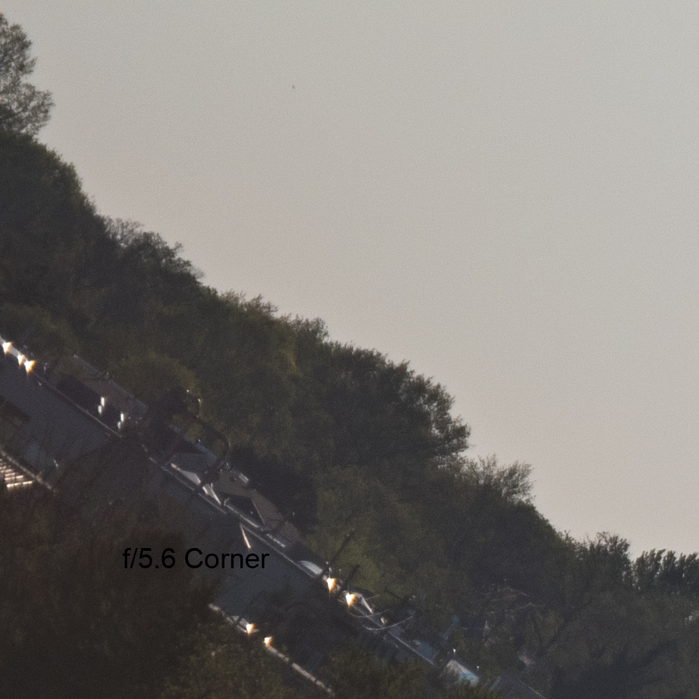

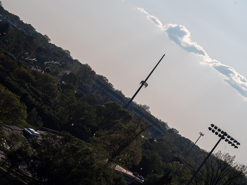

I recently got the Hassy 250 Superachromat for my Fuji GFX and here are some infinity tests with it at f/5.6, f/8, and f/11. The extreme corner gets a little sharper going from f/5.6 to f/8, but otherwise all apertures and across the whole frame the lens is very sharp. I find it to be noticeably sharper and to have better CA correction than the Leica R 180 f/3.4 APO I used to own (the Hassy 250 SA is a FF 35mm equivalent of about 180 f/4). I wish I could test these lenses side by side, buy my Leica R 180 f/3.4 APO was stolen. In any event here are my test shots. I just corrected them for exposure and they have default sharpening in lightroom. First, is the entire scene, followed by centre, mid zone, and corner.
this is f/5.6
this is f/8
this is f/11
May 10, 2018 at 11:21 AM

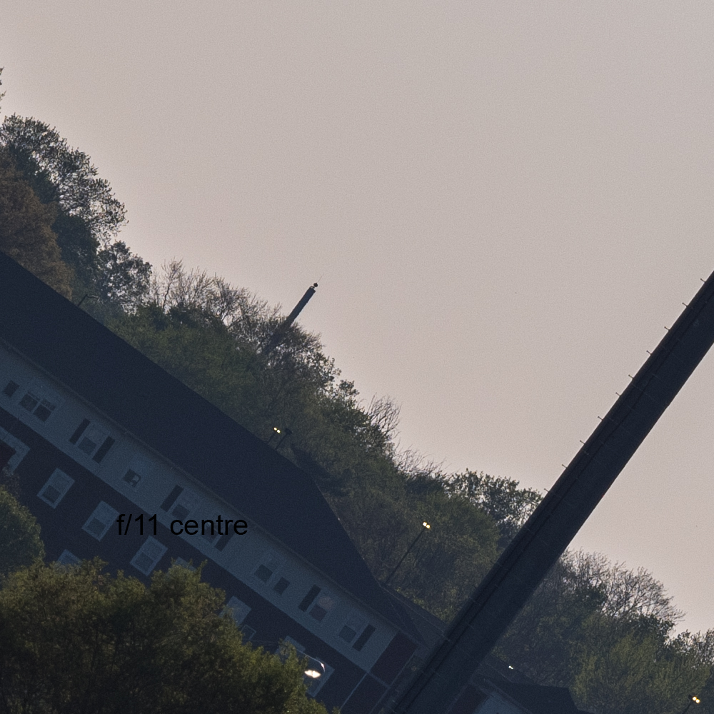

Steve Spencer
p.1 #2 · Hasselblad C 250 f/5.6 Superachromat on Fuji GFX
Here are the centre resolution tests at full resolution; not much difference at all to my eye, but perhaps f/8 is a little better
May 10, 2018 at 11:23 AM

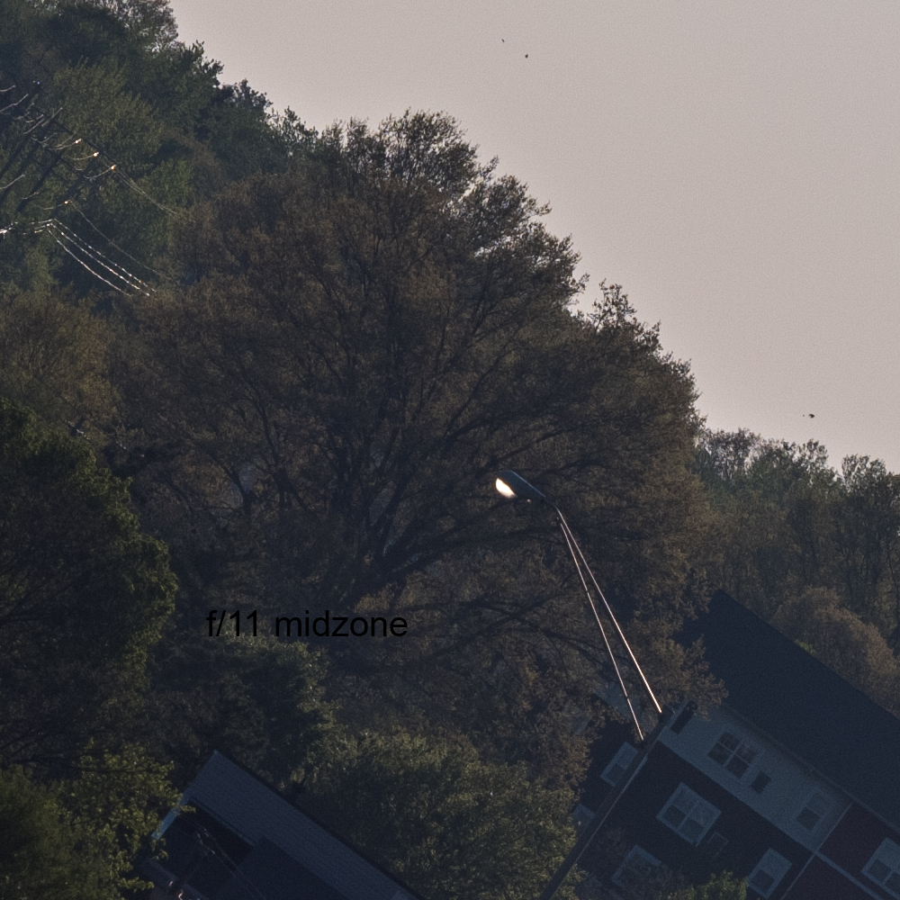

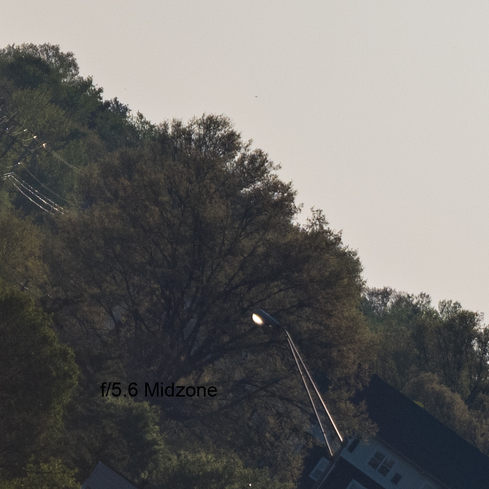

Steve Spencer

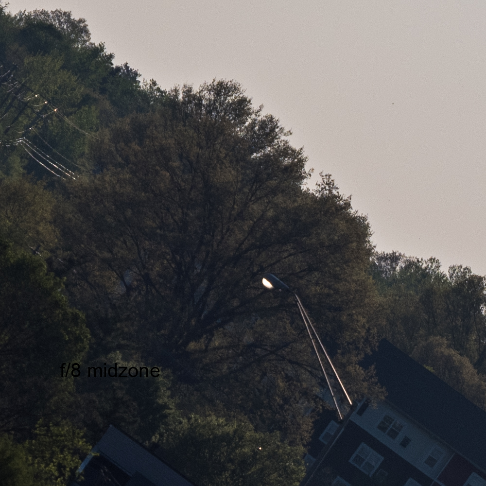

p.1 #3 · Hasselblad C 250 f/5.6 Superachromat on Fuji GFX
Here are the mizone crops. Again these are full resolution, and to my eye very little differences.

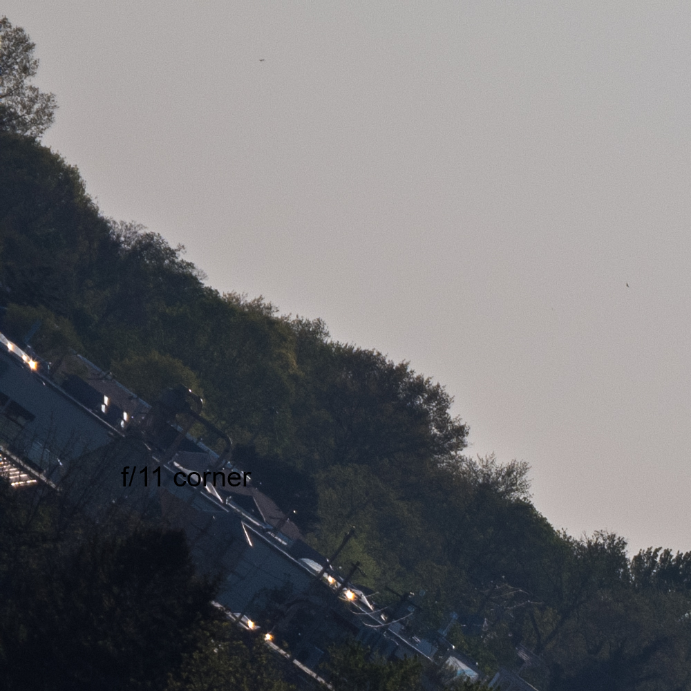

Steve Spencer
p.1 #4 · Hasselblad C 250 f/5.6 Superachromat on Fuji GFX
Here are the crops of the extreme upper left corner. Again full resolution, and here f/8 and probably f/11 too are little better than f/5.6

Nice shot! I think you might want to straighten the horizon a bit, though...

Damn, I thought I had it straight too. I guess the bubble level on my tripod must be off
Ever so slightly.

Well, it is the corner performance on the GFX. I didn't say I was looking at the corner performance of the lenses image circle, just the corner performance on the GFX. And yes, part of the reason the corner performance is quite good here is no doubt because the lens has a much larger than needed image circle.
With regard to the Leica R 180 f/3.4 APO, I did use it primarily on a FF 35mm sensor, and that was what I was referring to. Even though that wasn't what I was talking about, I did test that lens on the GFX and it does have a big enough image circle to cover the 44X33 sensor but then it has a different look and you really notice its very long minimum focus distance.
With regard to the slanted horizon, I borrowed that technique from Fred as a way to make sure you get something in the corners to examine performance there.
