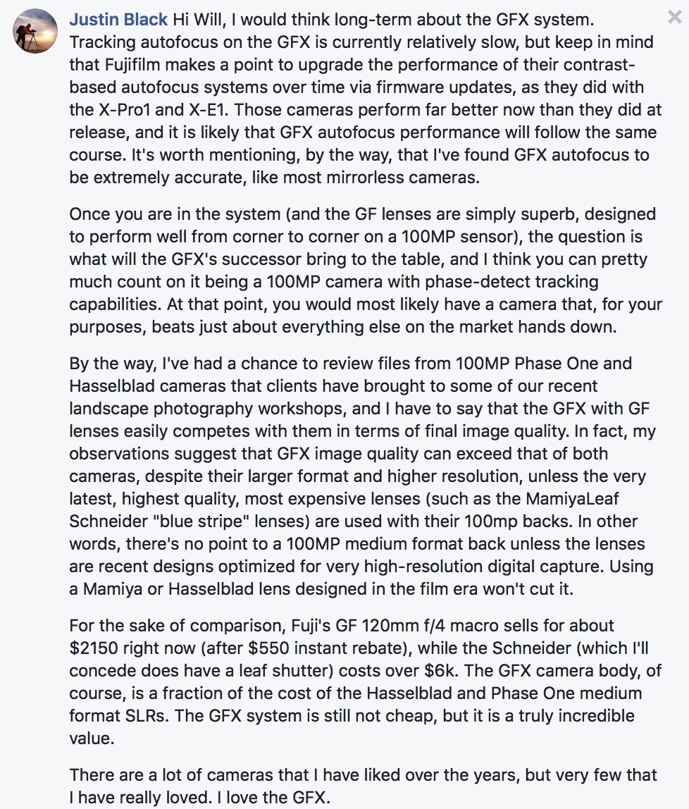

Yeah, I'm not sure why, but regardless of the Lightroom profile I used, the colors I could get from the 5DsR file never approached the reality I saw in the viewfinder, at least not the way they did with the 5D and 5D MkIV. But I should specify that it was not with every scene that I had the issue, it was mainly high-contrast scenes of clouds over a landscape at sunset. Living near ABQ, NM, the altitude here is about the same as Denver, but we have incredibly dry air and clear skies. These conditions make for extremely-intense colors at sunrise and sunset, and not every camera I have used has been capable of reproducing them. With the 5DsR, I found that the more extreme the contrast of the light source, the harder time it had rendering rich color, and the more neutral a scene would render (for example, sunlight across a snowstorm in Colorado at around 10K feet. I suppose it feels like they sacrificed a bit of color IQ for the sake of extreme resolution, or like you said, maybe they decided on a more sophisticated color palette for the 5Ds. For what it's worth (probably not much), but DXO shows the 5Ds with a slightly better low-light ISO performance and a scant difference in Color Depth – probably not much to make any difference, but it would seem to point toward there being some difference between the two.
Regarding the GFX/MiniMF, I thought you'd find this quote from the GFX Facebook user group interesting. It doesn't change the fact that the 5DsR is meeting your needs, but it might give you some insight into the GFX's performance versus larger MF digital products. If what this person is saying is true, it would negate the need to differentiate between a MiniMF and larger MF digital – at least as far the end results go.
