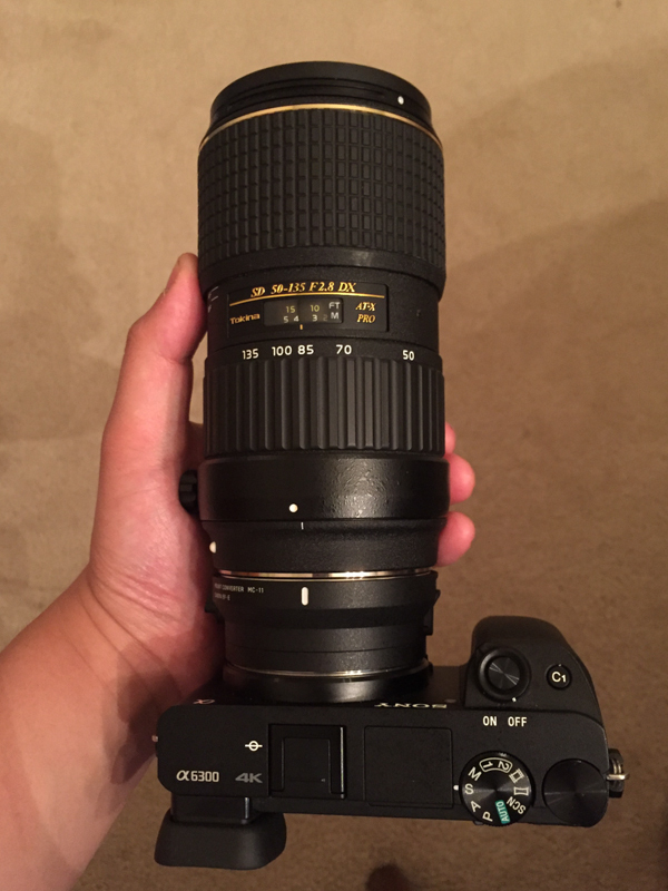

p.15 #15 · Sigma MC-11: Compatibility, Performance Thread.
I tried the very underrated and not well known Tokina 50-135 2.8 lens (APS-C). I used it on the Sony A6300 via MC-11 adapter, and it is quick to focus and very accurate in good light in AF-S and AF-C. It hunts a little bit in low light, but it is still very good. If you don't plan on upgrading to full frame in the future, this lens is highly recommended. Very sharp and well built lens. Although it's built like a tank, it is surprisingly small and light, especially compared to the 70-200 2.8's from Canon and Nikon. This is a lens that you won't get tired bringing around with you all day. Keep in mind this lens does not have any image stabilization, but it's not a hindrance to me. However, if Sony makes an APS-C mirrorless camera with in-body stabilization in the future, this lens will be even more of a treat to use.
