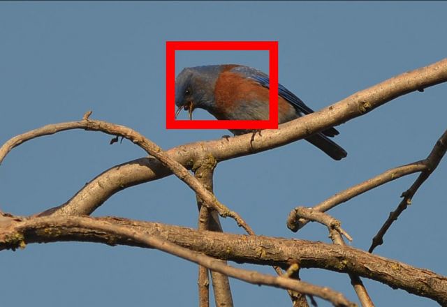

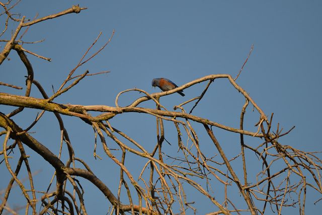

I've had some difficulties in AF fine tuning.
Mainly because my eyes are not good enough to tell where the sharpest point is.
The images I got from D800 with 300mm/2.8VR+TC17 combo has been pretty soft, especially in low light. I think I had finally fine tuned close enough, but not nailed it.
Please examine image below and suggest how much more adjustment is required. Any and all suggestions will be greatly appreciated.
Steve
SOOC resized to 900 pixel wide & screen shot of focused area 100% crop below.

Really hard to tell from this type of image if you need any fine tuning at all or if it's something else. Did you tune under controlled conditions or just shooting real world?

The Exif is showing DX mode but NO indication of any TC being used. Looks like
you're still slightly front focused...subject is really not the best way to "dial it in"

You're right, Will. I forgot I took the TC off for this shot and others to fine tune. I didn't use this subject to fine tune. Rather it's already fine tuned (at least I thought I did).
I shot this bluebird to see if my tuning was done right. I thought it is still slightly front focusing(tree branch is in focus) as you pointed out. I'll work on this. Thanks!
