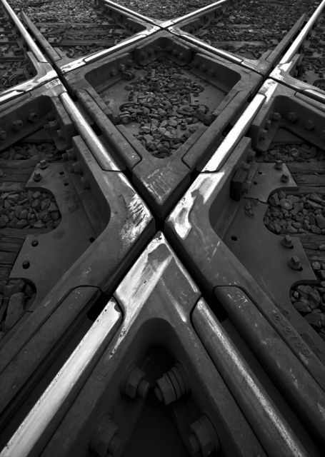

Yet my last printing was @ my local Staples (nearest lab is 70 miles away) and I received awards in (regional) competition (i.e. not hindered by the printing). Granted this printing was only 12x18 (trimmed to 12x16, matted into 16x20 frame), but the image "held up" in competition without using the "fussbudget" approach (despite my typical "fussbudget" tendencies).
My typical "fussbudget" advice is in line with Uwe Steinmueller's advice at matching dpi and "native to the printer" rastering ... which typically means, call your printer and let him guide you to what dpi you should be preparing your file to be printed at. But since you're doing your own, and it is only going to be at nominal print size ... just go with the OEM recommendations and you should do fine to start.
There is a time & place for "fussbudget" ... and in those instances where it is needed, it is valid for consideration. But for getting started ... hit "Print" and go from there. "Fussbudget" can wait (for now) while you enjoy the "KISS" approach ... even though it may prompt a future desire for a "fussbudget" approach someday.
Despite my "fussbudget" tendencies to align dpi/rastering/file size/print size/etc. ... they all play "second fiddle" compared to aligning my comp/crop for intended print size ... i.e. it gets printed at whatever fits.
Here's the one I took to Staples (hard to believe the "fussbudget" me actually did that) for a competition.

Because of that RustyBug's train tracks photo with strong contrast would stand up well to extreme enlargement. Bifurcator's shot of the sand dune? It will look like a tan blob.
