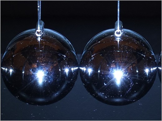

Okay so I checked into the blooming issue. It is called the white orb issue and Fujifilm will fix under warranty by replacing the sensor with a new one. (as long as the camera is less than one year from date of purchase) I purchased my camera 4/24/2012 and I have the receipt and will send it in this weekend for the replacement. Their rep stated two to three weeks for the repair. Turns out my camera's serial number is 14Axxxxx which unfortunately is one of the first lots manufactured. My bad luck, but whoever buys it will be getting the fix and new sensor!

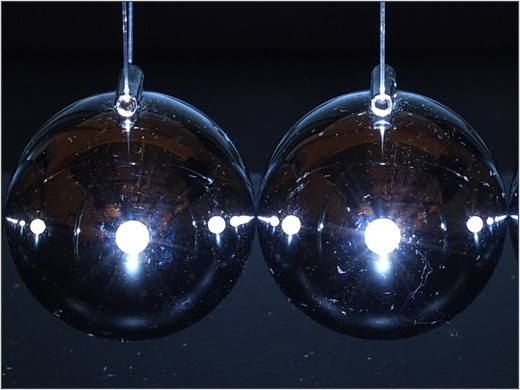

I have included what the white orb looks like and what it will look like after the fix. It looks as if the camera does have the white orb issue. the third picture is an example i just took.
