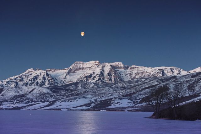

Travis asked about doing a well exposed moon in a night shot. I have one up at my website that he liked. It was a hard labor to fix the sky around the overexposed moon and I was never happy with it. But I bet some folks here could do it.
Here is the two images SOOC one for the moon and one for the rest. I am posting 1024, larger would be better as this is not a such a hard job until you start getting to print size. But it might be good for technique.
I simply spot healed (or clone) the overexposed moon such that I had a moonless sky.

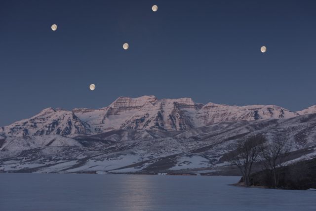

Then put the properly exposed moon on the layer above with the mode set to lighter color. With the sky being "black" the only thing that will come through is the moon. Placement then is variable, and you could independently S&P each layer, as shown in the second one, with warmer moon and magenta water (for illustration purposes).

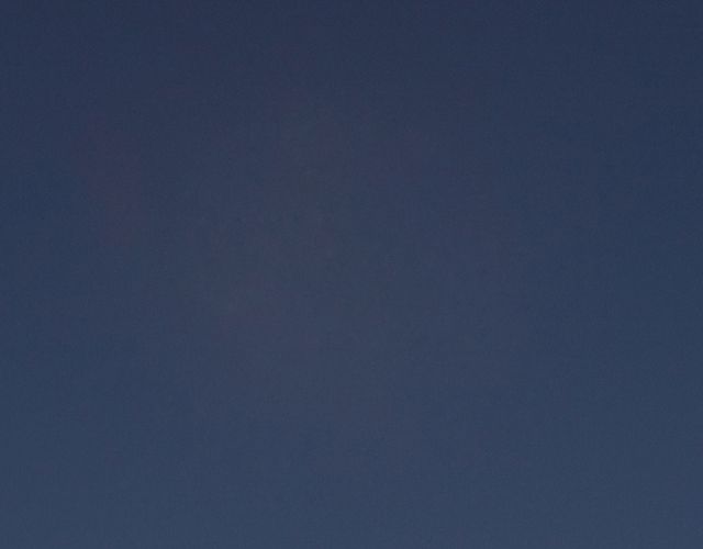

If you look at my 100% crop of the long exposure, you will see the flare. It is hard to get it removed evenly as you and Jim suppose. First the area with flare is large. Second, the sky is not uniform so any clone/patch will show edges.
I just did it over and here are the steps. First make a sky only layer.
1. Use the content aware fill to remove the moon.
2. Use the crop tool to select a large rectangular area to the left and use free transform to drag it to the center of the moon.
3. Do the same from the right.
4. Use the clone tool or content aware file to repair local areas.
The fixed area has drag marks from the free transform. Maybe I should have used NR first. But here is what you do to make the sky more uniform.
1. Add noise. I added about 3%.
2. Use NR to fix it. I used Topaz heaviest noise.
Kent's trick for putting the moon back in from the well exposed moon is slick and only takes a moment. I had a moon of the right size and location taken moments before so it did not require Jim's trick which is how I did it the first time around.
But first I worked on it a bit. I ran a light nr then a slight sharpen. Then I just added it to the light image as a lighter color and it came in perfect.
Here is my redo.
But the hard work is fixing the sky on the light version. Just a clone does not cut it. Try for yourself on the 100% crops.
Ben, I am not sure I understand what you are doing but it does indeed sound like a nightmare. The original image has some flare around the moon. Is that what is causing you a problem? Again, I would hit the moon with the repair tool. That should be a 1 second fix. Some lightness in the sky around the moon should look natural. If not I would set the clone tool to say 25% and sweep the area to even it out. I don't understand your issue with noise in the sky. That could be easily fixed. You have no stars or other elements in the sky so you should be able to select the sky with a click or two, then contract say 8 pixels, feather about 5 pixels and blur about 2-4 pixels.
Hi Jim. The illumination is lighter near the moon and radiates to dark as it goes away from the moon. This is in addition to the flare itself. So any area you choose as a clone sample will not be the same illumination where you add the patch.
This is not obvious so much until you start working it at 100%.
The free transform tool is a good way to fill large areas. But it causes stretch marks if there is any non uniformity. I assume the non uniformity is noise. I did not run NR before I started using it and would have probably had better results had I done so.
Adding noise and then running NR is just a trick I learned a year or so ago to make uneven sky's more uniform. It works pretty good and even had I used NR at the start, would probably still need it at the end.
These low light shots are noisy, even at ISO100.
But I have never seen your noise trick so I am going to try it. How do you contract? Never heard that term. Is it a resize? I had the sky selected as a first step.
Edit:
Jim, I tried your trick and found contract. Pretty subtle. Is this what you use for NR?
