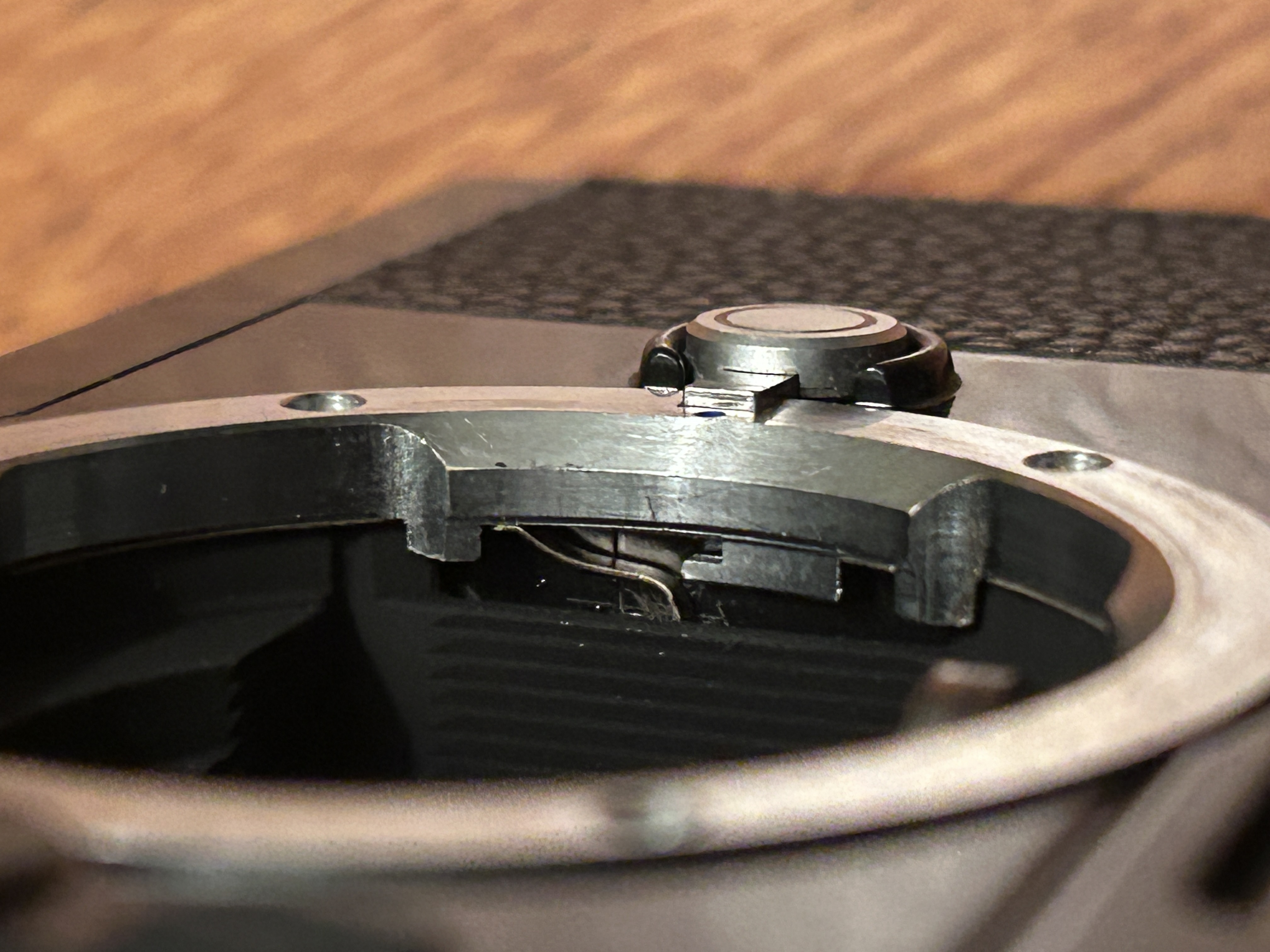

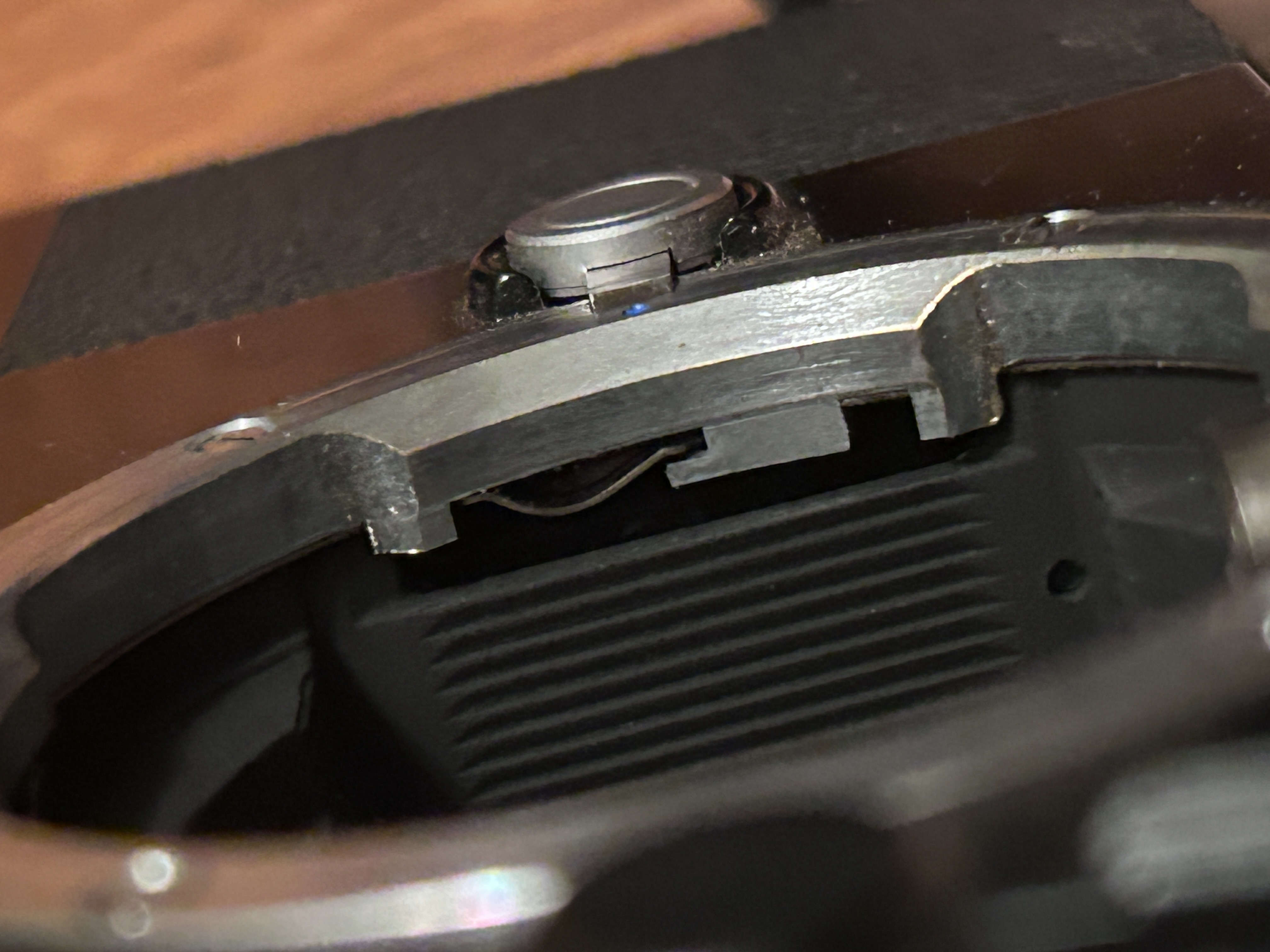

Those of you understand the mechanics of rangefinders I have a question. I have purchased a second Ikon. I noticed that it will not lock my CV 28/1.5 into place.
It will mount the lens and I can turn it all the way over, but the last millimeter or two it simply will not lock. The frame lines and focus are engaged.
Upon inspection of the mount, I see 4 pins and on my m-body’s throat and I see 4 blades on my lenses that fit into those groves. I see that one of the pins is not in the grove (see the 2nd photo). The other 3 pins in that camera are tucked into the grove. My other Ikon, which mounts and locks my 28/1.5 without issue looks like this with the pin tucked into (see 1st photo).
Is the unengaged pin on the new Ikon hindering the lens from locking?
Ikon that locks the 28/1.5
Ikon that does not lock the 28/1.5

I think the problem is the tension spring has come loose from its anchor on one side. Also, is that a dead spider in the new mount?

p.1 #3M-mount won’t lock into place
Dead spider!
Yes, the spring came out. You'll need to place it back like in your image 1.
