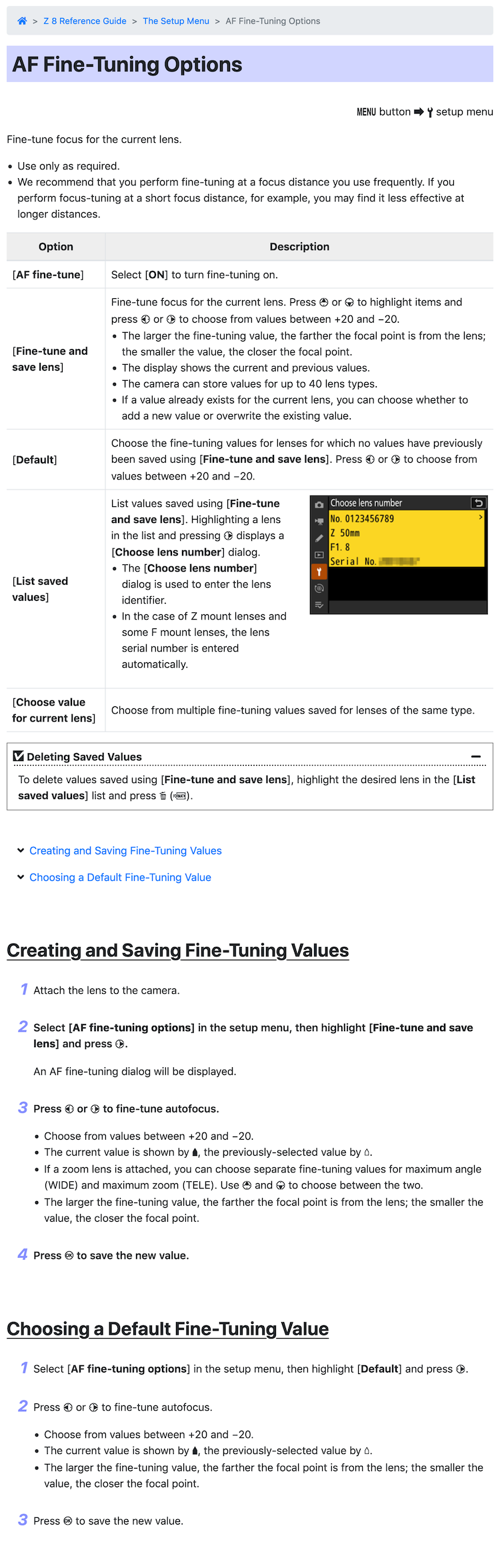

Gordon Lyons
p.15 #14 · Z8 extremely unreliable/inconsistent AF in mildly low light
I notice you have AF Fine Tune on with the 70-200mm. If the value entered is let say +20 (the extreme limit) it could back focus rendering accurate focus on the rear eye. I tried this on my Z series with a +20 value in wide area focus with eye detect enabled and it showed the focus was locked on the nearest eye. When I reviewed the image the focus was on the rear eye.
Just thought it may be worth checking into. Wish you the best in finding a solution to your situation.
May 02, 2024 at 11:41 PM
SCoombs
p.15 #15 · Z8 extremely unreliable/inconsistent AF in mildly low light
The AF Fine tune is on because of another lens, but there is no fine tuning programmed for the 70-200 (I just double checked to make sure it didn't somehow get programmed by mistake). In other words, all of my lenses are set to 0 except for one which works best with a +1 and so I leave the AF fine tune on so that when that lens is attached it will work.
May 03, 2024 at 12:22 AM

p.15 #18 · Z8 extremely unreliable/inconsistent AF in mildly low light
Hi Gordon,
Thanks for the heads-up on the fact that the Z8 has AF fine-tuning.
For those of us not familiar with Nikon's AF system and who are trying to follow along, the User Manual page for the Z8 "AF Fine-Tuning Options"...
https://onlinemanual.nikonimglib.com/z8/en/sum_af_fine-tuning_options_307.html
As you were, folks.
Jimmy G
Nikon Z8 AF Fine-Tuning page
