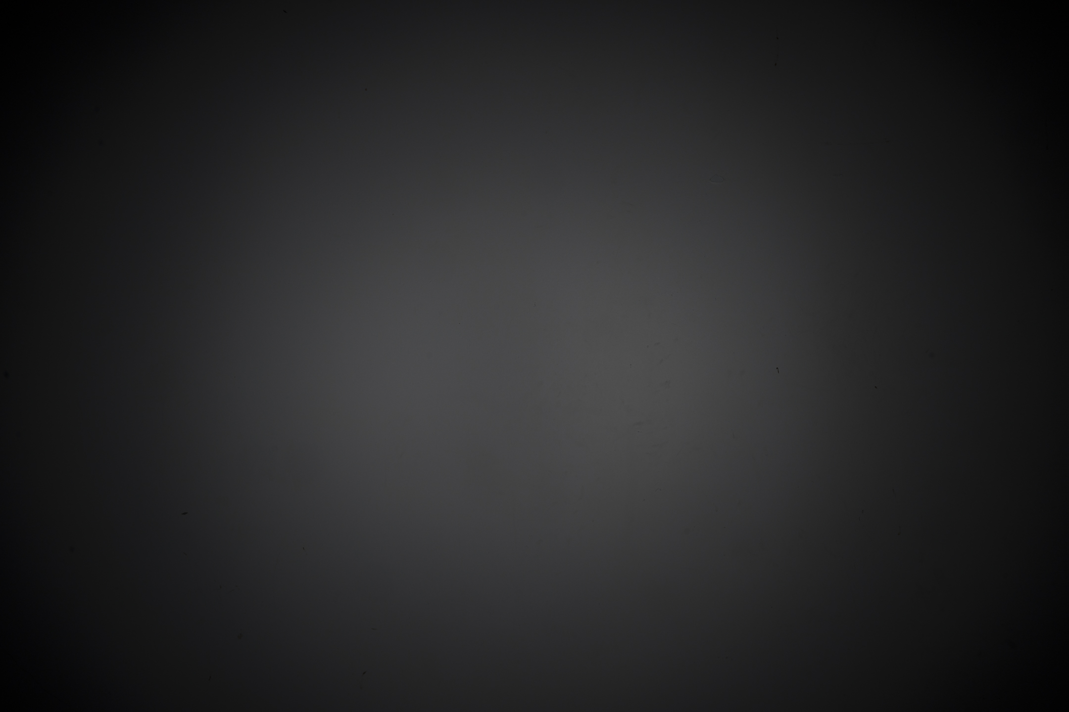

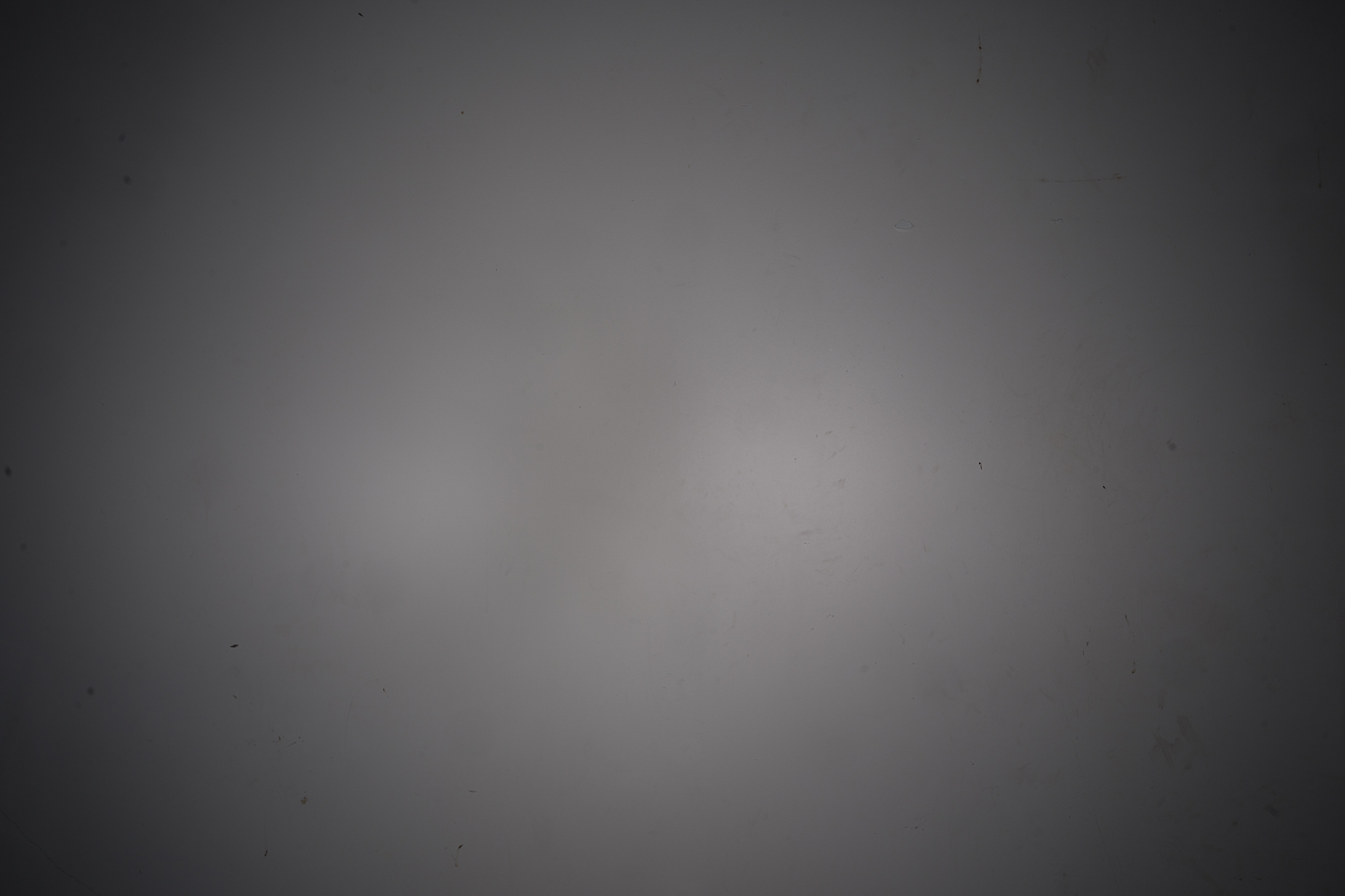

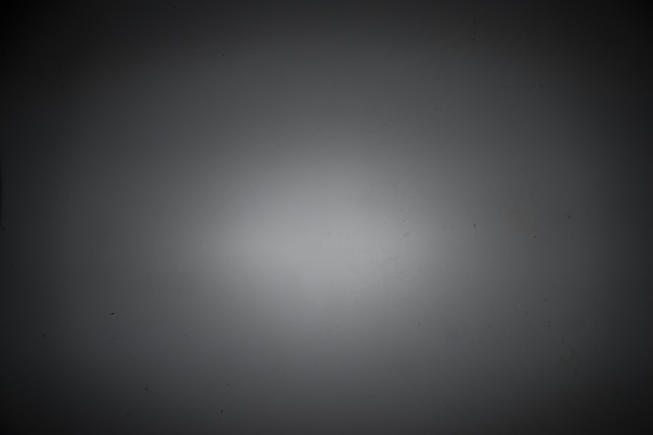

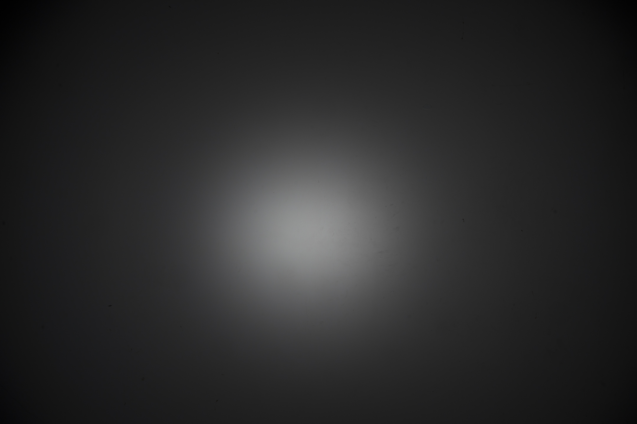

Let me shoot under mid-day sun without much issue. The multi-faceted design not only ensures a smooth distribution of light but also effectively directs most of the light forward.
In my test, transitioning from 28mm to 85mm with the bare flash results in a gain of approximately 0.6 stops. At 28mm, the Clic Magnum, set at the same zoom, provided around 1.2 stops more light (about the same as an AD200 Pro with the fresnel head). On the other hand, at 85mm, the Clic offers about 0.5 stops more light. The zoom setting has a minor impact on the Clic Magnum, roughly 0.1 stops, with the brighter option at longer zoom settings. The light spread is narrower with the Clic Magnum than the 85mm setting, exhibiting a pleasing round shape, in contrast to the oval shape produced by the Clic Fresnel. It's worth noting that the Clic Fresnel has no effect at the 85mm zoom setting, as reported on YT. The accompanying 20-degree grid reduces the output by 0.2 stops.
Despite its larger size compared to the Fresnel, the Clic Magnum proves to be a more versatile option for my ultralight travel setup. Its durability is also commendable – surviving a drop from waist-height without leaving any significant mark on the exterior. Cost considerations aside, I am genuinely satisfied with this setup.

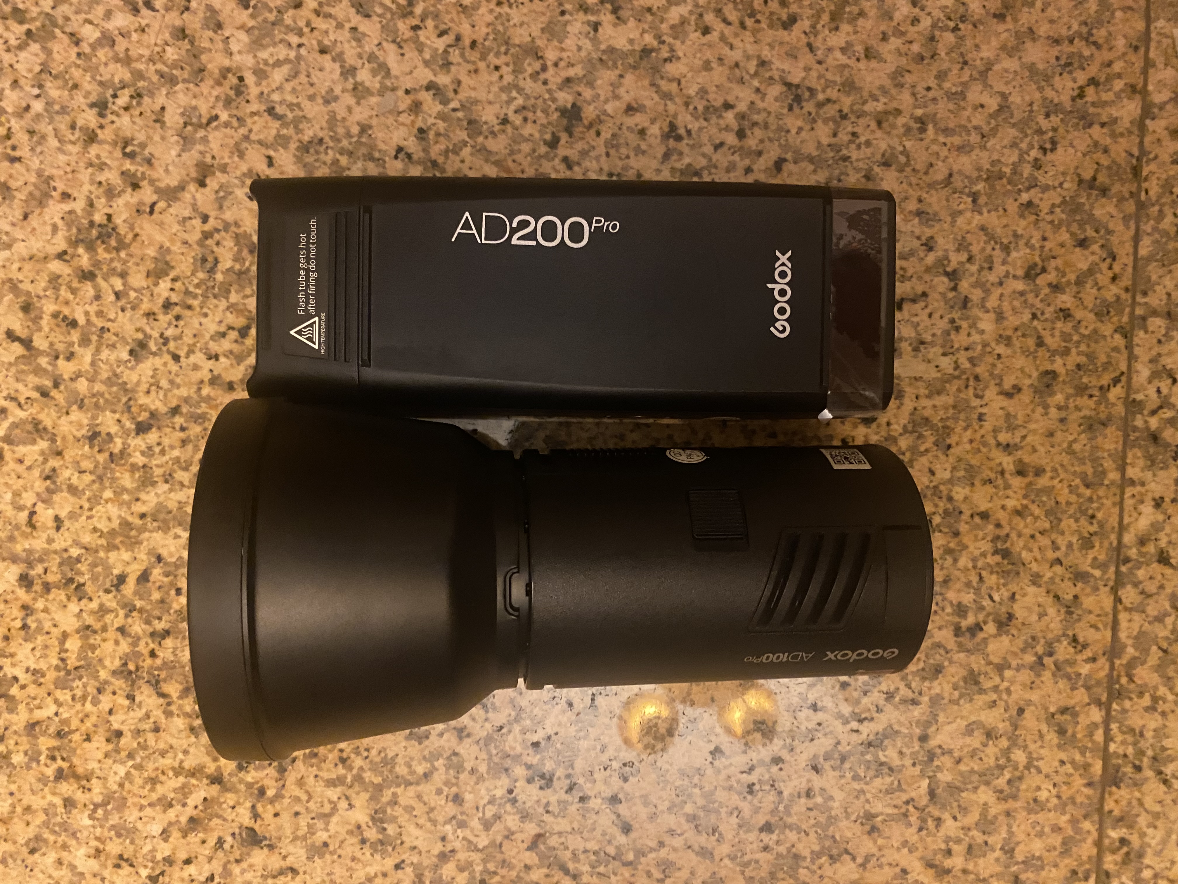

I wonder how the Magnum compares to the SMDV standard reflector that appears to fit on the AD100? For around $35 I ordered one to try (AliExpress - so it will be few weeks getting here)

Interested as well I do have the C-Adapter (or at least what I think will work - an adapter made by Angler for AD100). However looking at their site it looked like the hard reflector attached via magnets directly. If not the adapter should work. If it doesn't then "plan B" I suspect the Magnum will be more effective but it may be only marginally more. In general the facted & shinny interiors do better but in some tests I have seem the traditional shape makes up some, or most, of that difference. It was a youtube video by MarkusPix but I can not seem to locate it at the moment. I do believe that outside of brightness the Magnum will focus the light more effectively.
I can only hope I don't need the adapter. If you look about half way down the SMDV site it appears as if the reflector is magnetically attached.

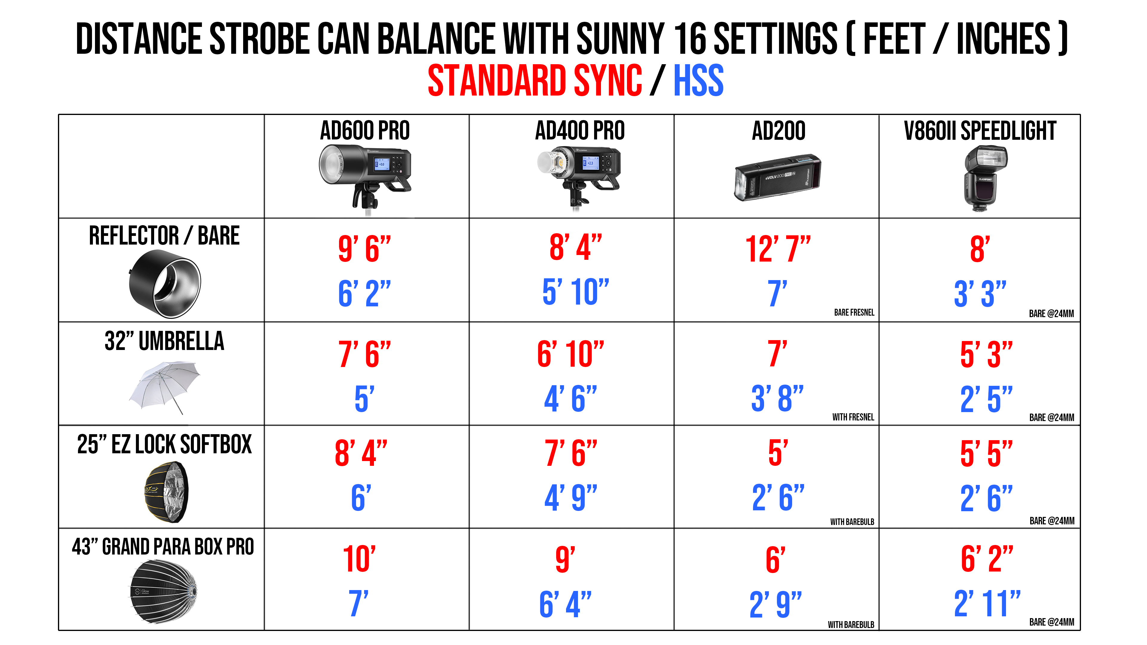

I carry 2 AD600s as I don't think my AD200 has enough power for the sun. Maybe I am doing something wrong. Bare reflectors wise, I have a kacey BD. Typically I use Elinchrom Deep octa or a medium SB. I haven't tried high efficiency reflectors but hard for me to believe that 100ws strobe cuts in at mid day sun.

An AD100 can not beat the sun but they can be used in the sun depending on what your intent is. They can be great for fill.

As for the SMDV, I hope you don't need the adapter. Their B120 and B240 have a much bigger front than the AD100 and I saw the grip, adapter plus reflector as a combo for sale before.
Only time will tell (unfortunately I didn't see the reflector at the US site so I ordered from AliExpress. Now I need to be patient. When looking over the specs of the B120 it appears wider then the AD100 by about 20mm but when I look at the specs of the SMDV reflector the size seems to be just about correct.

Ok - the reflector does not fit the AD100. It is just (very) slightly too big and the magnets don't match up. Worth a try but at the movement a failed attempt.
Will see if I can kludge something up to make it feasible using one of the magnetic attachments for the AD100 and some epoxy. Might be feasible.
