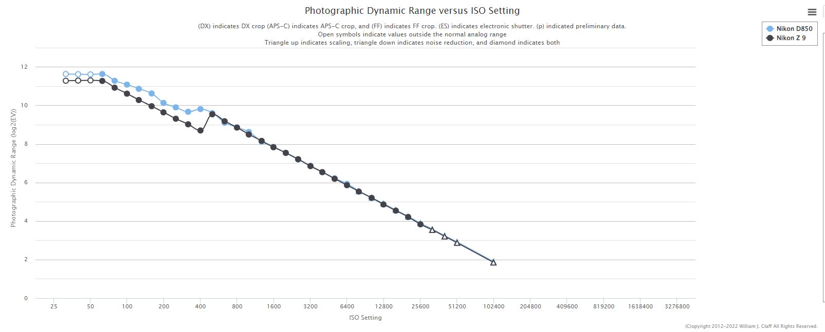

Yes it has been well established since the early DR testing of the Z9 that the stacked sensor gave up some of the low ISO performance of the D850.

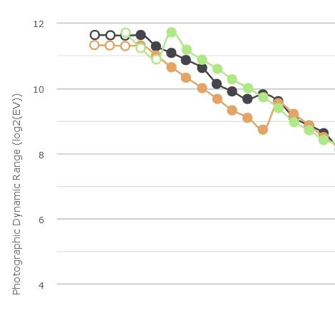

Here is the PDR graph from Bill Claff....marked difference below ISO 500. Not sure about your ISO 800 and why it would be performing that much better than the Z9 at ISO 500?? There was likely different amount of light hitting that area of the dog due to the different position?
I would try a more controlled test. Non-moving subject, same ISO (I'd test ISO 64 and ISO 500), same Adobe profiles, same exposure settings.

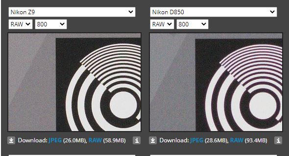

You can also check out the DPR studio scene as they've already done the testing for you...one quick screen shot below.
