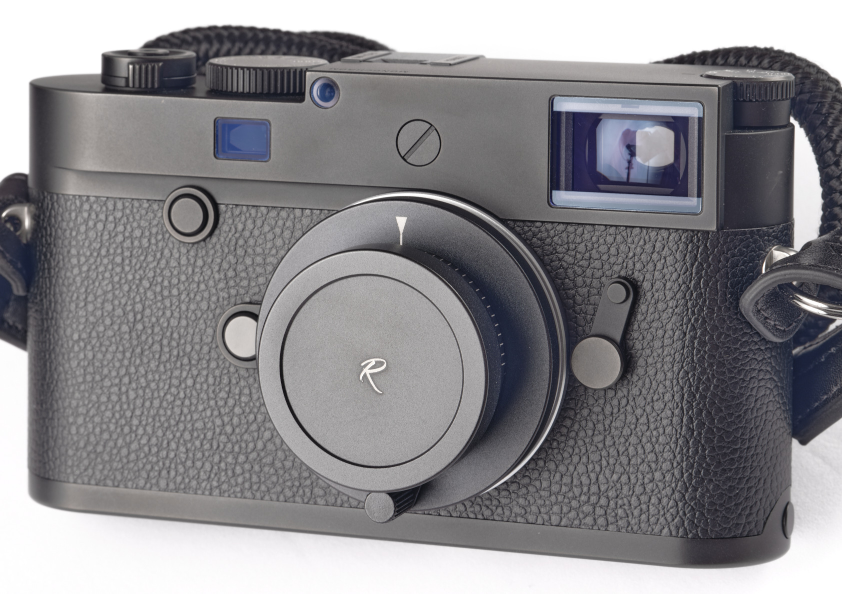

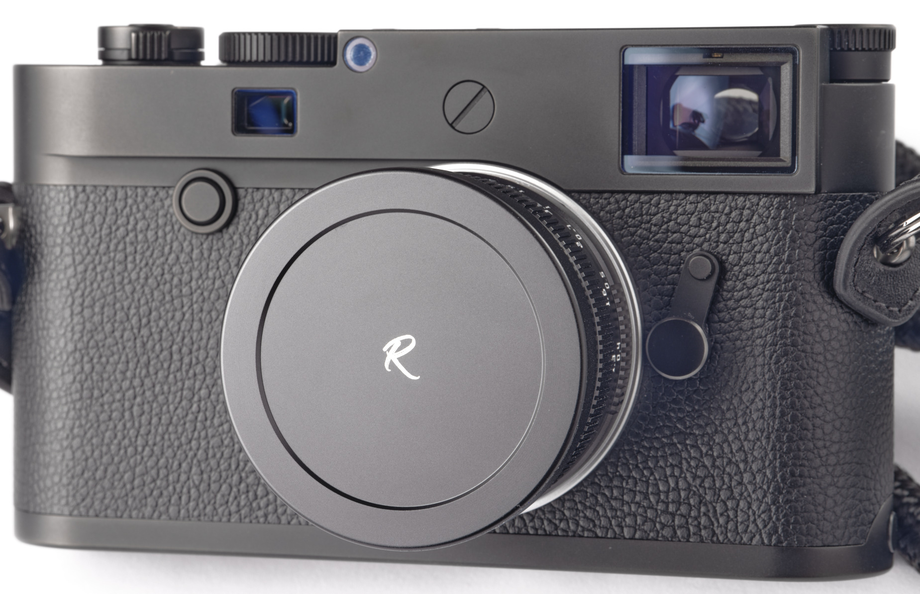

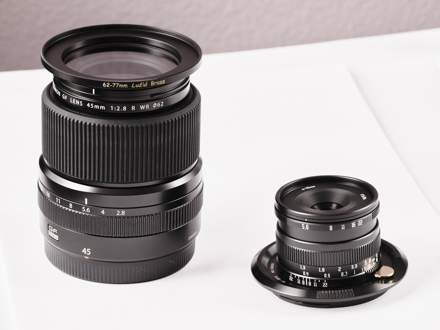

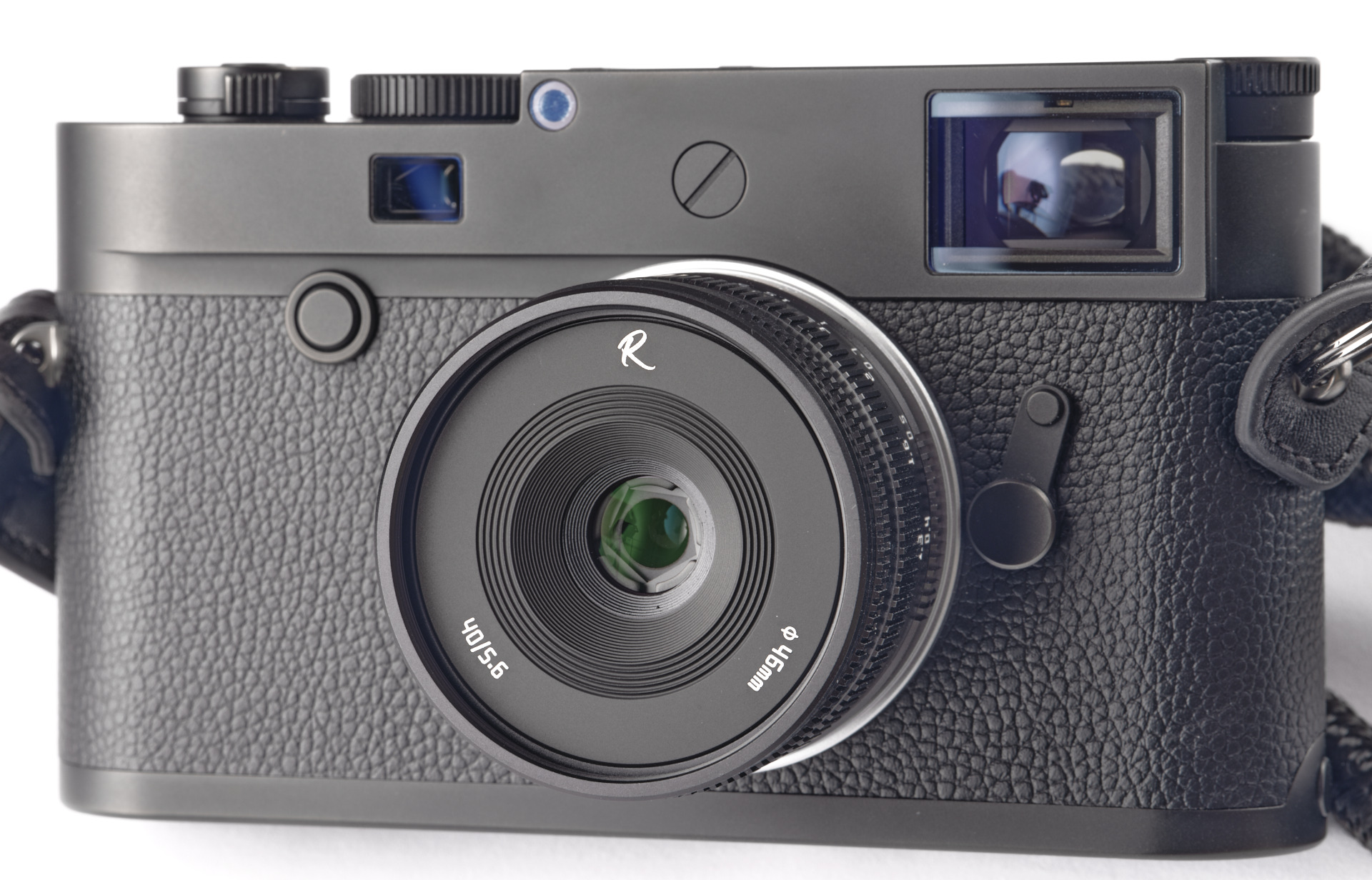

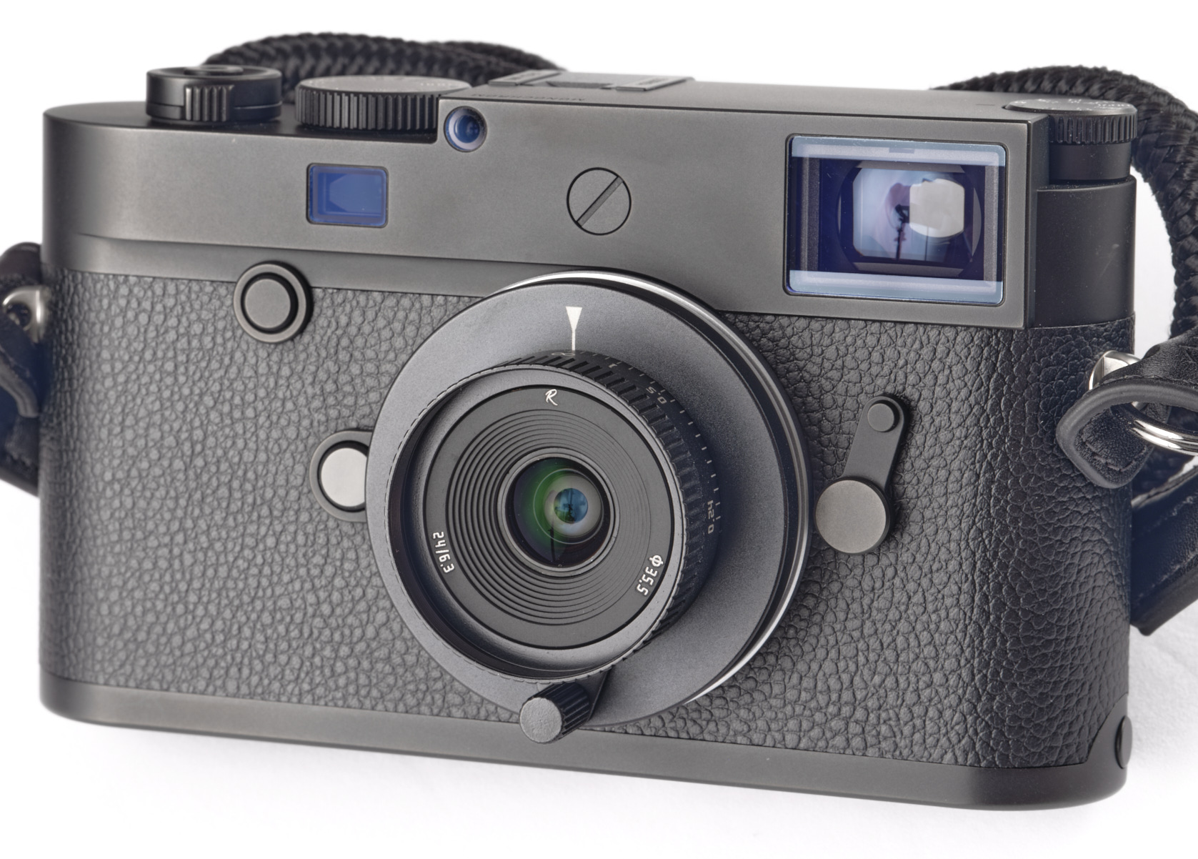

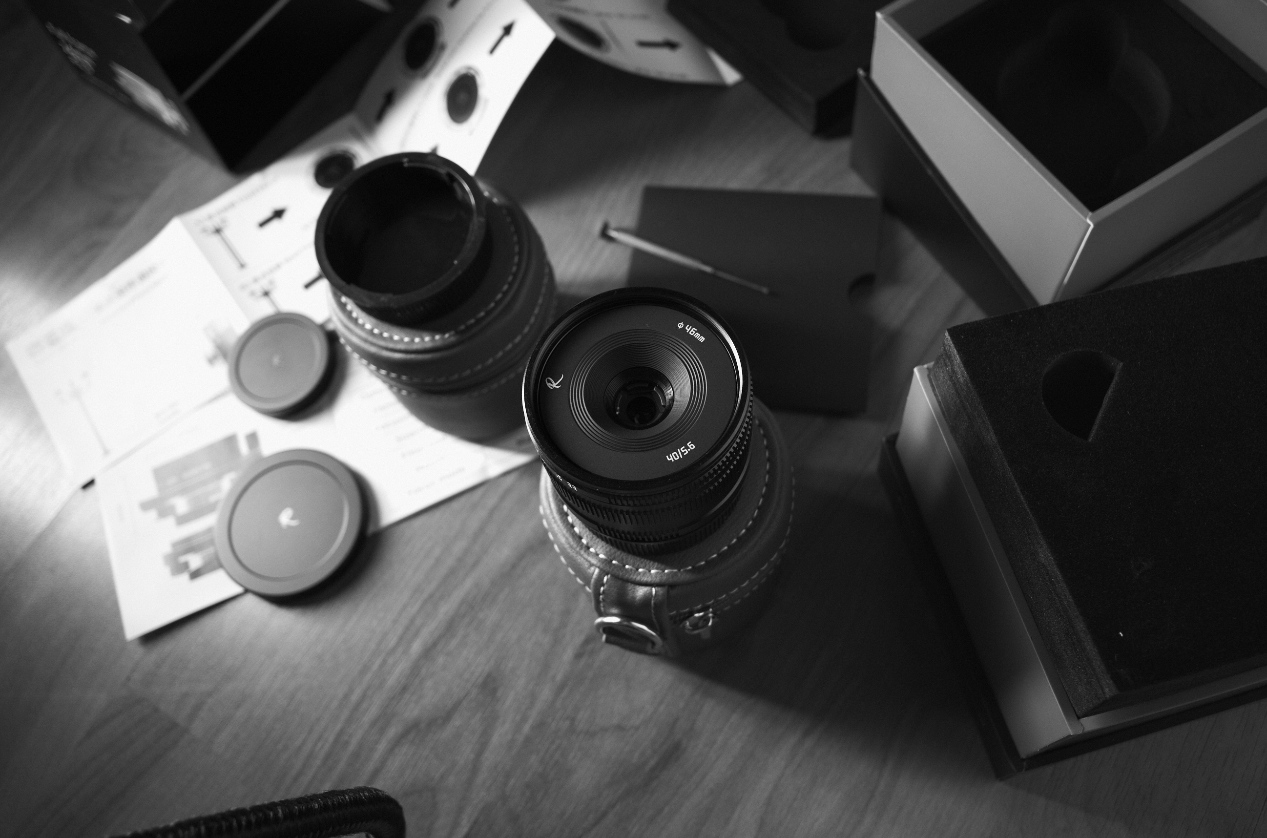

I just got the lenses, short first impression:
-packaging isn't premium but packed very well and safe, everything shown on the amazon listing came (cleaning kit, kingston sd card, leatherette carry pouch)
-both are very lightweight, even the 40 which is much bigger than the 24 is very lightweight. 24 feels almost like nothing.
-24 only lets you do auto lens detection or off, 40 lets you do all (m10m)
-24 has a weird focus drift thing if you let go of the focus tab 1/8 of a rotation away from INF and it ghost-turns towards MFD (is the RF gearing doing this?), 40 has no such quirk
-40 has stepless aperture ring which could be an issue if you have bigger fingers. i haven't seen if you can make it stepped. 24 is fixed aperture
-24 has heavier damped focus ring, while the 40 is faster and smoother
-both seem to be well calibrated for the RF on m10m right out of the both (they do include the little tool for adjustments). i haven't checked for INF yet
-both seem pretty sharp and low-distortion from what I can see
-40 seems to flare with strong direct light source on side of frame, covered with hand no problem tho
after my nap i will take mount them on gfx and see if they resolve okay
how it looks on m10m:
40
40
24
24
pouch is nice
Aug 13, 2022 at 07:31 PM

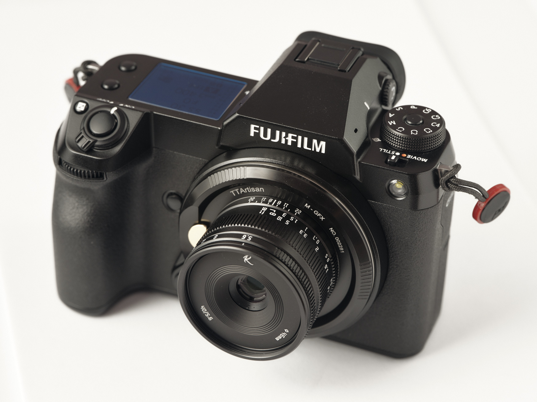

p.1 #7 · AstrHori 24mm and 40mm pancake for Leica M
I'm going to return the 24, but the 40 I'm beginning to bond with lol
below just close sample compared to gf45 on gfx100
i set the astrhori to f/22 and INF and it indeed had full sensor coverage. gonna test outside later though
EDIT: well, the resolution seems fine but the veiling flare/glare thing is kind of annoying lol still i want it to work but not sure if a hood will fix it since i had to throw my hand far off angle to remove some of it. ill probably keep it for the m10m but maybe just stick with native for gfx
looks perfect with the TTA adapter
gf 45 5.6
astr 40 5.6
gf 45 5.6 100% crop
astr 40 5.6 100% crop
Aug 14, 2022 at 09:04 AM

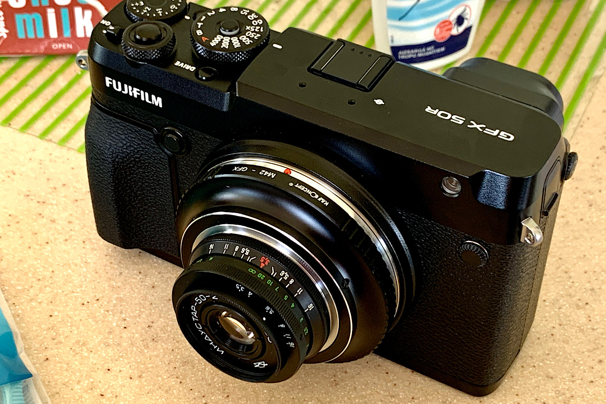

the industar is a good lens, but i can't mount it on my rangefinder and it doesn't look as modern, that adapter must be heavier than the lens lol
Aug 15, 2022 at 01:05 PM
leonasj
[X]
p.1 #13 · AstrHori 24mm and 40mm pancake for Leica M
adapter 80gr weight and lens 70gr. ,but im got zenitar 50/2 mc m2s lens. weight 190gr 46mm filter and sharp from f2 https://allphotolenses.com/lenses/item/c_2570.html also have sharp from f2 helios-44m-7, but weight 250gr and 52mm filter yesterday received super takumar 50/1.4 8element lens 49mm filter weight 245gr small boy
