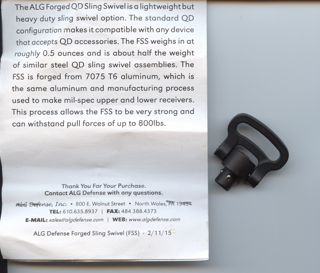

the QD system was originally designed for single point weapons sling type carry that allows freedom of access and fire movement or as a 2 point in more relaxed situations with your weapon that supports it. it is technically a 2 handed operation to remove. it really does not work as a belt clip based system. it is designed to be secure on in use unless you really want to remove it. i have a few variations but they all essentially work the same.
that "tiny swivel" (the steel one black if its a real military spec one) as you refer to it, depending on which one you get can and does hold in excess of 300lbs. 2 of mine are tested to 800lbs which are forged 7075 T6 Al alloy. this essentially means that you better hope something else breaks on the strap before parts of you do. i'm using over 5+ years now. i don't even think twice. but, like any relatively thoughtful individual when installing on to your camera/lens plate you do a good "tug test" to ensure proper install/lock.
one other little thing, remember what's really holding everything on to your camera base is a 1/4-20 threaded SS screw, right*? havent had a problem yet and i have been using RRS plates since 1991. i've had a lot of stuff hanging off of a lot of things one might not trust, including me.
* and that all will be determined by what you purchased and who they source their parts from.

If you don't mind, where did you find swivels testing to 800 lbs?

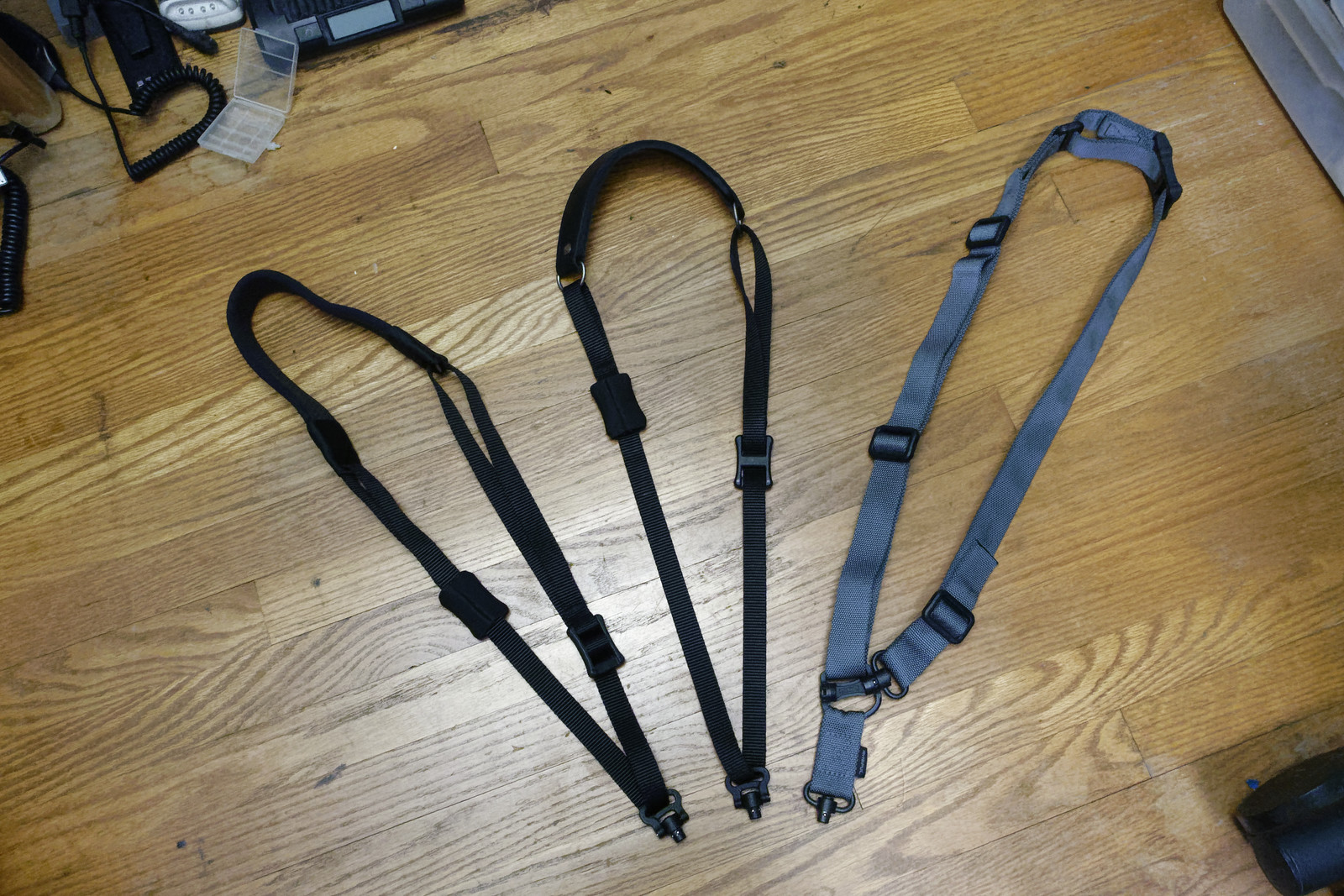

Can you identify the 3 straps in your photo (the one on the right appears to be the Magpul MS4 Gen2 Dual QD, which I have, but I don't recognize the others) and say a few words about pros and cons of each from your experience?

ALG Defense, manufactured in PA. i have a few of these too. not cheap. they have the occasional sale on them. load claim is such that its well over a relevance level for real world usage.
the other 2 straps were and are made by LumaLabs in Oregon. one is an older revision (foam/fabric shoulder setup) and one is a recent one with leather at the shoulder point rest.
the reason i liked them is that they were and are simple, lighter, modular, adjustable for sizing and support parts replacement and to a degree type of attachment system updating. my oldest one is over 8 years still in use by my daughter.
the ALG FFS as weighed by me on my pretty accurate super-duper electronic kitchen scale is 0.6oz and a Magpul standard steel is 0.9oz.

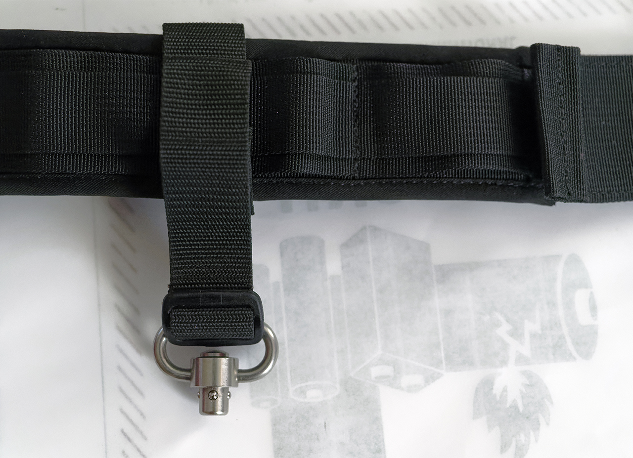

i don't know how or when you are going to use it but there might be a way i am working on with a belt setup. for me the bandolier is fine. i don't need 2 bodies on my body. the belt of course needs to be stiff so i'd look into a Think Tank newer skin belt v3, a Lowe protactic utility belt or a mil/police duty belt. i am thinking all season wear so the size of the belt will need to be variable and remain stiff. i have to whip up a prototype later.
back with a dummy setup:
belt you may want somewhat padded
it will be a slide on on said belt
it will hang an inch or so below the bottom of the belt for higher rotation it can be higher if one wants it that way. it is ambidextrous so either side or as you wish both.
