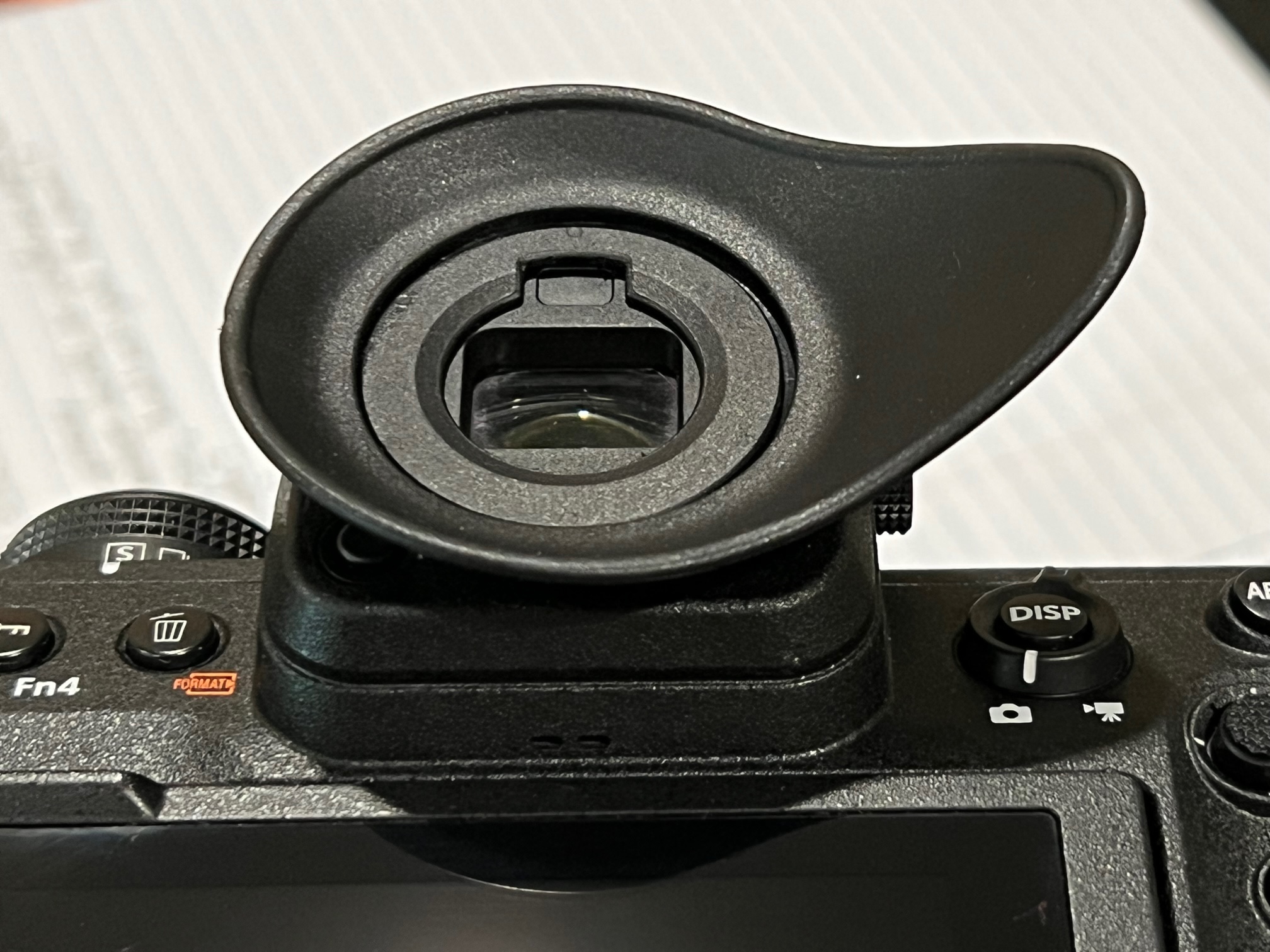

Just remember, this eye cup will not rotate as there are flutes of plastic inside the base plate that stick into the rubber part that stop it from turning. When using it in vertical mode, you just have to put up with it not sitting perfectl on your eye. However, it is still more comfortable and better than the original Nikon version.

Here is a step by step "guide". I hope it is clear enough.
1) Remove the DK-33 from the camera by pressing the button to the left and below of the EVF and rotate it anti-clockwise off.
2) Peel away the rubber of the DK-33 as per below:
Rubber off the plastic holder
3) From the side that has the Nikon logo, you need to use your thumbnail or similar to split the thin plastic ring away from the holder as shown below. It can be a little difficult to do but it will come off reasonably easily. You should be able to see where the clip and base are different in the photo:
4) Turn back over and mount the cup that was purchased from the Ebay seller. It will go on reasonably easily also. Just make sure you line up the longest part of the new rubber cup horizontally to how the DK-33 holder sits on the camera. The new cup will not rotate on the holder and if you try to do so you may break the holder.
5) replace new set up on the camera by rotating the cup clockwise around the EVF

Lance you are the man. No way I would have figured that out. Haha. Got it all done and on the camera. I have never used an eyecup before so it feels a little weird right now. I’m sure I will get use to it. Thanks again for all the help!!!!

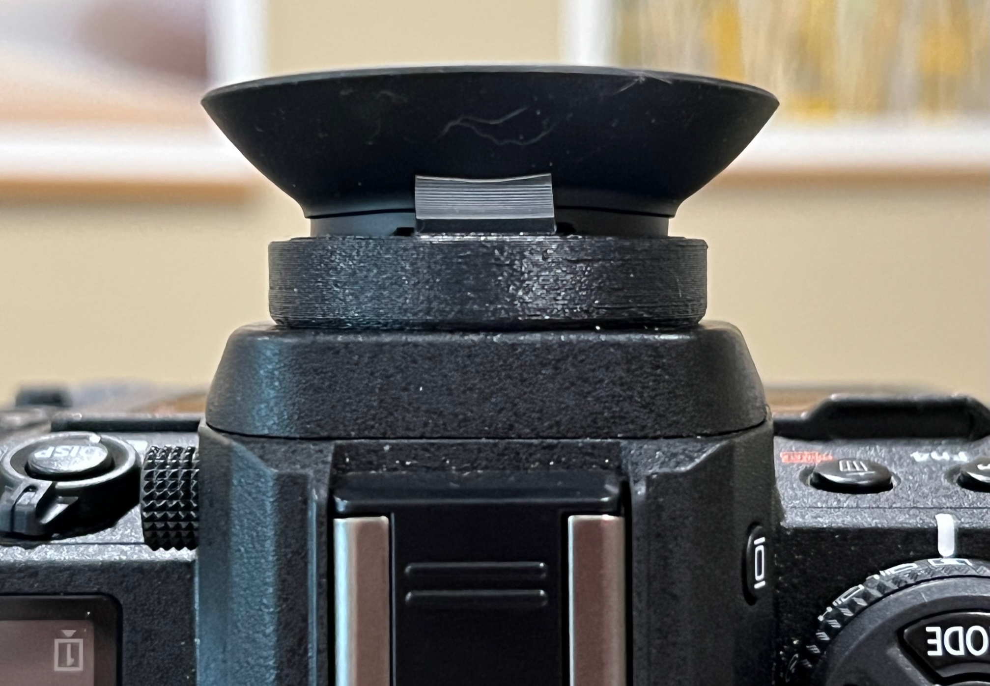

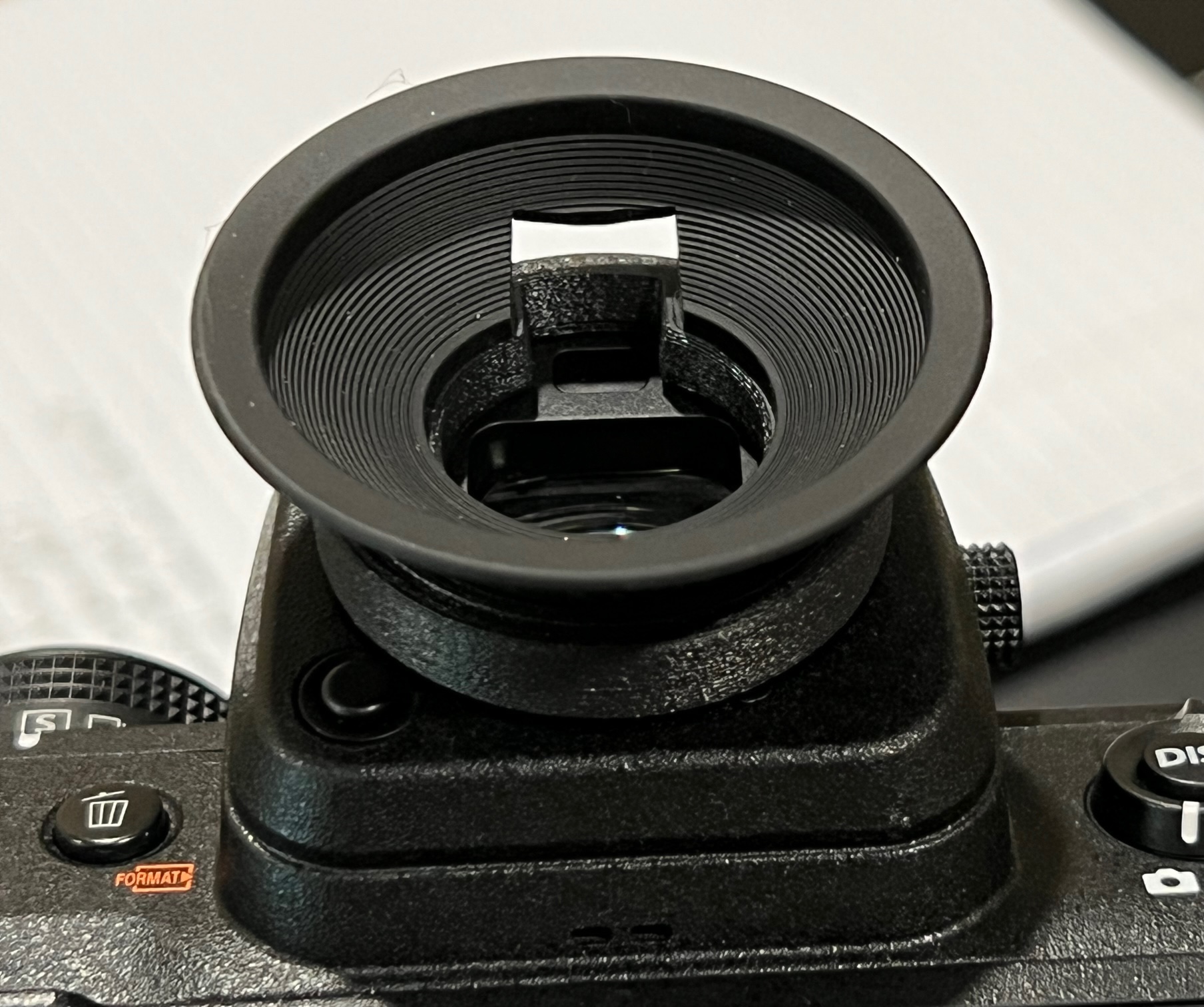

Greetings All,
Found a new alternative to my improvised eyecup for Zemlin photo. Link here: https://www.zemlinphoto.com

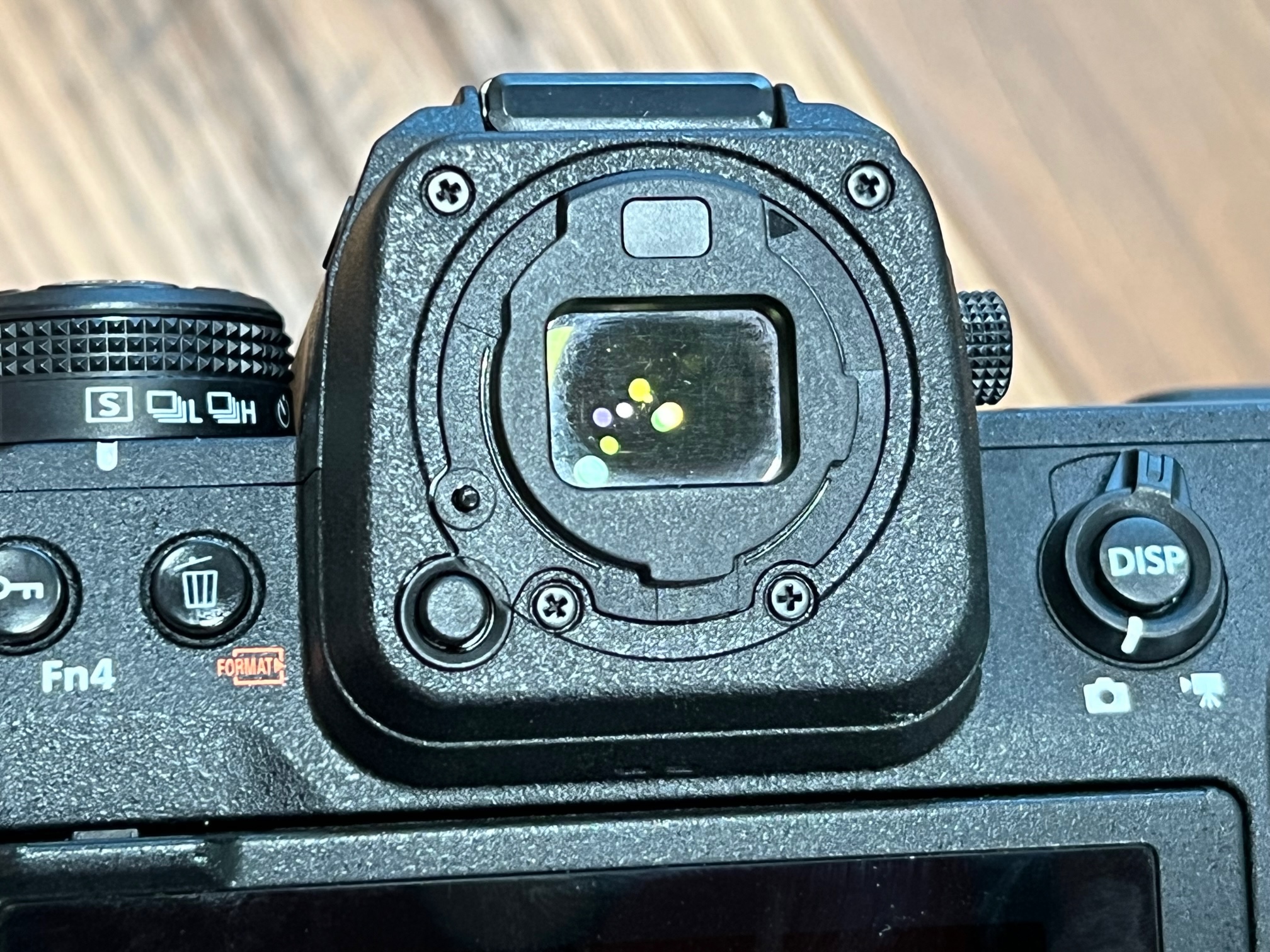

Unfortunately, no, the DK-19 is not compatible with the Z9. Nikon changed the eyecup mount from their previous screw-in style, to a bayonet mount on the Z9.

It’s interesting that Nikon kept the legacy 10-pin remote connector for backward compatibility, but not the eyepiece attachment. Lance did a nice job earlier in this thread showing how to mod a better eyecup for the Z9 and that has helped me greatly to be able to view the EVF in bright light.
The included eyepiece on the Z9 has been problematic for me, as the rubber was constantly coming off the ring, and it is so shallow it offered no shading from peripheral light (the DK-19 was much better). I look forward to seeing what Hoodman comes up with.
