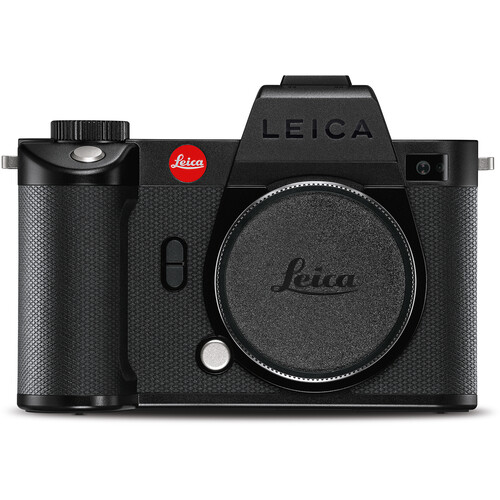

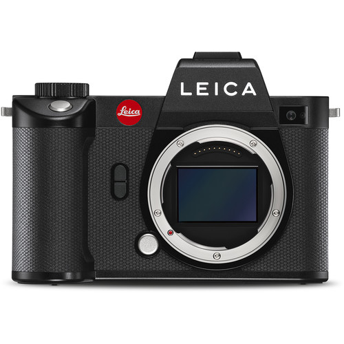

This is subjective but I find the white-painted LEICA letters on the SL and SL2 bodies a bit too much since both cameras already have big red dots in the front. ;-)
Since the release of the SL2-S (which does not have the word "LEICA" painted white), I have been considering removing the white paint from the letters on my SL2.
Here is someone who did it successfully:
https://www.fredmiranda.com/forum/topic/1704309
For those interested, I've asked Dyfa for some tips and here is what he wrote me:
Part I: I've gotten many many pms and comments about this that I think I should make a youtube video about it haha. I have a channel after all.
It's not very hard but requires some patience. Acetone on a rag and some toothpicks will do the trick although a dull needle is preferable to get things started.
1) apply some acetone or light amounts of paint thinner on the letters (excessive amounts or rubbing can cause the black paint surface to mark especially black paint. Light dabbing is enough)
2) use a dull needle to chip the white paint starting from the corners of the letter (it's easiest to lift the paint from the corners)
3) continue chipping away with the needle if you feel comfortable and steady or switch to a sharp toothpick
4) There shouldn't be residue but to clean it up, use some q-tips with acetone and run it through the grooves
Takes about an hour.

I replied asking for more clarification on rubbing acetone and using a wooden toothpick instead. Here is his answer:
Part II: Light rubbing is totally ok. I haven't had any problems with paint thinner or acetone on Leica black paint but on a Sony I once owned, it did show faint rub marks. Perhaps the quality of paint is vastly different as well.
I actually used dull needle the whole way through but a toothpick sounds doable as well. Though to get the initial chip, a dull needle is ideal. To chip it, you wont be stabbing or scrapping. It's more like catching the edge of the white paint and gently flicking it to flake. That's how I did it at least.

Thank you Dyfa and Fred for posting. I do prefer the blacked-out logo myself and now we know how!

I bought Dyfa’s SL. Can vouch and say that it looks excellent with the black compared to the white.

I found the easiest and least harmful way to hide letters and logos on black Leica cameras is with black gaffer tape. Trick is to double-tape the area which sits on the red logo and the letters - otherwise the tape will stick to the white or red paint and strips parts off when the tape is removed. Double-taping (meaning to avoid that the adhesive touches the logo or letters) - avoids it. This way the camera remains in its original condition and doesn't affect resale value later.
This said, I like the look of the SL2 with black letters. Looks IMO better than the original!

I had some time today and removed the white LEICA letters from my SL2.
Not for the faint hearted but easy.
I started by dabbing the letters with pure acetone with a cotton ball. Then used a wood toothpick (to avoid any scratching) and the white paint came out very easily. There was a bit of residual paint, so I used a q-tip with acetone through the letter grooves and all the white paint came out. Looks great with no scratches or marks and definitely stealthier. I think it looks exactly like the newer SL2-S now.
