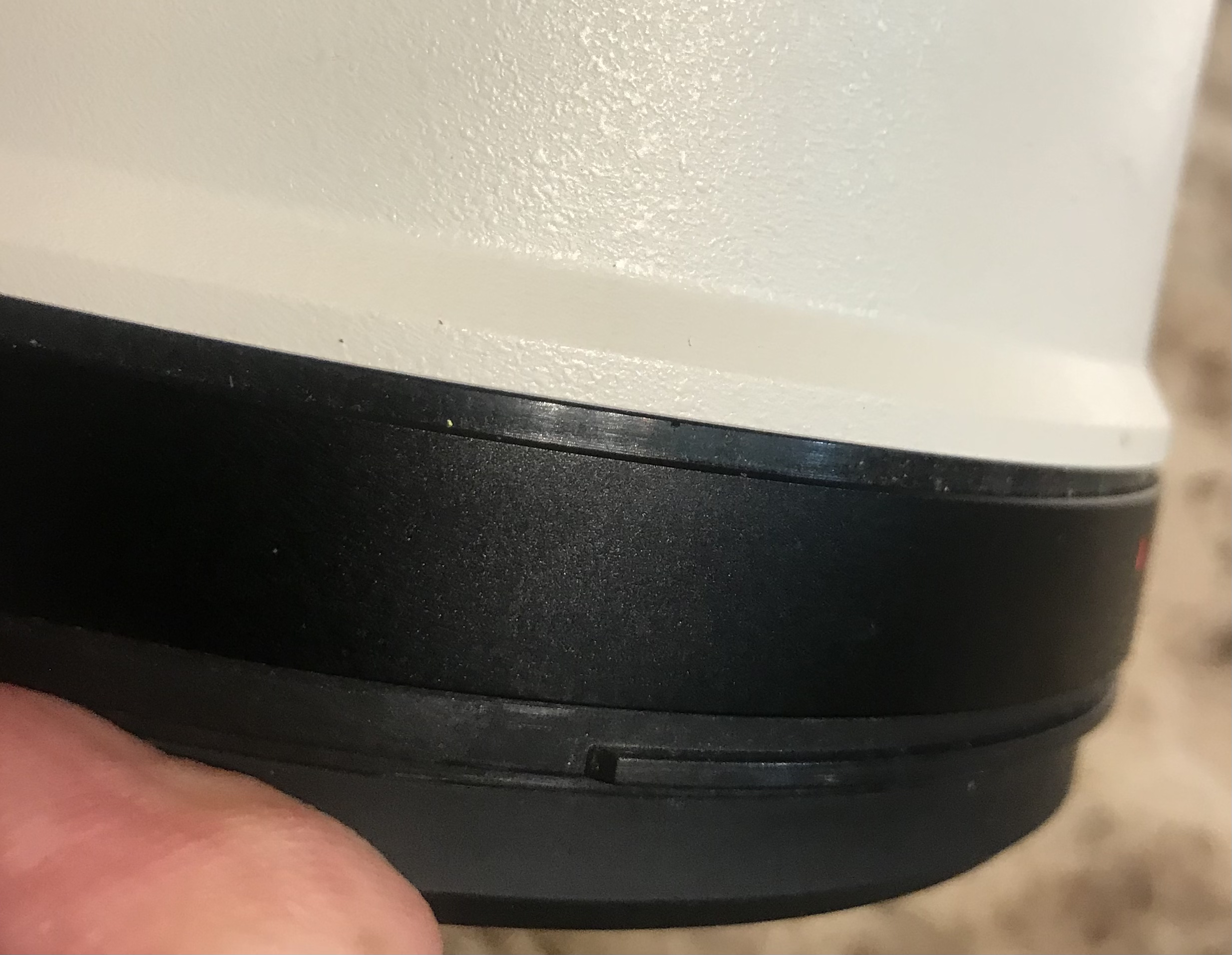

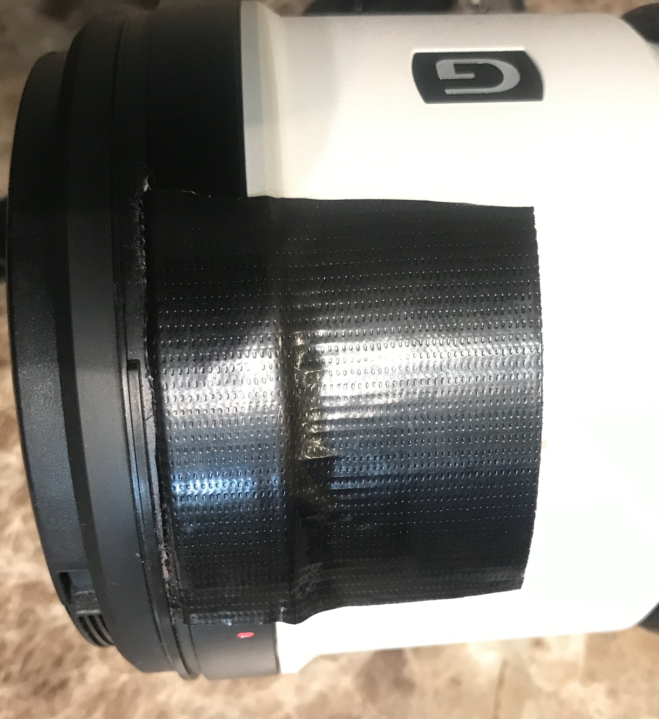

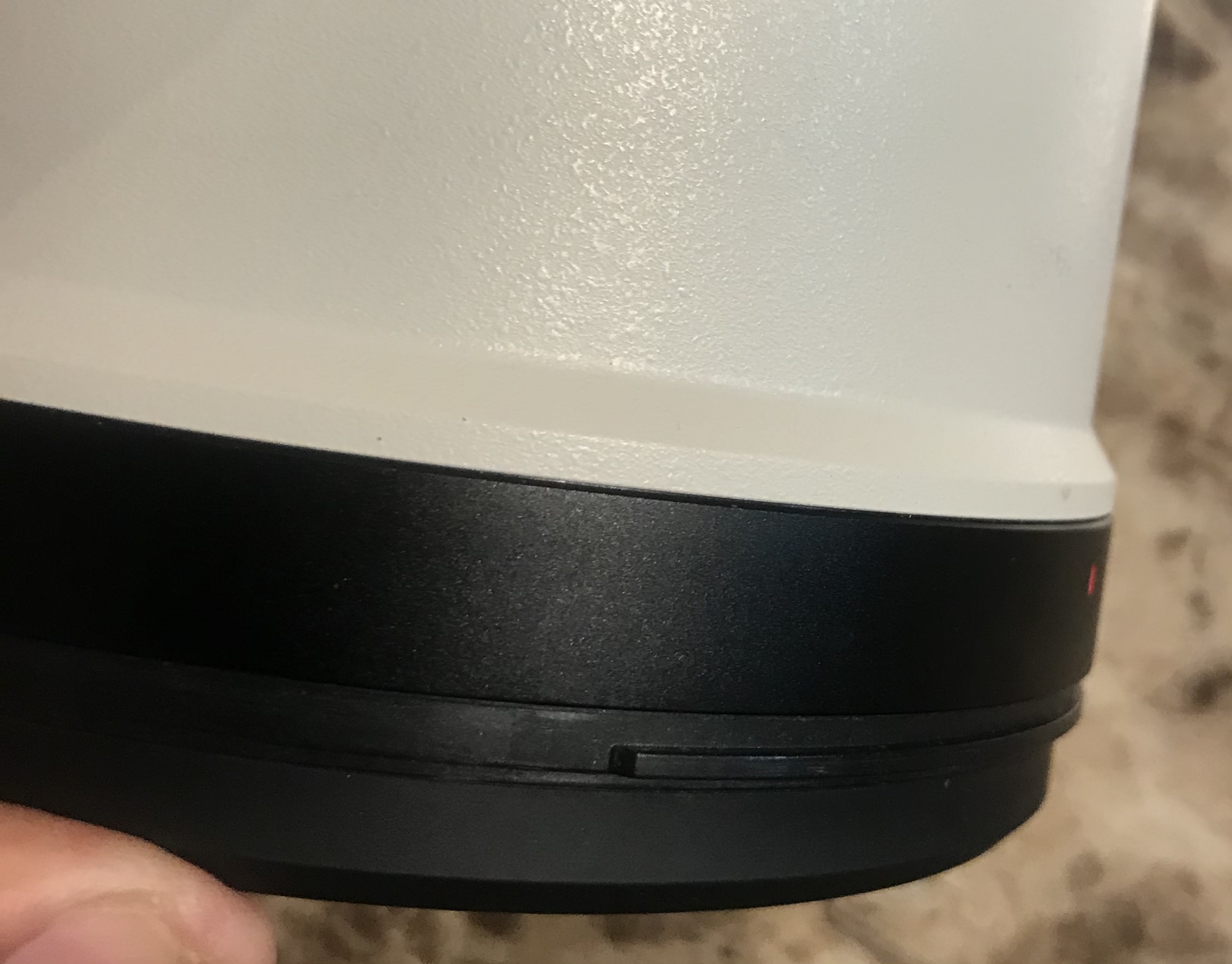

I just noticed that the front element part of the lens where the hood attaches is moving/got loose (please compare pictures 1&2). Looks like the hood is giving too much strain to this part of the lens ( I guess it is poorly constructed). I have now pushed down and duck-tapped it since I don’t see any loose screws or anything lol. The lens is working perfectly but I may need to send it out for repair. Does anyone have this issue??
I have to push it down to stay normal
Problem : this part is moving

Same thing happened with mine in March. I sent it to Sony for repair and it is currently being shipped back to me. The lens actually functioned well despite this and held up for 3 weeks in the field despite a loose front element. Clearly there is a construction problem with the lens model.

The part that came loose on mine was the black ring at the front of the lens. This includes the front lens element and the attachment collar for the lens hood. Presumably knocking the attached lens hood would put stress on the ring and could cause this, but a telephoto lens without a hood is often not very useful.
Sony fixed mine without cost to me although it is was no longer under warranty. I am a Sony Pro Support member.

In my case, I have bumped the front of the lens hood more than a couple of times, and I believe my issue is self inflicted.
I have not sent it in, right now I have 4 pieces of electrical tape holding it.
I don't know how it's attached, or in how many spots it's attached, but on mine, I think there is still one hanging on.
I'm thinking of a couple of drops of super glue to the outside area to hold it in place.
If I'm careful, and can keep it on the outer part of the shell, a razor blade should be able to slice through if work needs to be done.

I had the same problem recently and I can give you a quick fix without sending the lens to Sony Service:
1 - remove the front rubber gasker (be careful not to break it but is very easy)
2- once removed, remove the metal (silver color) ring with a small scredriver. There are 4 tiny screws
3- once removed the metal ring you will have access to the screws to tighten the loose part of the filter thread and lens hood attachment.
Mount everything back
My suggestion is not to travel with the lens hood attached even reversed, as seems, with time, with vibrations, to loose these screws.
Anyway is an easy fix, it took me a small screwdriver and 5 minutes.
