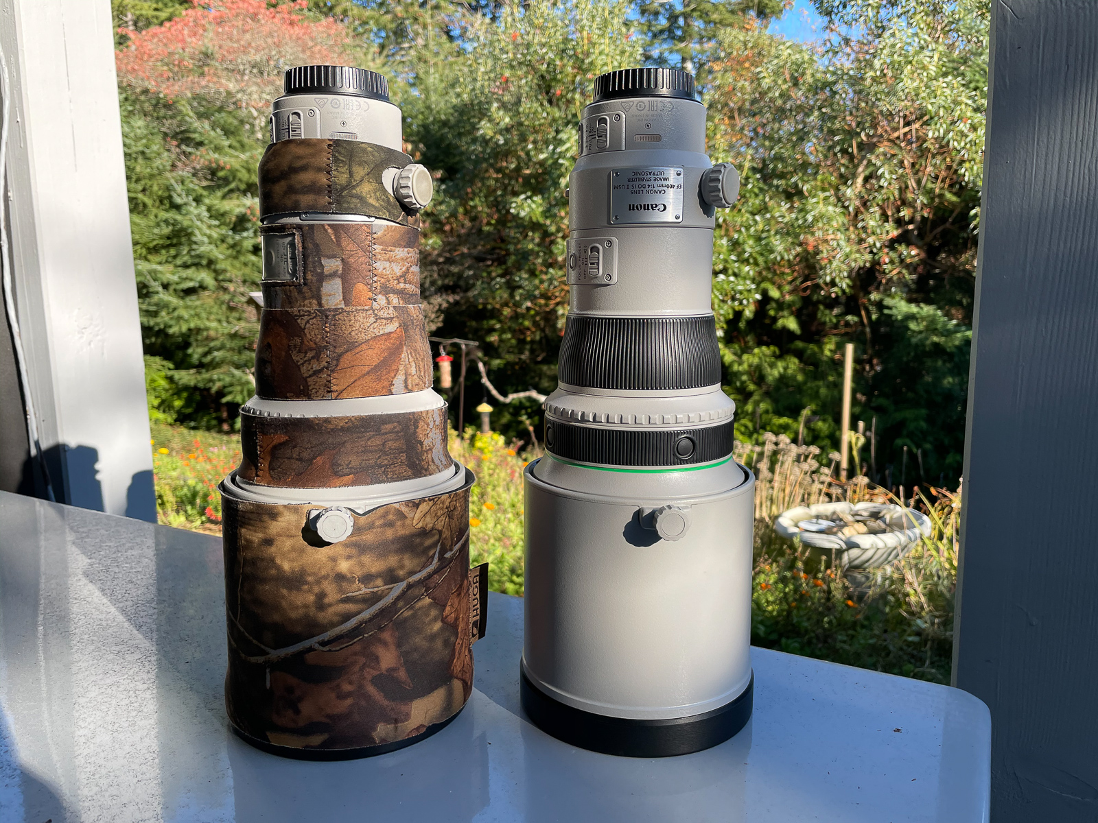

It's difficult to compare the 600 is III to anything... when I received one from CPS and compared it to my 500 IS II, I was blown away by the differences. The price tag did that as well.
