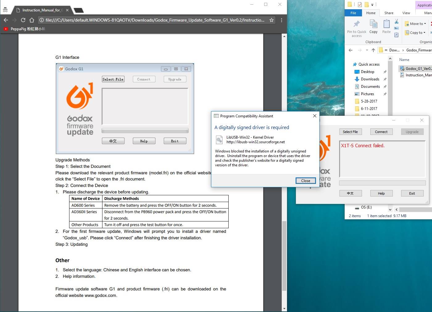

My X1T was working fine with the A7RII but I tried using the A9 on it and the white balance is off so now I'm forced to upgrade firmware. When the firmware update first came out, I got an error that a Windows-signed driver is required. Apparently this is a security feature on 64-bit Windows.
I recently tried it on another 64-bit Windows machine and got the same error. It refused to allow the installation of an unsigned driver.
Has anyone else gotten this error and would you advise disabling secure boot to allow the driver installation? Honestly, this seems quite sketchy to me. Or does everyone have old 32 bit laptops lying around that didn't block the install? I'm thinking about buying a $50 laptop off of ebay just for godox firmware updates, which seems a bit crazy, but I'm a little uncomfortable bypassing a security feature.

osv2
[X]
p.4 #7 · New Godox firmware for X1T-S transmitter with AF-assist!
i don't know about "disabling secure boot", maybe that's one of these two ways to work around the problem: http://windows7themes.net/en-us/windows-requires-a-digitally-signed-driver/
if you downloaded the update from the official godox site, i wouldn't worry about it... you can also upload the firmware update file to virustotal.com, where it'll get scanned by a bunch of malware checkers.
