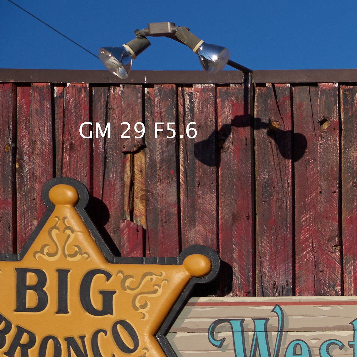

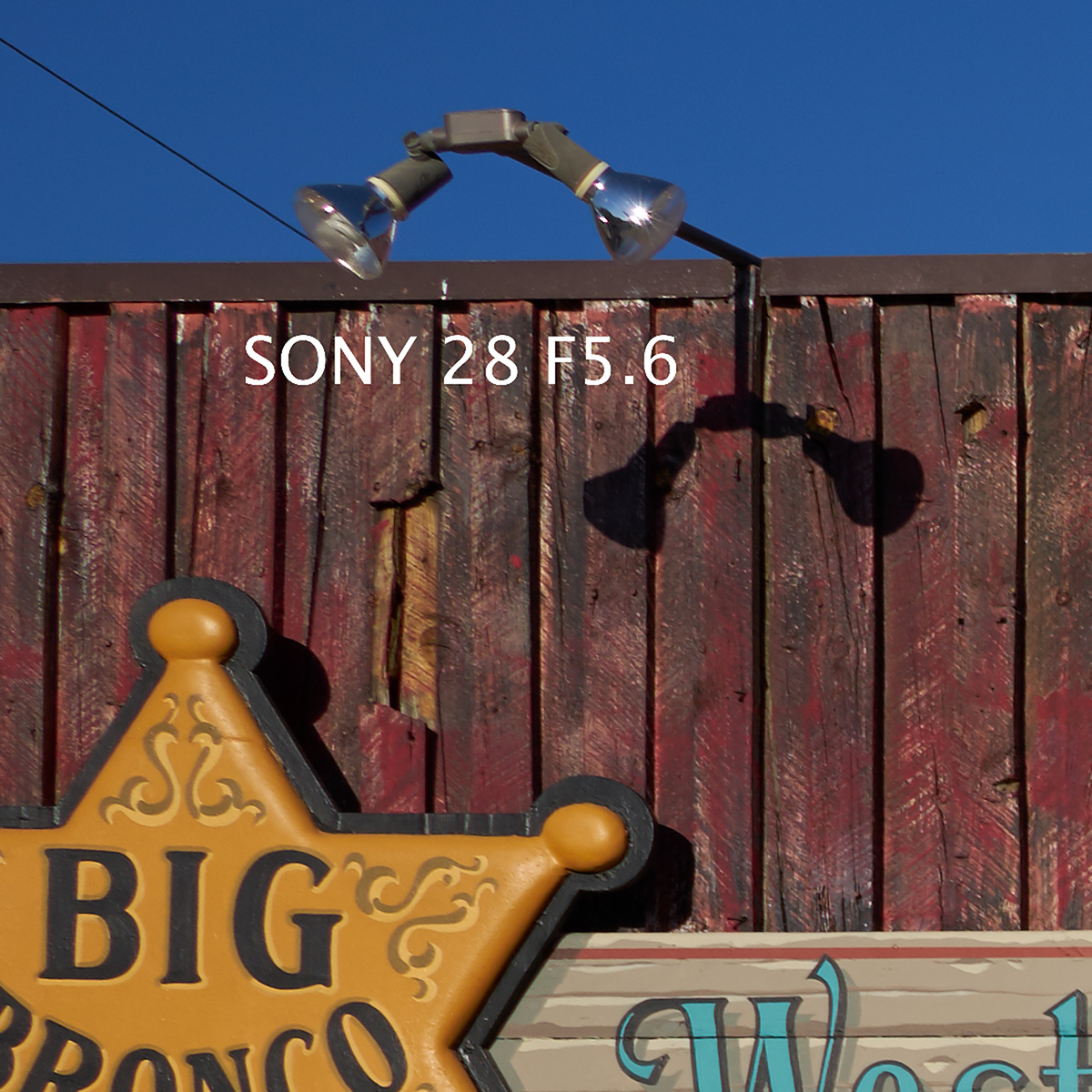

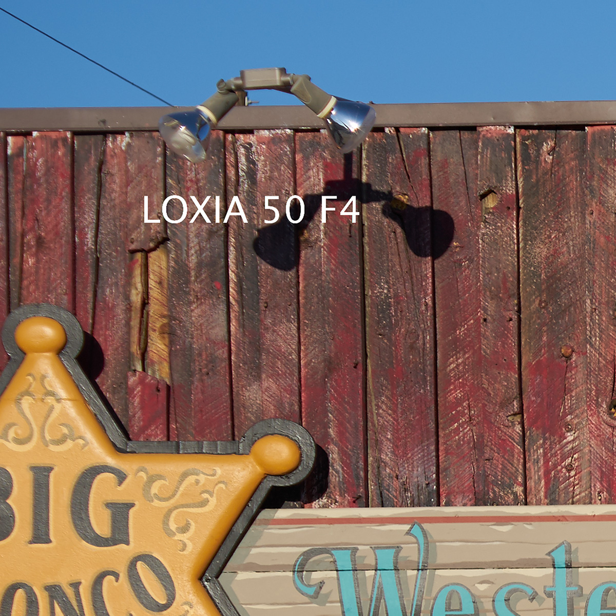

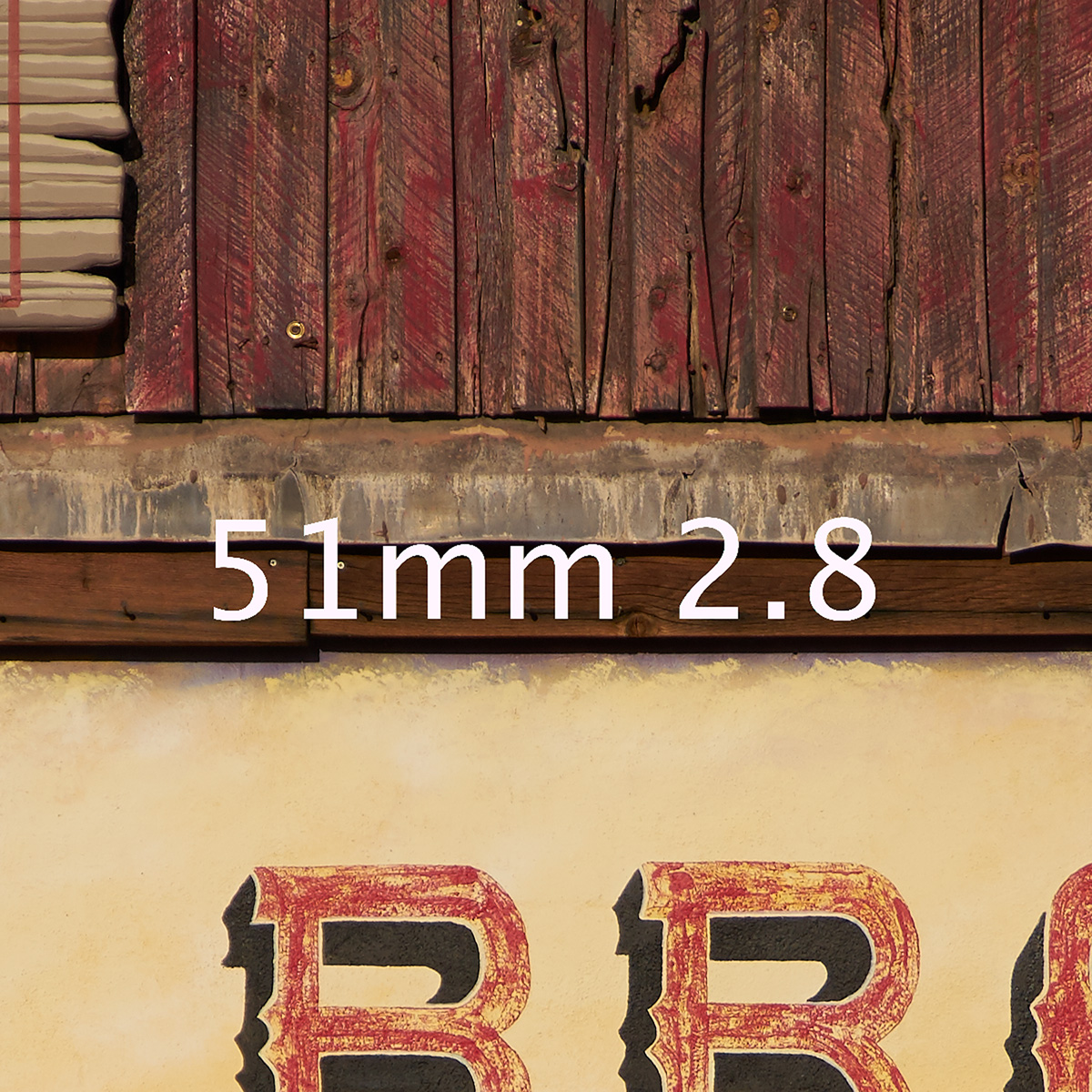

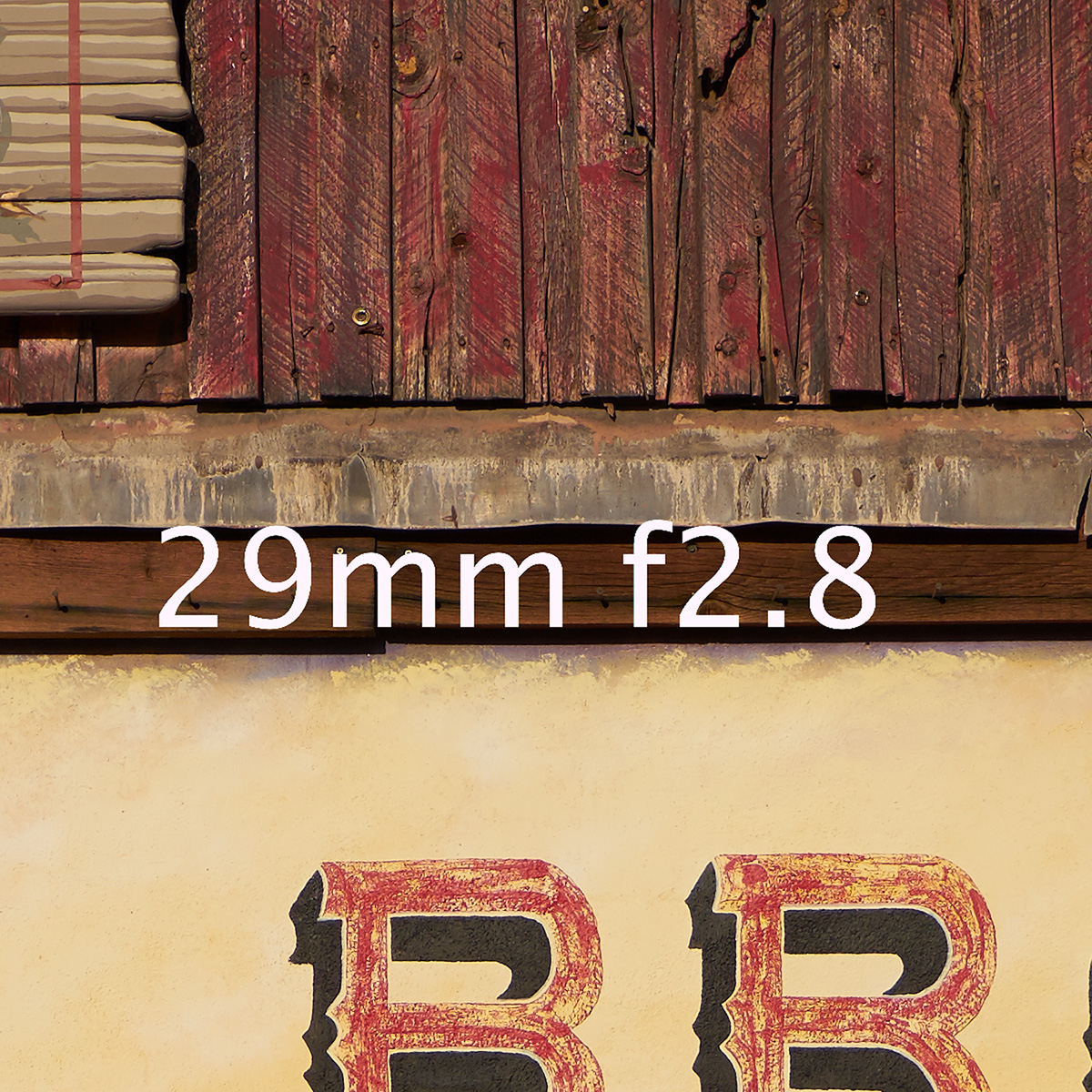

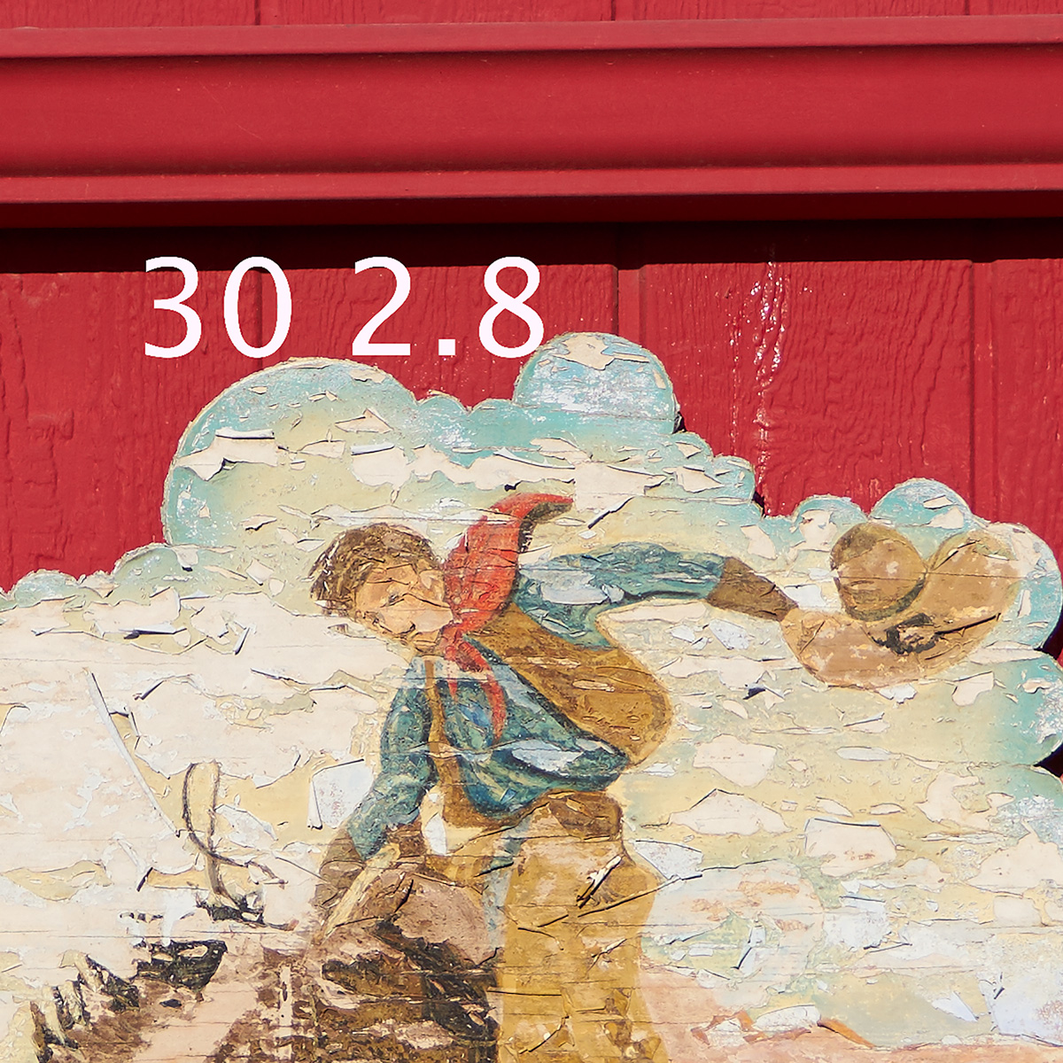

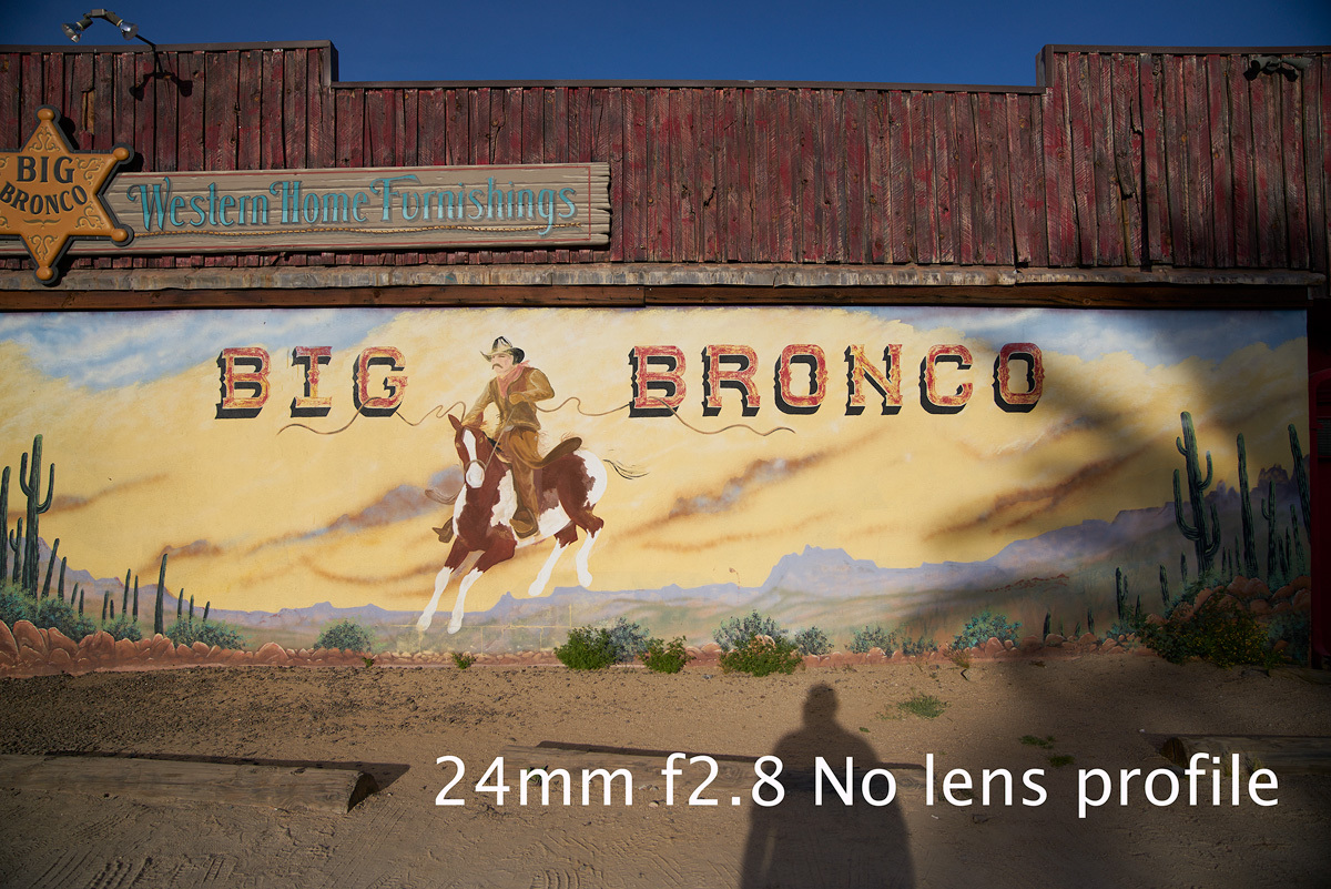

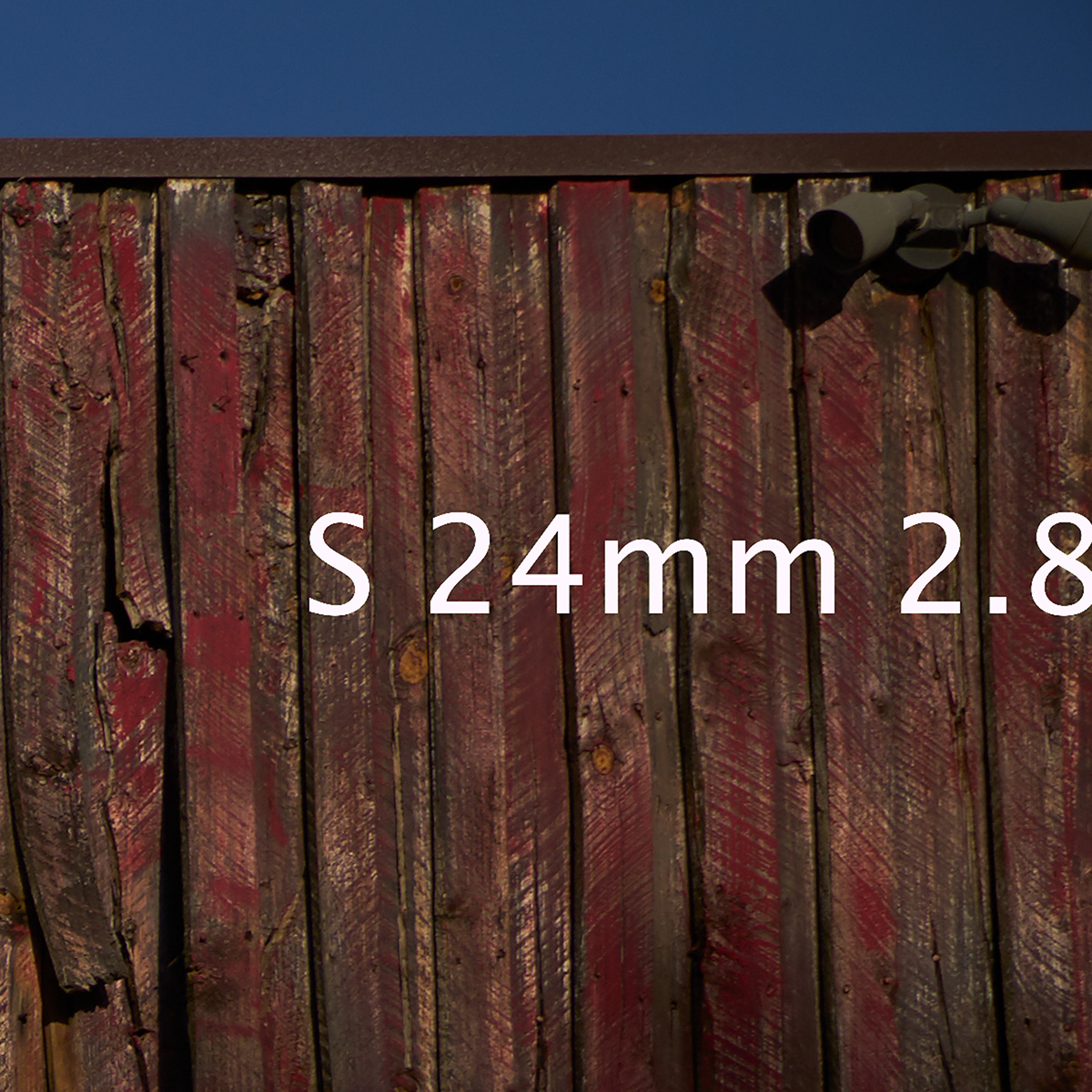

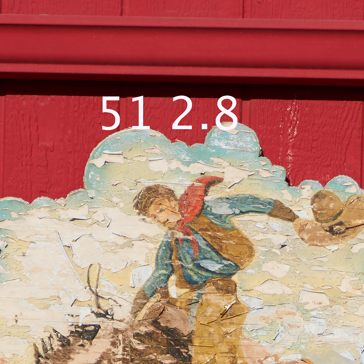

Fred Miranda wrote:

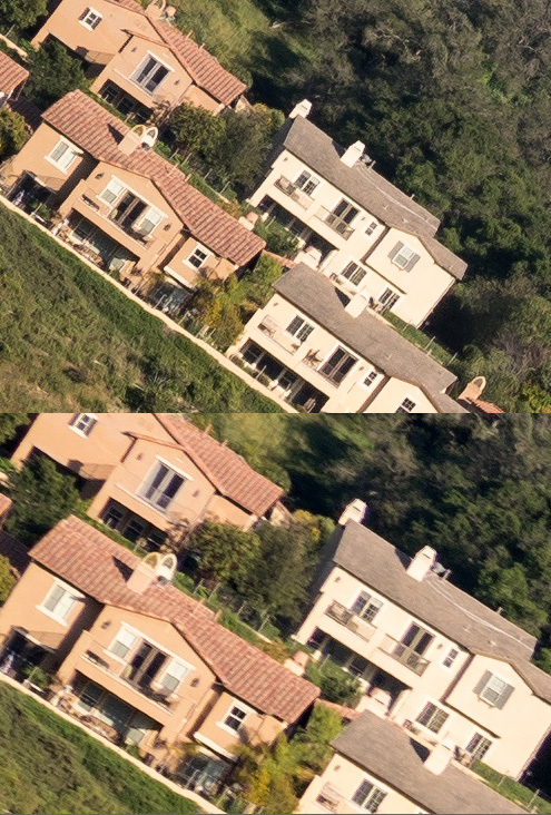

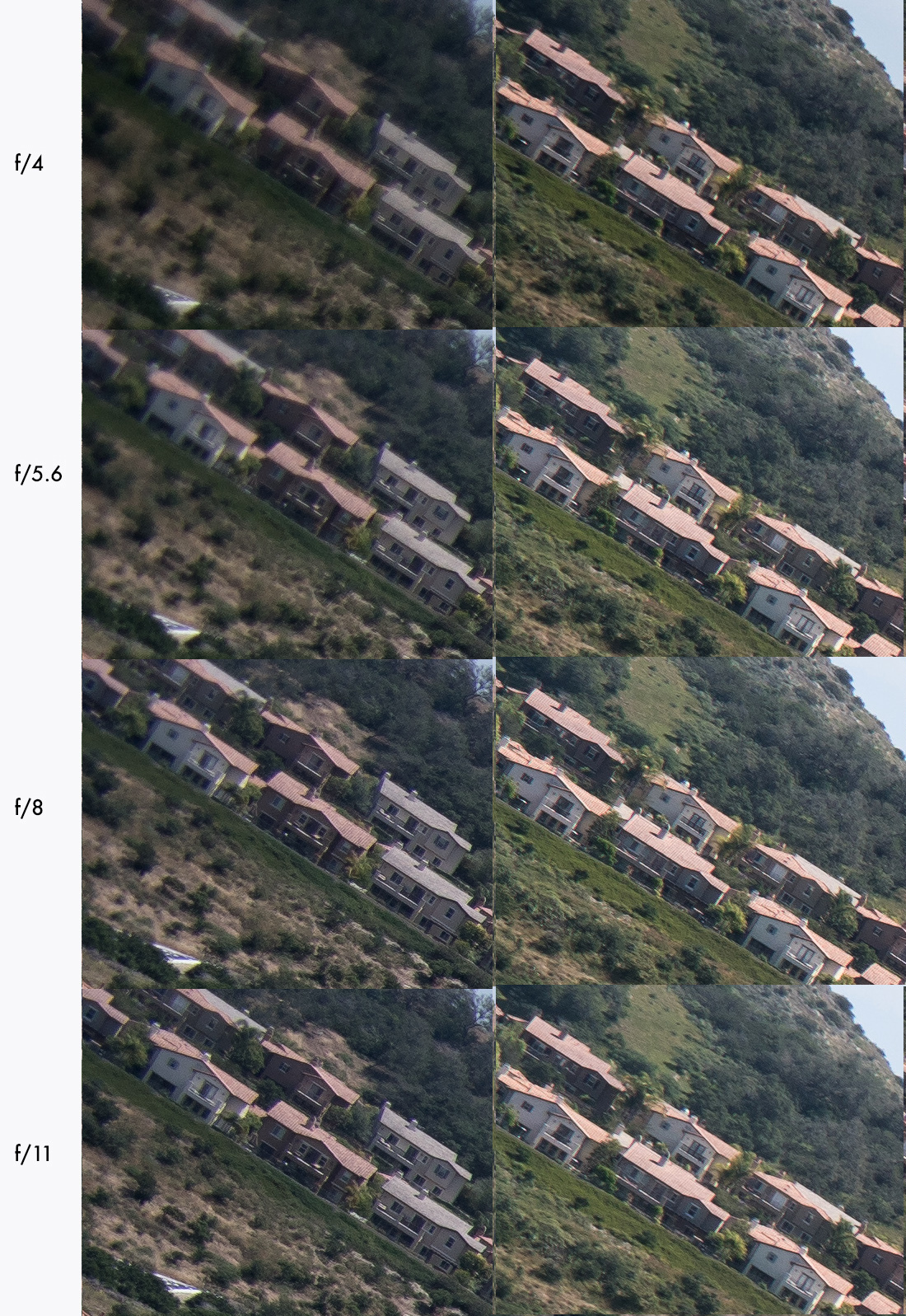

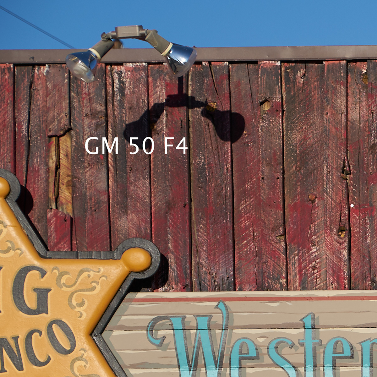

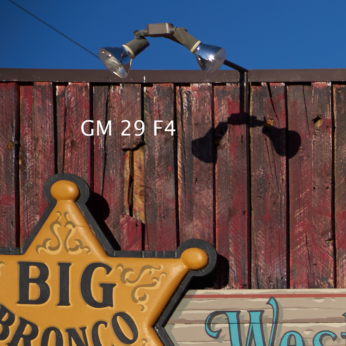

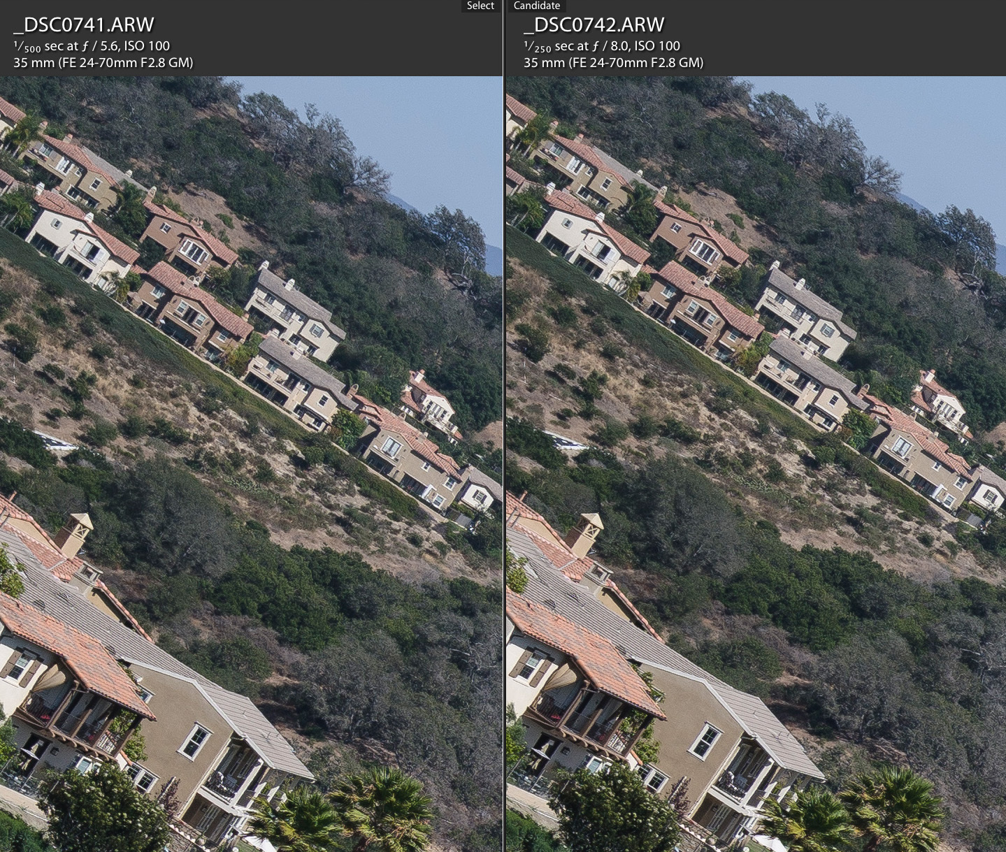

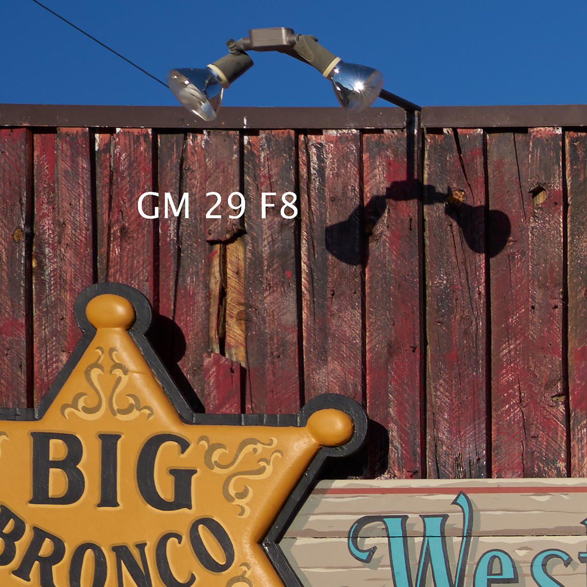

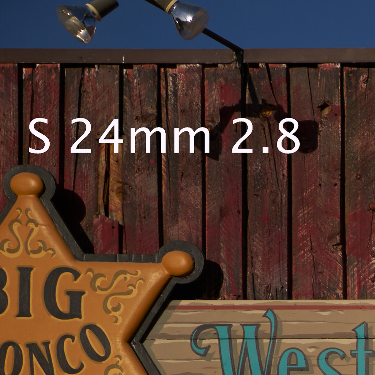

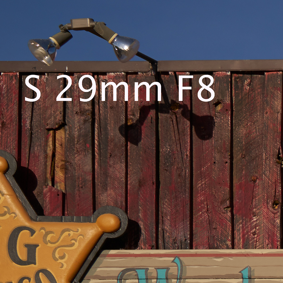

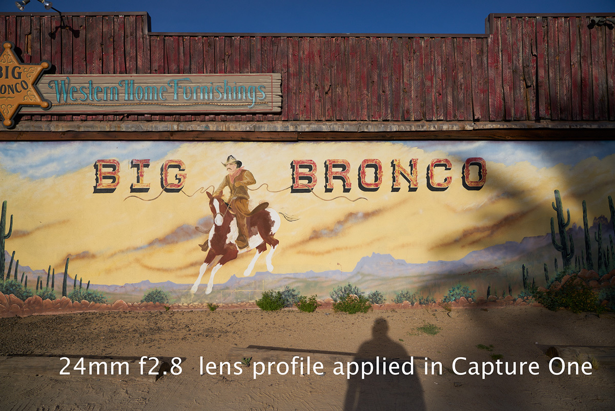

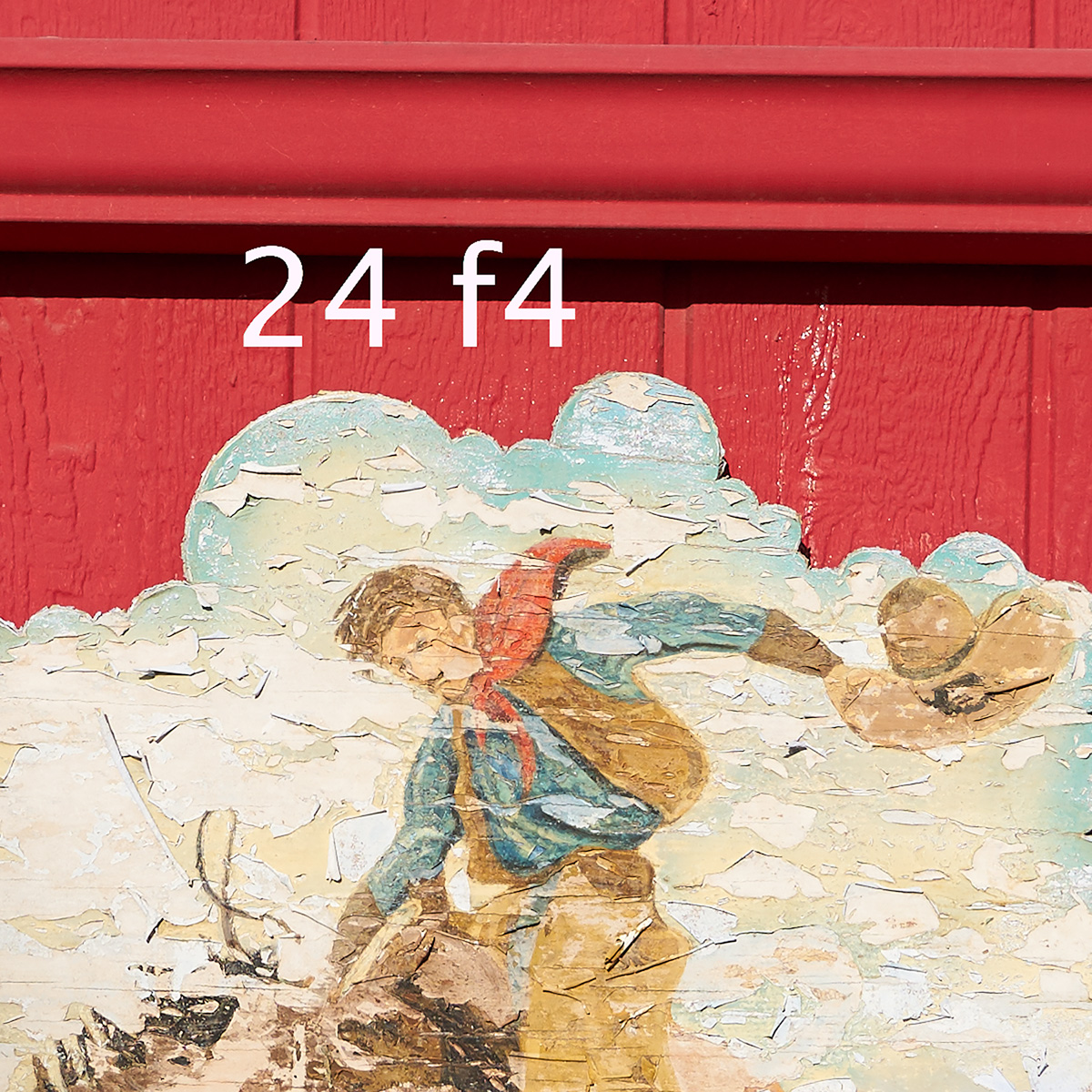

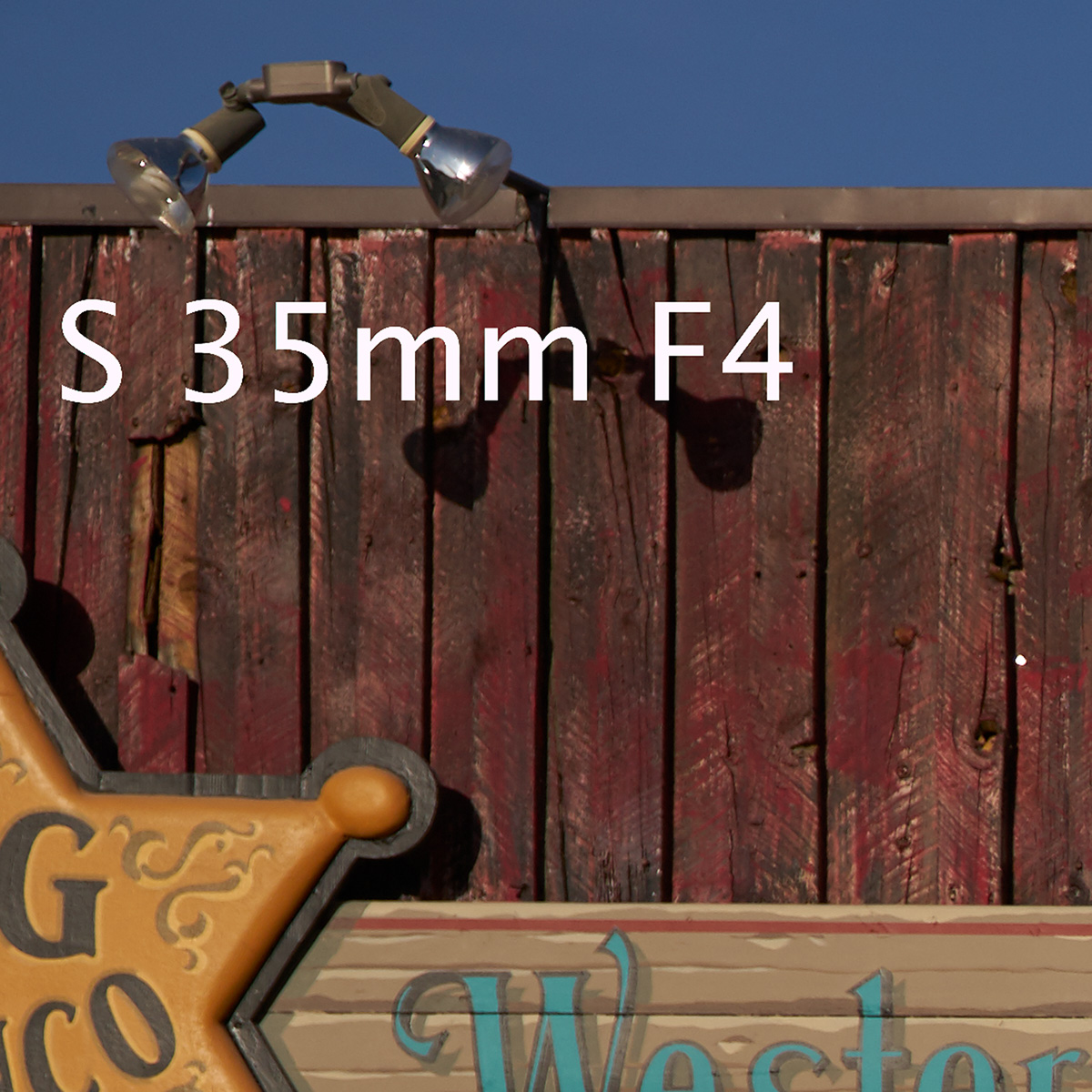

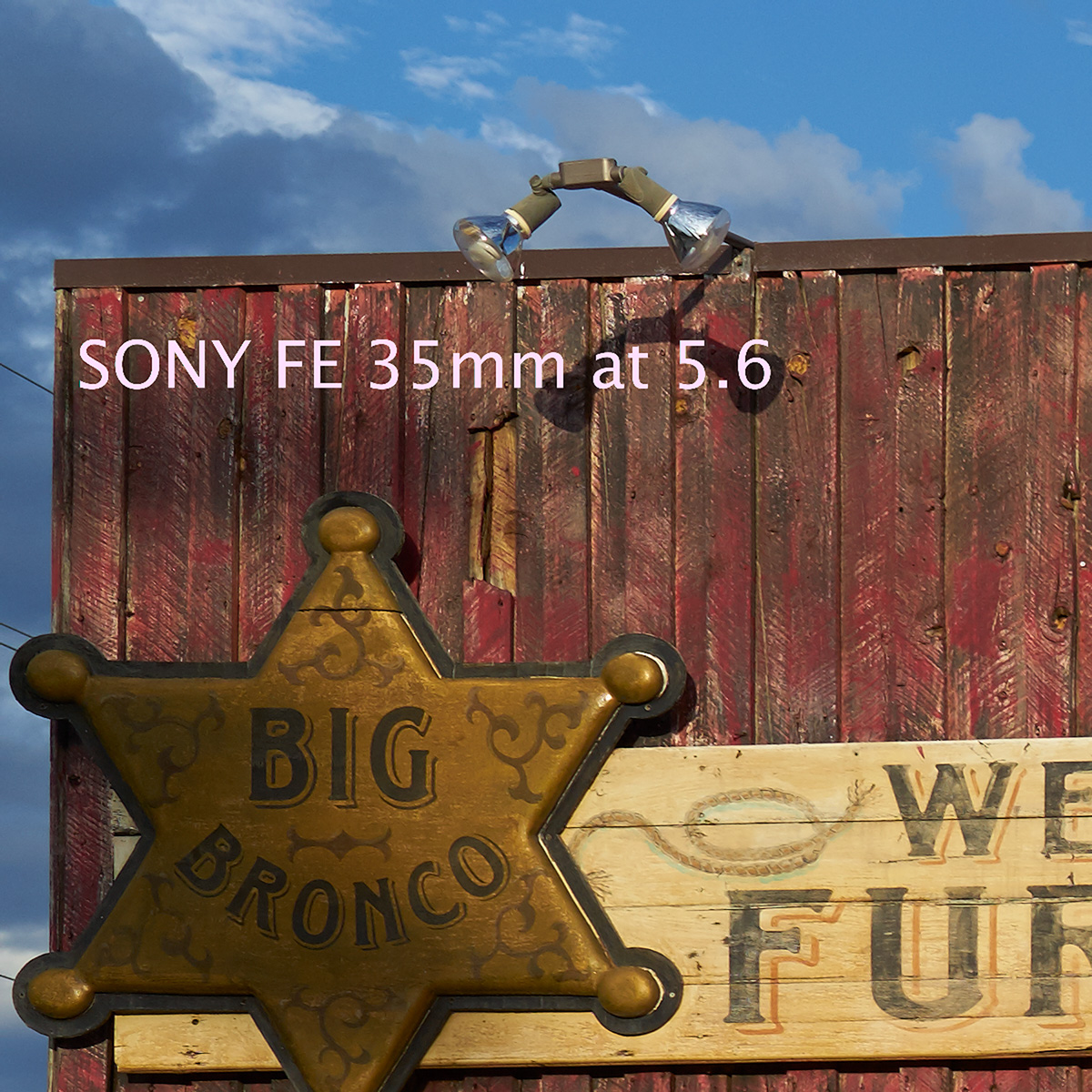

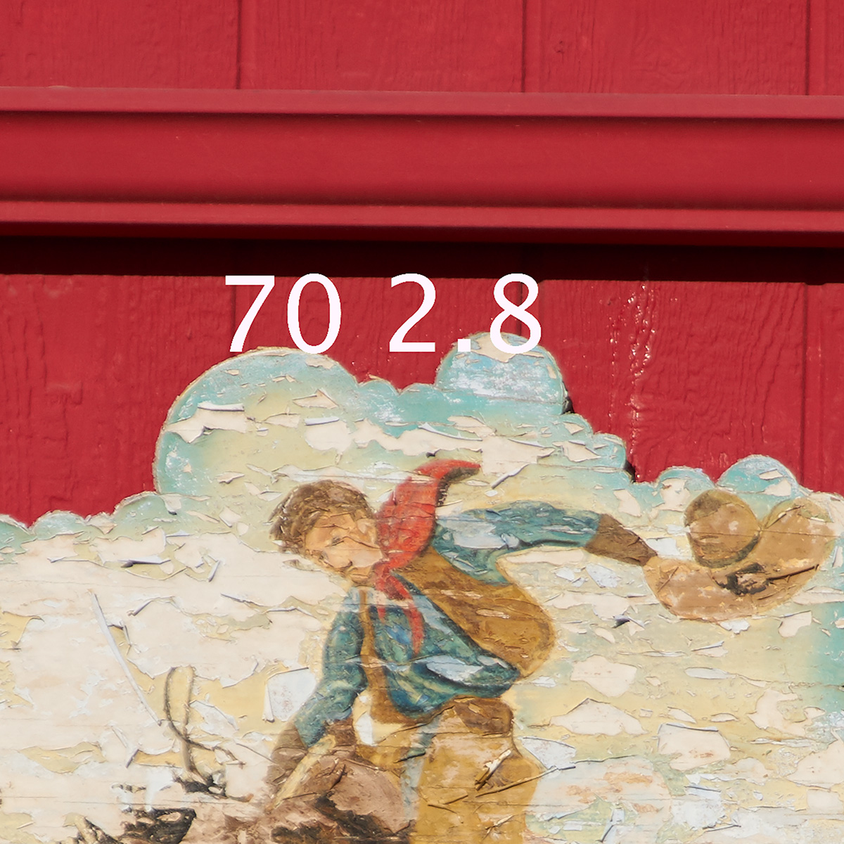

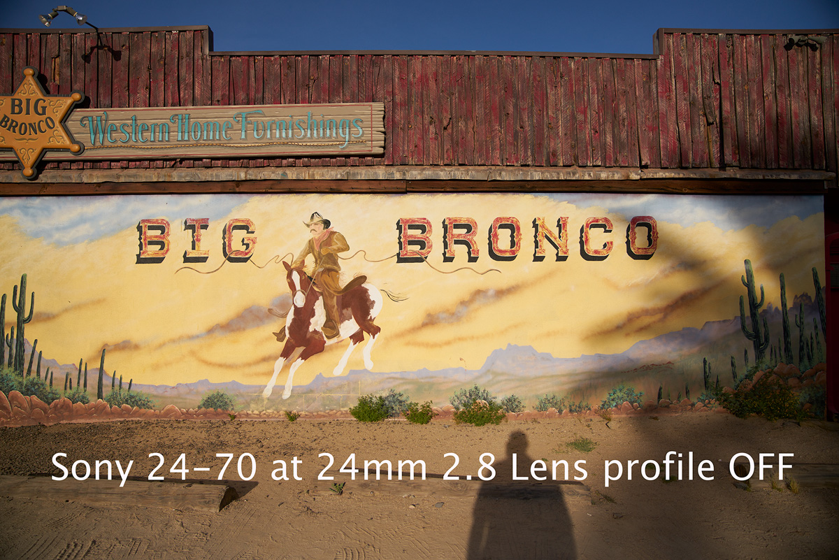

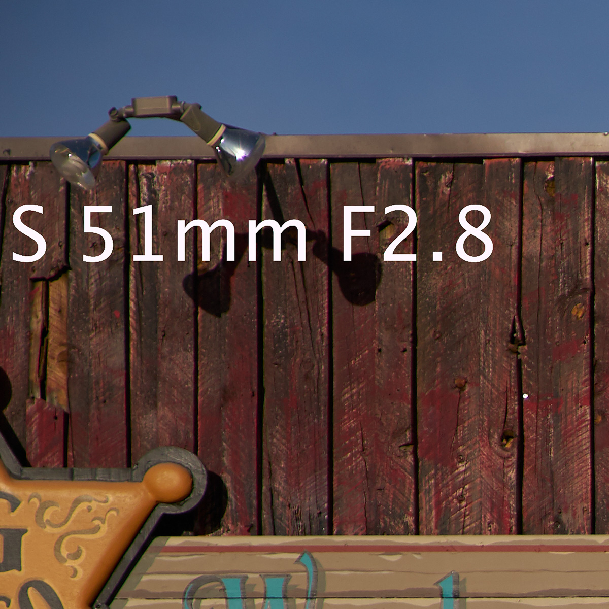

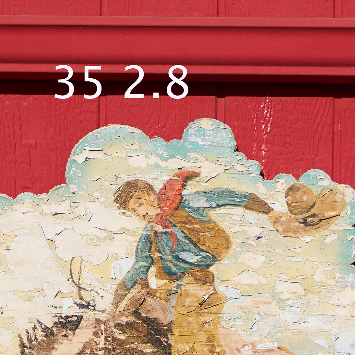

Here is the FE 24-70 GM @24mm with better lighting. Compare with the first post of this thread. The conclusions are the same but the aperture differences are more subtle.
https://www.fredmiranda.com/Buzz/24mm-new.jpg
CENTER | MID-FIELD | EXTREME EDGES
Thanks fred. This 24mm series does look noticeably better than the first.
Apr 02, 2016 at 08:56 AM
AGeoJO
Details
p.8 #2Sony FE 24-70mm f/2.8 GM Rolling Review
snapsy wrote:
Fred Miranda wroteHere is the FE 24-70 GM @24mm with better lighting. Compare with the first post of this thread. The conclusions are the same but the aperture differences are more subtle.
Yup, I agree.
Fred Miranda wrote:
Maybe I should do the same for the 35, 50 and 70mm FLs, but that will have to be tomorrow.
Looking forward to that, Fred and thank you!

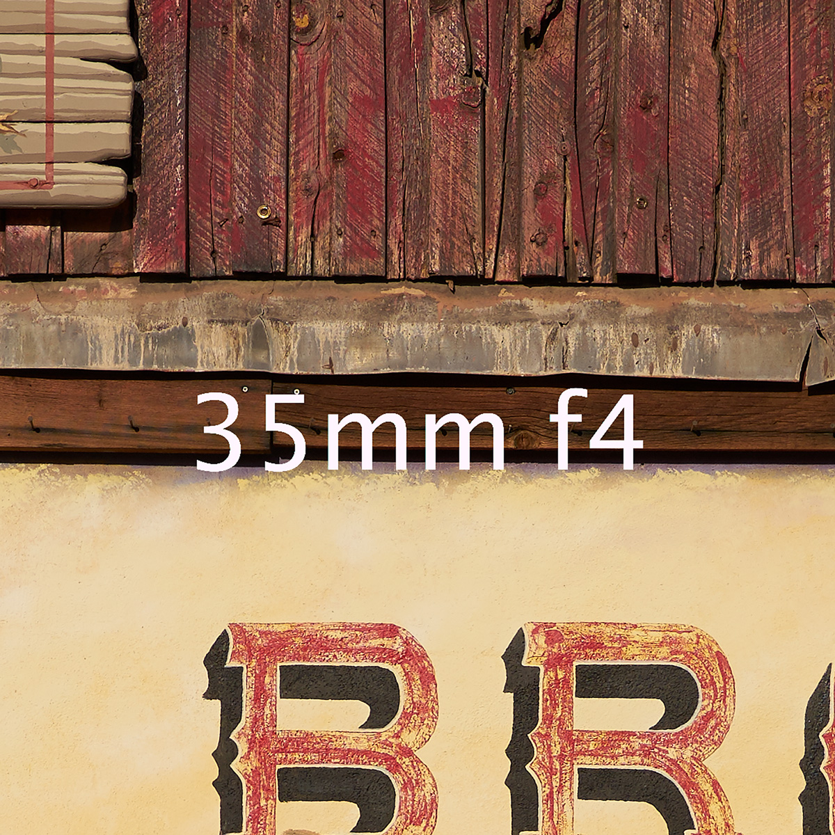

Yea like to see 35 in particular

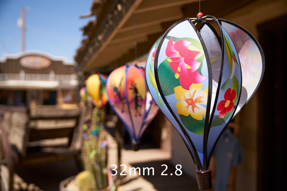

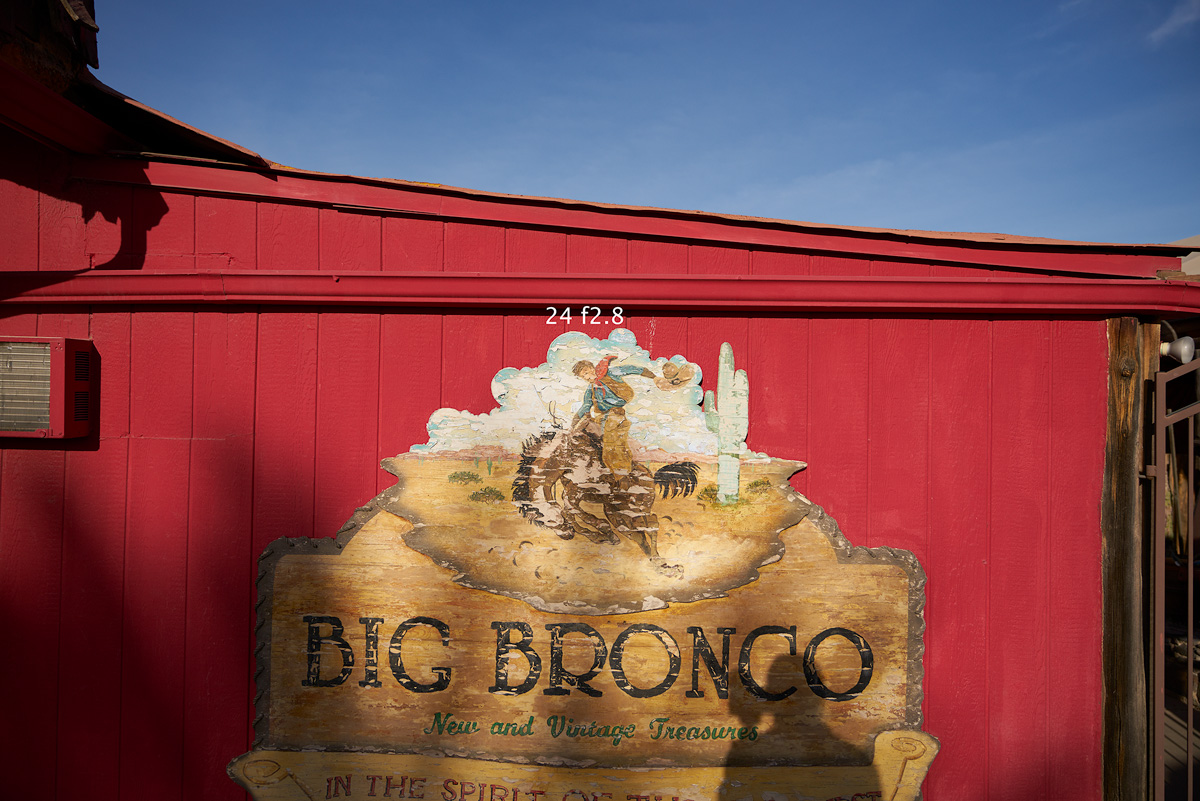

p.8 #5Sony FE 24-70mm f/2.8 GM Rolling Review

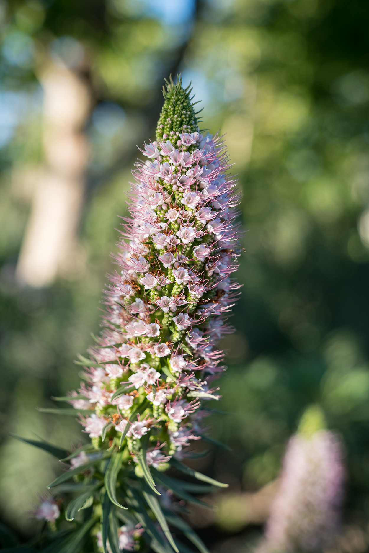

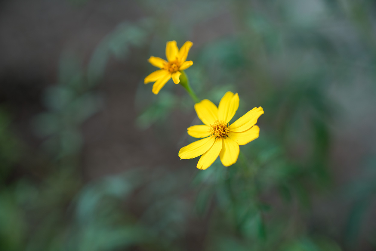

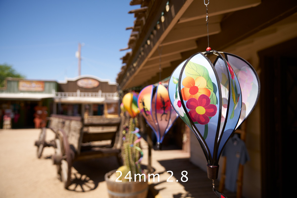

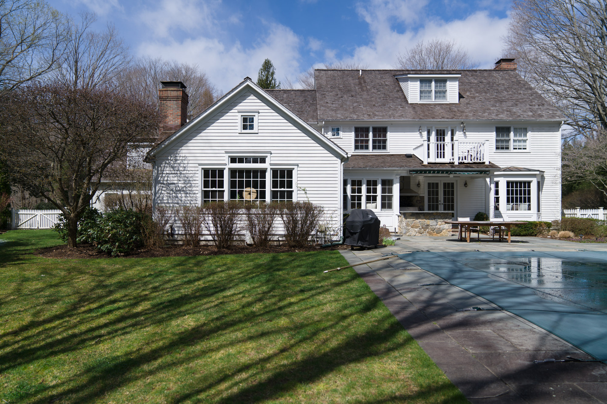

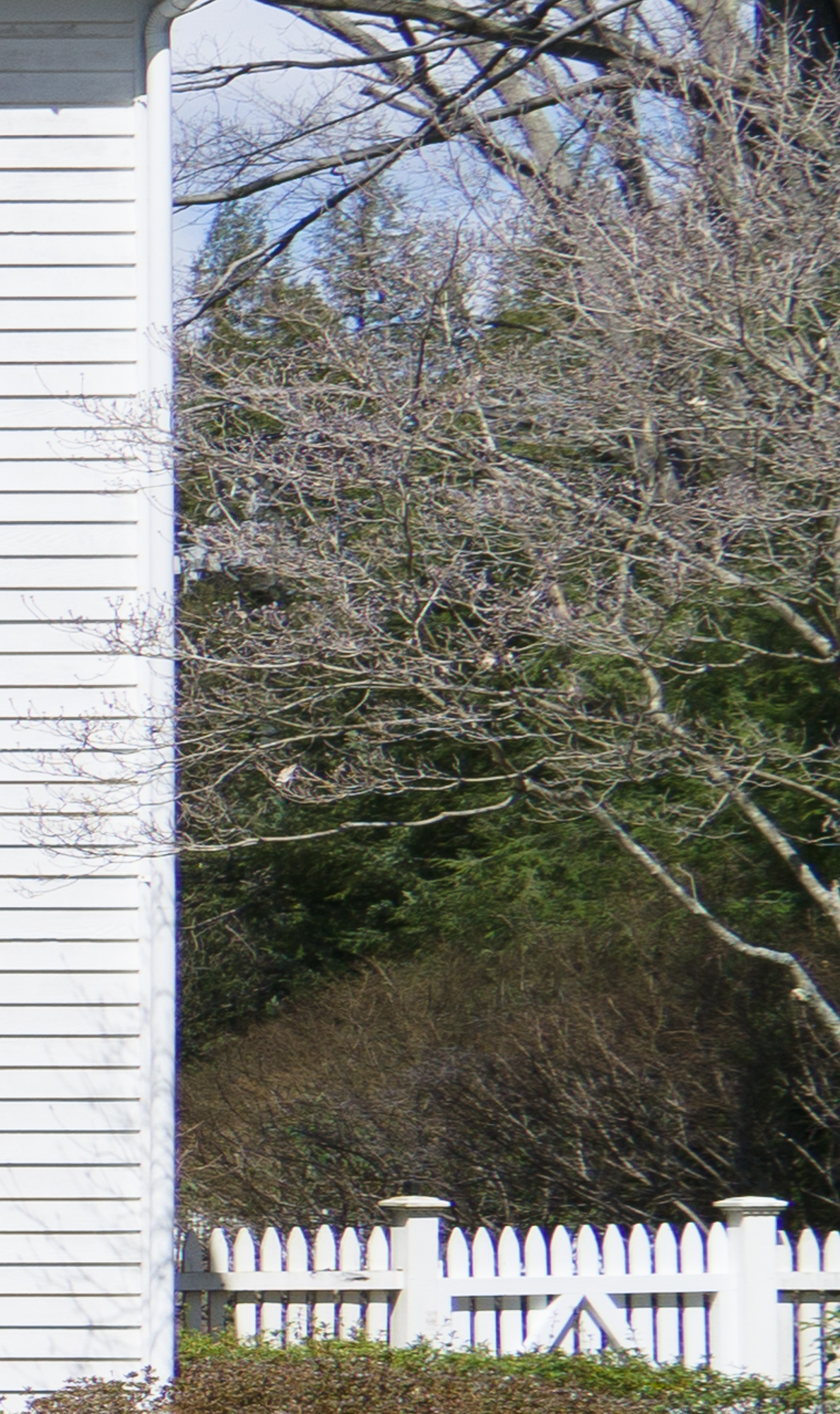

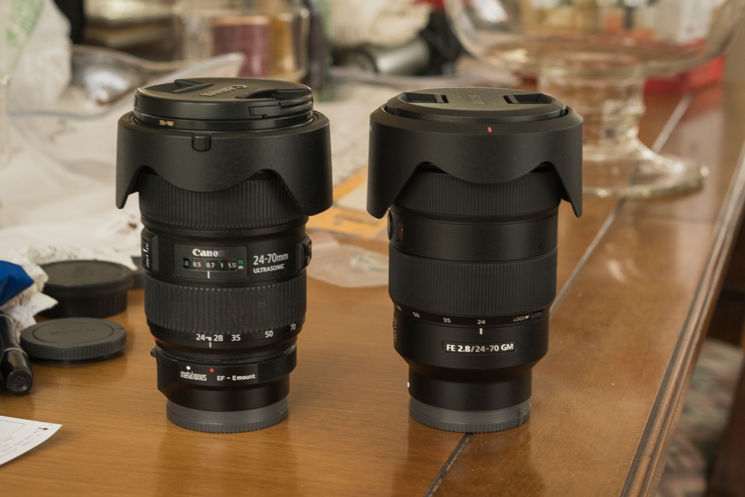

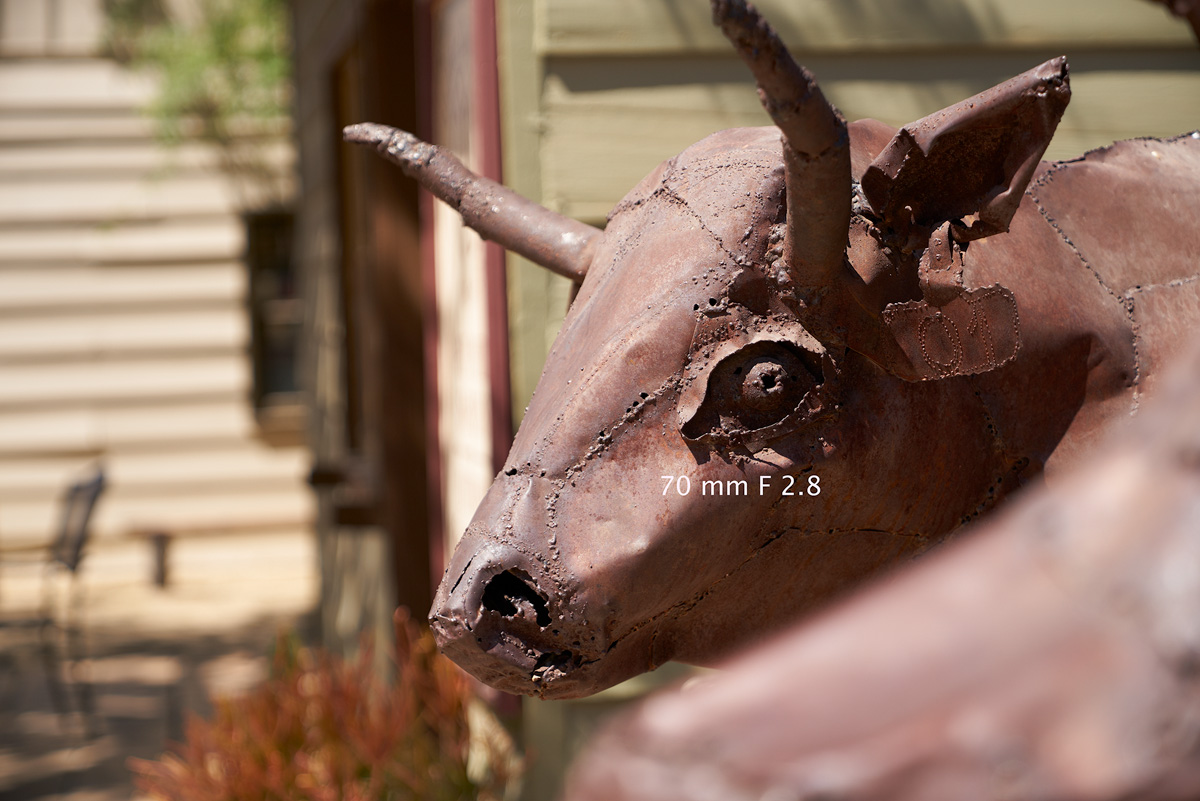

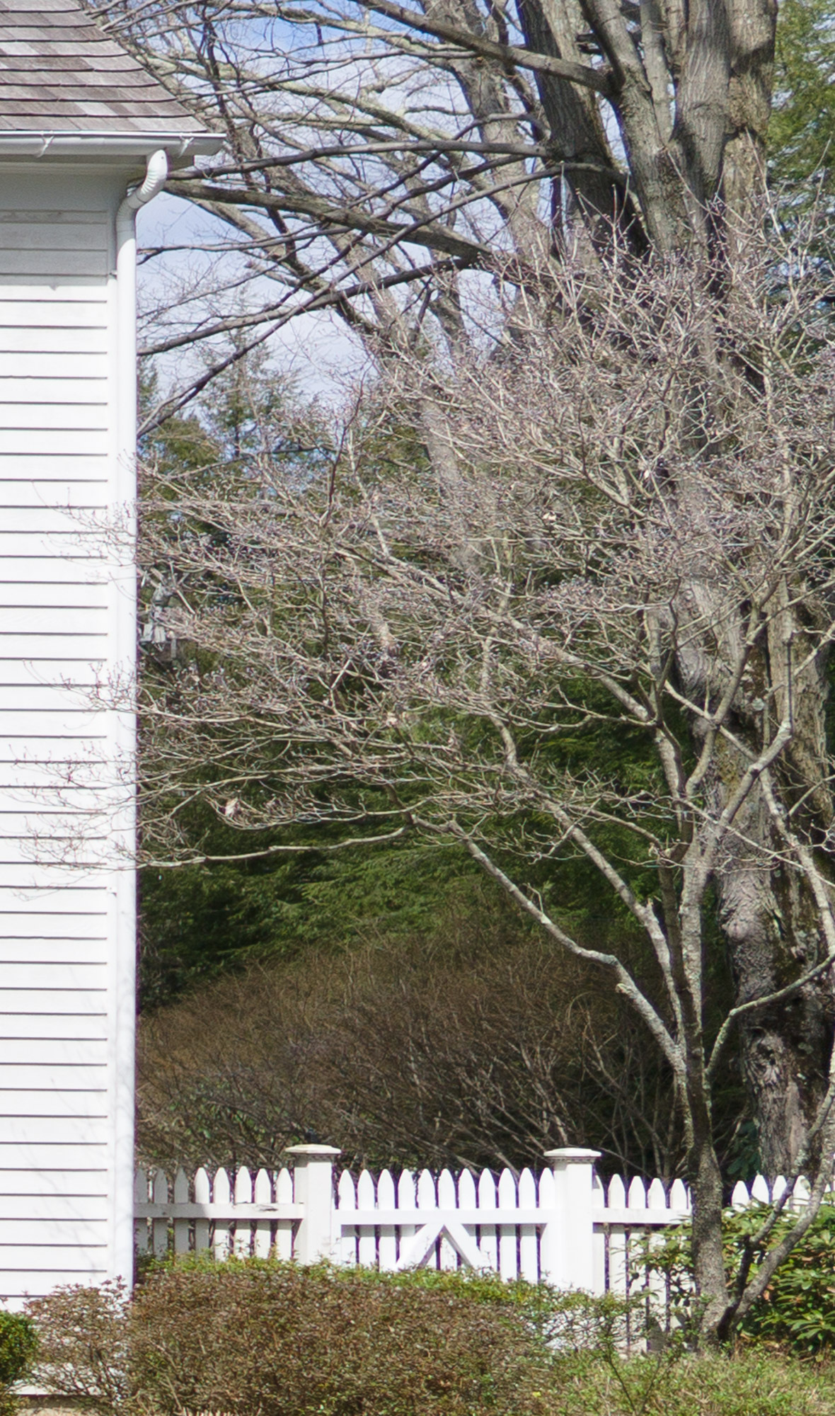

Here are some I took yesterday afternoon when I first got my lens. Nothing special. All taken at f/2.8 hand held with AF set to flexible spot and AF-S.
I took some side by sides images of the of my Canon EF 24-70mm f/2.8L II and the Sony FE 24-70mm f/2.8 GM. With the metabones adapter they are within mm of each other in length, weight is almost identical and hood designs are really the same. One thing I noticed is it zooms from 24-70 the same way the FE 16-35 and 70-200 f/4's do. Nice.
Did do lens correction in LR CC and some small auto exposure adjust.
Don't know how the reduction form 23 - 40 MB jpeg to 1.4 MB jpeg will impact the quality but the site has limitations.
The two with trees lose a lot of quality.
Apr 02, 2016 at 09:31 AM
GMPhotography
Details
p.8 #6Sony FE 24-70mm f/2.8 GM Rolling Review
I'm looking at the bokeh in the first images and it very pleasant. No nervousness , you shot them around 35 mm. Looks good with some nice pop too.
The first one that background would get very nervous looking on a lot of lenses. Very nice
Edited on Apr 02, 2016 at 09:54 AM · View previous versions
Apr 02, 2016 at 09:52 AM
This is where these GM's need a good testing, close focused, wide-end and at maximum aperture.
Apr 02, 2016 at 10:09 AM

p.8 #10Sony FE 24-70mm f/2.8 GM Rolling Review
chrisgibbs wrote:
GMPhotography wroteI'm looking at the bokeh in the first images and it very pleasant. No nervousness , you shot them around 35 mm. Looks good with some nice pop too.

You could leave her at 24mm @f/2.8 and walk around shooting anything that appears in your viewfinder, the brighter, the more contrasty the better and get a better idea of what this lens is really all about than 99% of the stuff we saw from the Beta testers. The magic of these GM's is how they render the OOF areas.

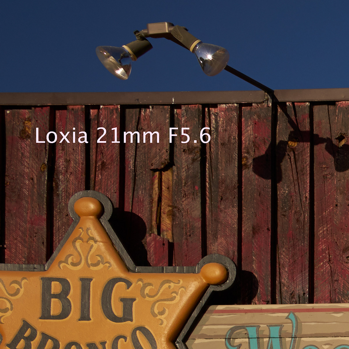

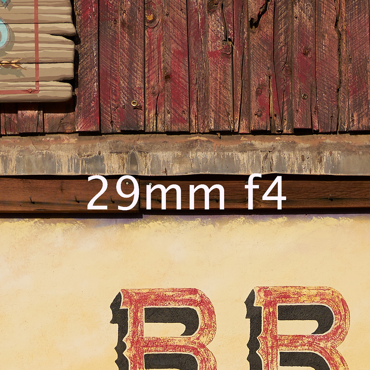

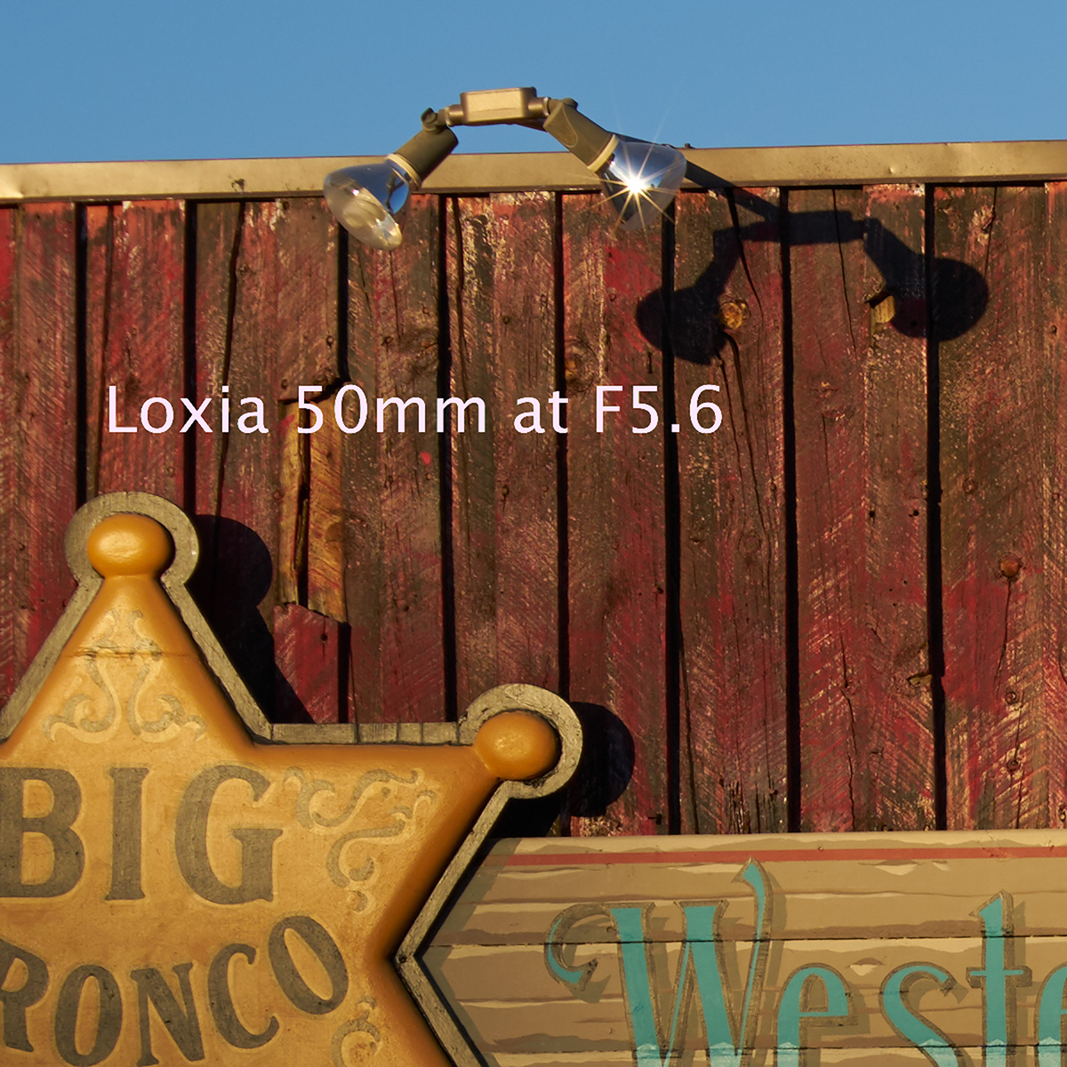

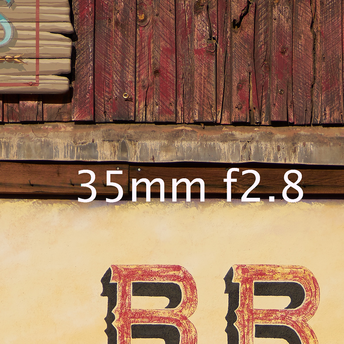

p.8 #13Sony FE 24-70mm f/2.8 GM Rolling Review

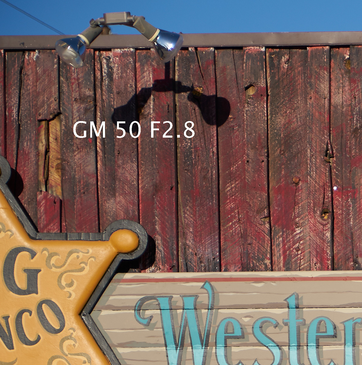

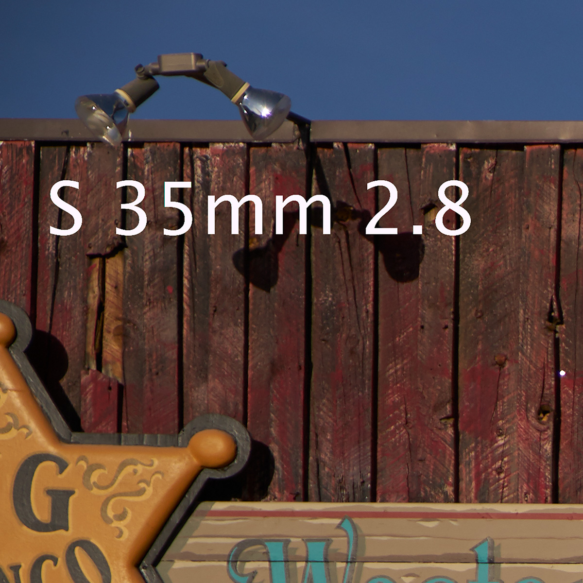

The new crops shot with better lighting were added to the first post.
You can see 24, 35 and 50mm there right now.
https://www.fredmiranda.com/forum/topic/1422120/0#13490765

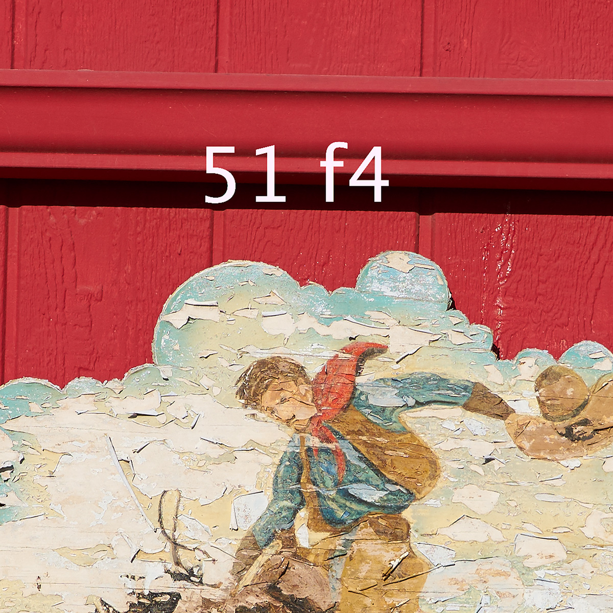

p.8 #14Sony FE 24-70mm f/2.8 GM Rolling Review
Thanks Fred
Apr 02, 2016 at 10:26 AM
GMPhotography

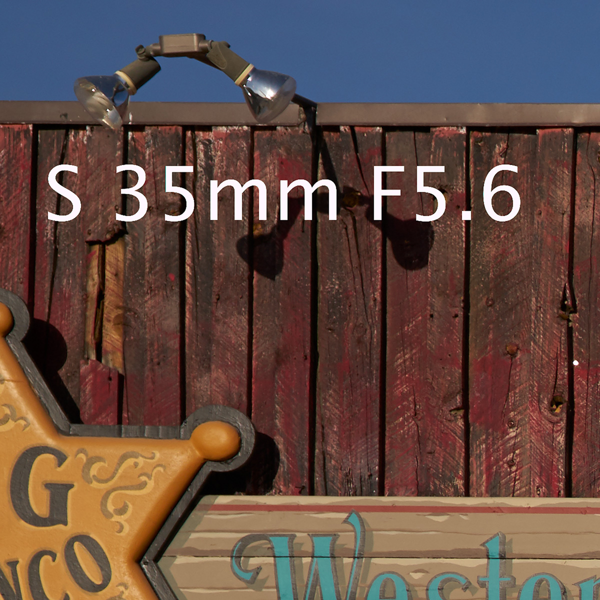

Details

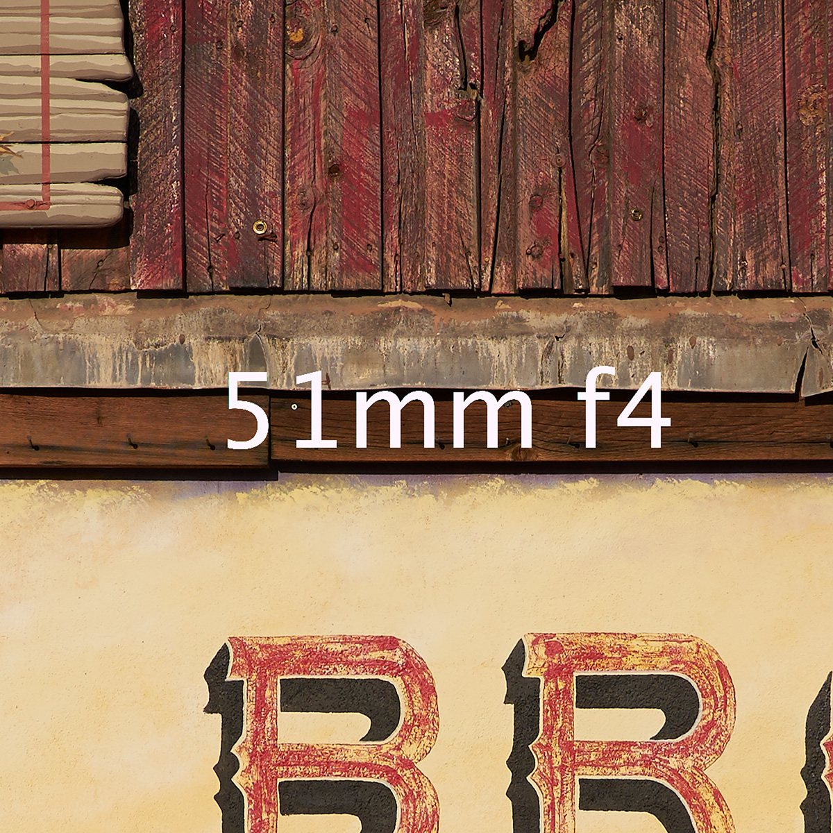

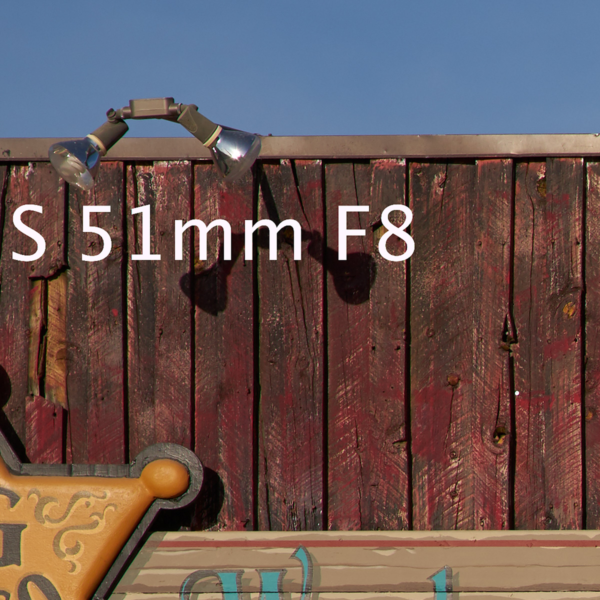

p.8 #15Sony FE 24-70mm f/2.8 GM Rolling Review

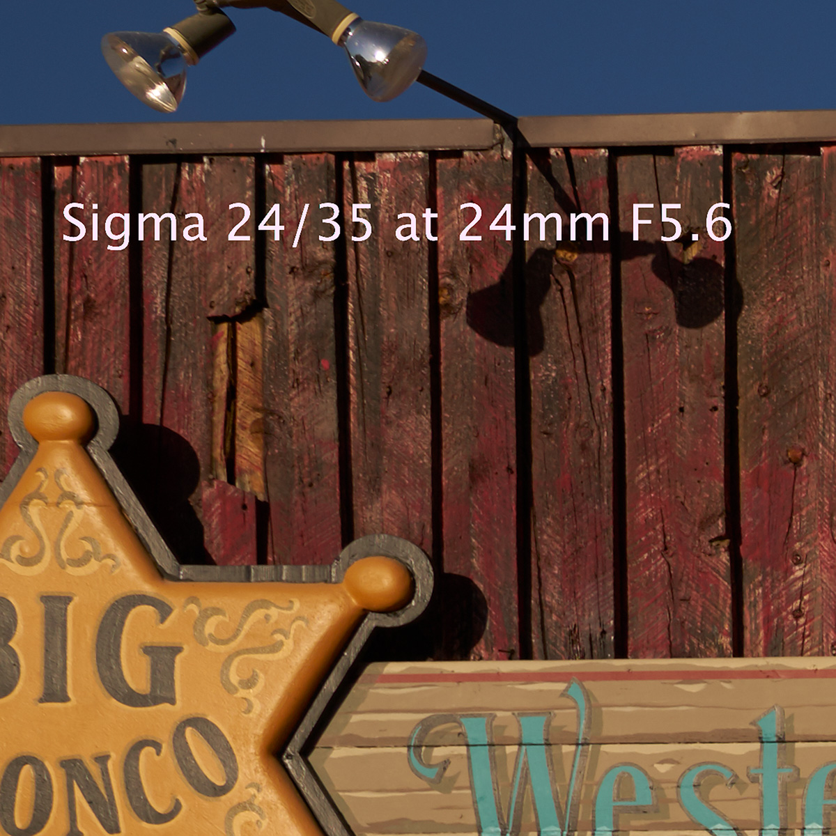

Wow what I'm seeing at F4 center and midfield really look good 5.6 optimum and extreme corners 5.6 it's starting to look great a F 8 hits it in the extreme corners.
Let me state right now the Sigma 35 1.4 , VC 35 1.7 would not get this good into the midfield and corners till about F8. So advantage zoom. Both these lenses have field curvature.
Apr 02, 2016 at 10:53 AM
GMPhotography
Details
p.8 #16Sony FE 24-70mm f/2.8 GM Rolling Review
The 50 looks a heck of a lot better in this series for sure. Field must flatten as F4 across the board looks great and optimum 5.6 across. If I remember correctly in early series it was not this good
Apr 02, 2016 at 10:54 AM
GMPhotography
Details
p.8 #17Sony FE 24-70mm f/2.8 GM Rolling Review
Major improvement with this lighting. I'm stoked
Hope I'm not sounded like a fanboy but this lens is really good so far
Apr 02, 2016 at 10:58 AM

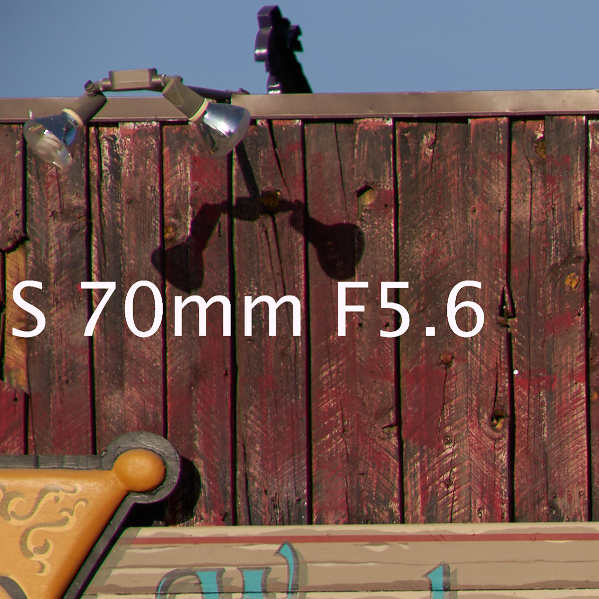

Admin
Details

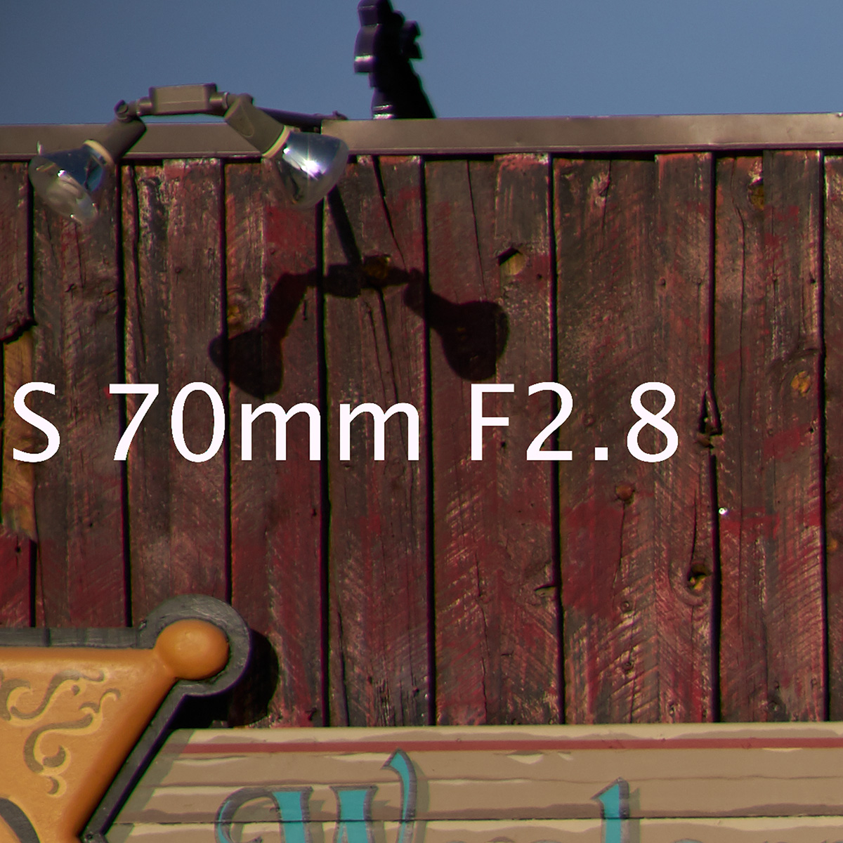

p.8 #18Sony FE 24-70mm f/2.8 GM Rolling Review

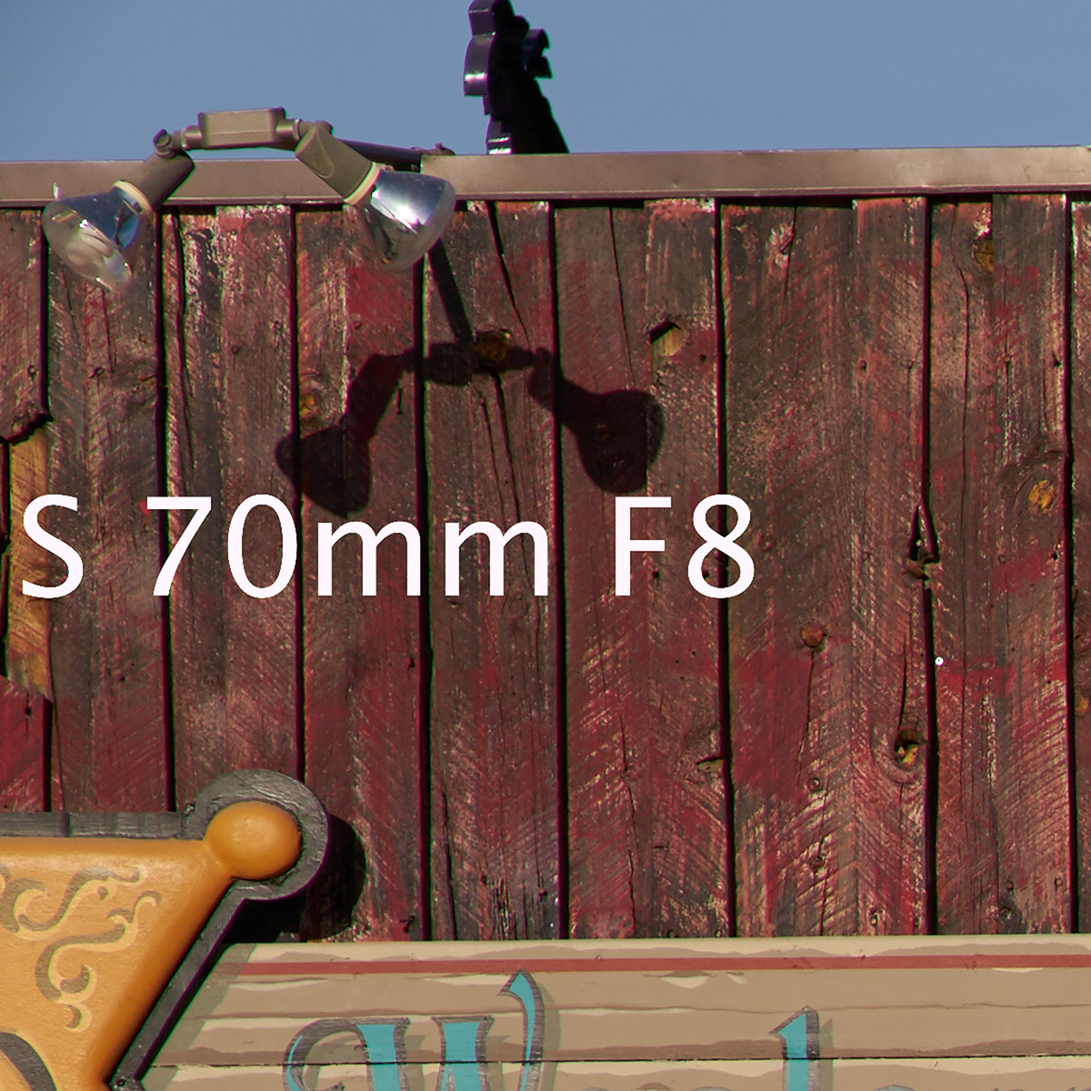

The new 70mm crops were updated on the first post:
Apr 02, 2016 at 11:05 AM
GMPhotography
Details
p.8 #19Sony FE 24-70mm f/2.8 GM Rolling Review
Hmmm seems like even 2.8 on center and midfield look really good but corner it starts at 5.6. Just thinking out loud maybe pin cushion distortion. Thoughts
Apr 02, 2016 at 11:09 AM
