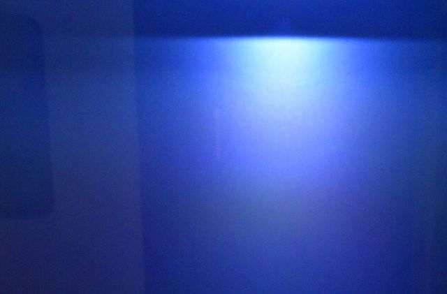

p.6 #4 · D750 horrible light leak (black bandit!) reported; Looks horrible "updated"
I finally reproduced the horizontal flare boundary with my D750 using an LED flashlight. Mounted the same lens and exposure settings (50G f/1.4 @ f/1.6) on my D800 and don't see the boundary on it. I shot this using the LV movie mode on the body, which crops the frame a bit so that boundary is higher than the other videos that recorded the LCD screen. I also tried my Sony NEX-5N using a different lens (worse flare characteristics) and that produces several striated flare boundaries.

p.6 #5 · D750 horrible light leak (black bandit!) reported; Looks horrible "updated"
Snapsy, yes you were able to duplicate them on the D750 and your NEX-N5. The problem is the N5 does not have a focusing sensor at the bottom of the black box and still exhibits the same issue, so now is that the common Sony sensor and it's on board firmware?
Since you have both cameras, can you confirm if the focusing sensor is sitting shallower on the D750 than the D800? Or is the tilting angle slightly different?
Thanks!

Hey, snapsy. Good work!
I just reposted your video to another forum, if you want me to take it out please let me know.
I don't think the flare caused by lens. Did you try using a rain cover to wrap the camera body and lens mount to avoid this issue?

p.6 #9 · D750 horrible light leak (black bandit!) reported; Looks horrible "updated"

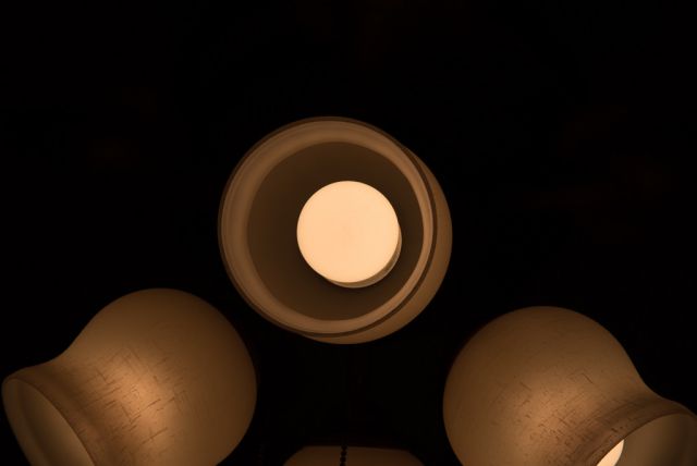

I was finally able to reproduce it with my 50 1.8g (No hood or filer on lens) using LED flashlight. Not able to reproduce using Nikon 24-120 F4 or Nikon 70-200 2.8 VR.
My unscientific conclusion is that the light leak can be re-produced on D750 if done properly, but you certainly have to go through a lot of trouble to do so. Since I don't shoot LED's all day, not worrying about it

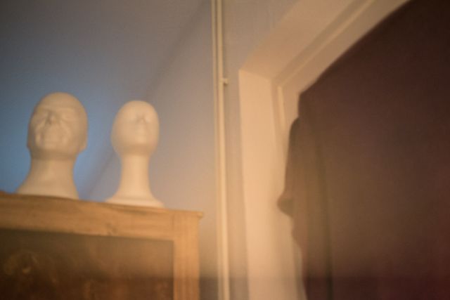

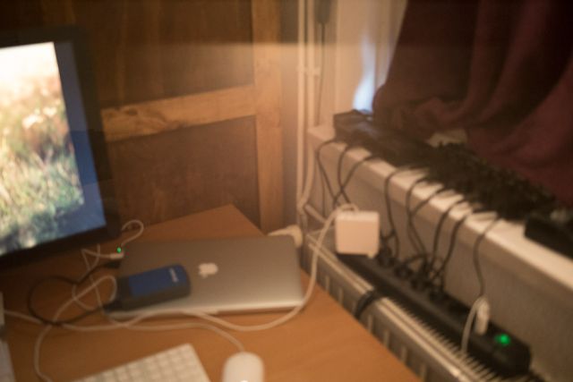

p.6 #15 · D750 horrible light leak (black bandit!) reported; Looks horrible "updated"
I feel the issue is very easy to reproduce.
Point the cam at a strong light source and tild the camera slowly up and down in LV. Once the light source leaves the images there is a small area where you get the dark band. It happens both in LV and with taking the image regular.
It happens at the upper BUT also at the lower part of the image! Though stronger at the upper part. So it is not a shutter issue, nor a reflexion of the mirrors/AF something.
It feels like there is a shadow been thrown by something (mirror box?)
I have good connections to Nikon Germany and talked to them. The chief of repair did not know about the issue. I sent him the images and await a reply.
Here are two examples:
heiko
(proff. wedding photog)
Edited on Nov 26, 2014 at 10:47 AM · View previous versions

Oh , forgot:
35/1.8 G, serial number: 60028xx

vjaved
p.6 #19 · D750 horrible light leak (black bandit!) reported; Looks horrible "updated"
I
...Show more →
In your first photo; whats the main source of light.
it's reflection, flare, ghost, light leak or anything else one wants to call it; I clearly see that it impacts the images in a one particular way.
It's clear that not all D750 are effected.
Nov 26, 2014 at 11:23 AM
