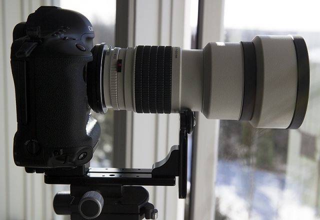

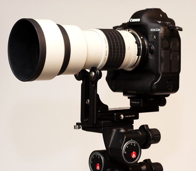

It seems that the vibration is in resonance with the lens. When using long lenses tripod mounted, there is more inertia induced by the shutter movenemt. This inspired me to try a long bracket, and move the whole arrangement forwards so that the camera is again right above the ballhead.
Bingo! Less motion blur.
I consider myself affected by the issue, as long lenses on tripod is where I live very often. Luckily shutter speeds around 1/30 sec is not where I live most of the time. Still the issue has made me keep my D800E a little longer...

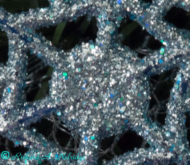

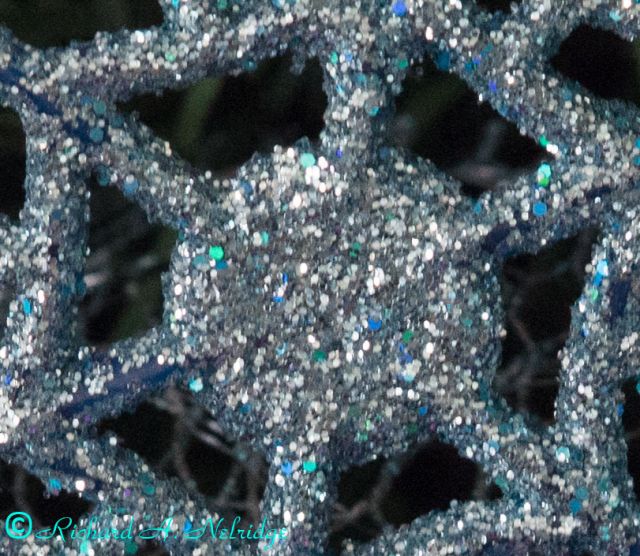

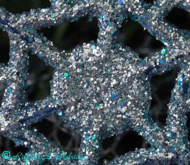

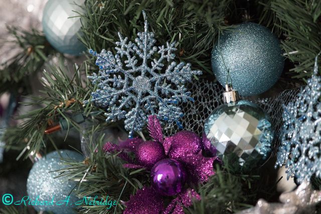

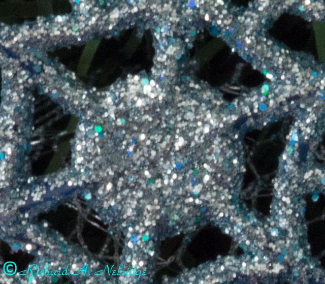

Ok, since there has been so much discussion regarding the vibration caused by I presume the shutter of the A7r particularly with long lenses I wanted to run some tests for myself and to share the results with you. I took photos of our artificial Christmas Tree with my A7r and my Leica 280mm f4 Apo Telyt lens. The lens optimum lens performance is supposed to be at f4. I used the camera tripod mounted on my RRS TVC-24L Versa Series 2 Carbon Fiber Tripod with the RRS TA-2-LC: Versa 2 Leveling Base w/ clamp, RRS, TH-DVTL-55: Round Dovetail Plate, Markins M20 Ball Head, and a Kirk Arca Swiss Type QR clamp. The lens was tripod mounted to the Kirk clamp with a RRS L97L lens plate. In order to run the tests I had to run the tests at an ISO of 2000 so that I could run the lens through all of the apertures so that I could test the shutter affect at f4, f5.6, f8, f11, f16 and f22. I ran the appropriate shutter speeds for each of the apertures. As a second round of tests I ran a second set of tests for the same apertures draping a Gura Gear Bean Bag draped over the Leica 280mm f4 Apo Telyt lens. You can compare the 100% crop at each aperture and shutter speed as indicated in the following photos. It must be understood that after awhile we are seeing the diffraction offsetting the lens performance. As can be seen in some of the images the Bean Bag can improve some of the results. A heavier Bean Bag may have even better affect as well as locking the camera down when appropriate.
The first photo shows the scene that was taken for the images followed by the 100% crop at each aperture and shutter speed. The target for the 100% crops was the light blue snowflake.
Rich
Subject Scene 280mm f4 @f4 for 1/160 sec.
100% Crop 280mm f4 @f4 for 1/160 sec.
100% Crop 280mm f4 @f5.6 for 1/125 sec.
100% Crop 280mm f4 @f8 for 1/60 sec.
100% Crop 280mm f4 @f11 for 1/30 sec.
Dec 12, 2013 at 08:20 PM

The tests and results continue in this posting.
Rich
100% Crop 280mm f4 @f16 for 1/13 sec.
100% Crop 280mm f4 @f22 for 1/8 sec.
100% Crop 280mm f4 with Bean Bag @f4 for 1/160 sec.
100% Crop 280mm f4 with Bean Bag @f5.6 for 1/100 sec.
100% Crop 280mm f4 with Bean Bag @f8 for 1/50 sec.
Rich
100% Crop 280mm f4 with Bean Bag @f11 for 1/25 sec.
100% Crop 280mm f4 with Bean Bag @f16 for 1/13 sec.
100% Crop 280mm f4 with Bean Bag @f22 for 1/6 sec.

280 f4 with bean bag 1/160 and 1/100 are the clearest to my eye.

By the way, I forgot to mention what I posted above were SOOC with the only sharpening done by LR5.3 defaults. I did not adjust anything in the image except crop the images after being exported to PS6 and putting in the copyright notice and reducing the images down to JPEG files. Also the shutter was released with the Sony wired remote cable.

Rich, what is the conclusion? Are we testing diffraction limit or shutter vibration?
