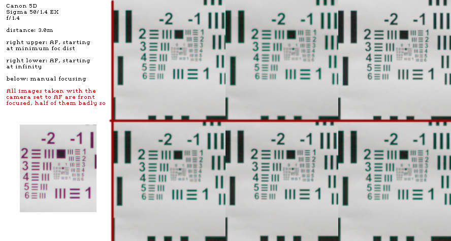

i tested the AF abilities carefully. First with a 450D,
here.
Then i repeated the test with my next copy and a 5D and got the exact same result.
In short: both cameras were freshly calibrated by Canon. Both the lenses were calibrated to the cameras by Sigma Scandinavia. Sigma calibrates the lenses at a 40x focal length distance and in this case it means 2m (although the Siggy 50 is around 47mm only really).
The AF worked fine at 2m distance. At shorter distances I got a front focusing problem and at longer distances a back focusing problem. At very long distances it was a hit or miss (well, 2 out of 20 were a hit).
The image quality is way better than the EF50/1.4 and if the lens construction at least had permitted a smooth manual focusing operation I would have kept the darn thing. Now I'll wait for positive and confirmed good AF results before trying it again.
Cyberphoto (a well reputated Swedish on-line retailer) refused to answer my question about the return ratio. (They also didn't comment my next question which was me asking if I was allowed to ever by another Sigma from them...)
The test result from 3m with the 5D:

Jonas, thank you very much for that test posting. Remind me not to waste time sending in my copy to Sigma Scandinavia...

As you can see in the link I tried the AF in a systematic way and the results were disappointing, in a consistent way. I can accept that not all images are correctly focused but I can't accept having to stop down to f/5.6 to get things within DOF.
I went through the calibration routine as I'm living close to both a Canon Service Center (Mölndal/Göteborg, Sweden) and Sigma Scandinavia (Kungsbacka, about 20 km south of Göteborg).
After having done everything right and double checked it there was nothing else to do but sending also the second lens back. This is a pity. For the moment I'm using an EF50/1.4 instead but i would really like having a fast 50 with good bokeh.
Well, I tried. And btw, the serial numbers were 1001*** and 1002*** respectively. Here is still some hope for the future.
