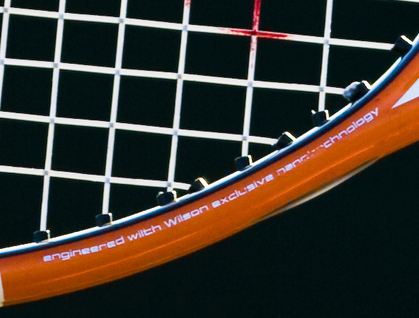

I have used several super -telephoto lenses over the last 15 years professionally. The Canon 500mm F4L IS produces very sharp results - like any super-telephoto lens you have to use good technique.
The following stock images (F4 aperture in both cases) include 100% crops - bearing in mind that the tennis racket was just out of the frame and moving quickly upwards and the golfer's head was not still and still rotating - in this example the lens was not far off its closest focusing distance - framed as seen. Only very subtle Photokit sharpening has been applied and the image can take more.
The AF is very fast on action and very good optically with the 1.4 converter. Bear in mind that the 1D MKIII's outer, cross type AF sensors, will revert to vertical only types with F4 lenses. They only perform in vertical and horizontal detection with lenses of F2.8 and faster - similar end result to the MKII series outer vertical only AF sensors.
