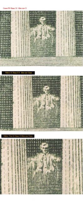

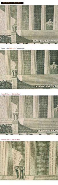

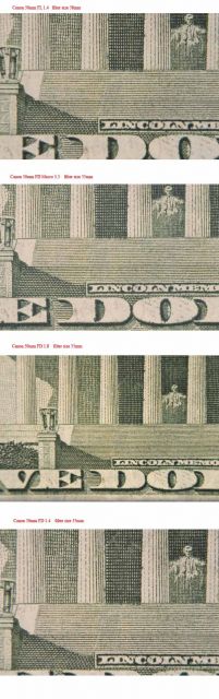

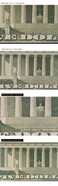

Took some time today to run a comparison between some lens , I started out thinking I would try to find the lens that might be very soft in the corners , but for the most part they all are . Thinking about this further I have come to the conclusion that for bug and flower stuff it doesn't really matter as DOF in the corners for the most part is non existent. What I did find is a great variance in the mag rates for the different lens , specially the wide variance in the 50mm lens . All shots on tripod , trying hard to keep everything on the same plane, all lens set at f 8 and focus set at infinity . All focus done manually ( yes my eyes got tired. ) You can come to your own conclusion.
Hope this helps some, it was a lot of work .

Good comparison Tom- suprised at the different mags from the 50mm lens series- were they all at the same focus setting on the lens (ie either min or max) ?

Yes everything was set at infinity. It did produce some surprises .

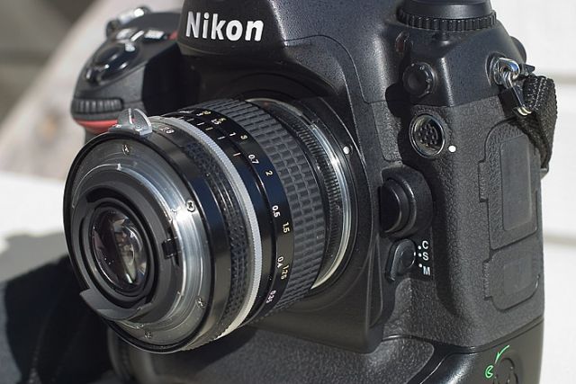

Could you show how you mount the lens to the body reversed? I've seen lens to lens, but not lens to body. Is this a regularly available adapter to the filter? I have a 18-250mm that I held to the body at 250mm and the mag was huge! What would 250mm reversed produce (what's the calc.)? I have a 60mm macro for quality work (nice lens), but the 250mm was fun to play with. I'd love to have a more secure mount than my hands;-)

Follow this link, the one for my canon I made .
http://www.srb-griturn.com/canon-eos-reversing-rings-73-p.asp
http://www.fredmiranda.com/hosting/showgallery.php?cat=500&name=Tom+Hicks

Tom, could you give me the info of the ring or adapter you used for Nikon as shown above in the picture?
I am very much interested in trying this out...man, impressive...
