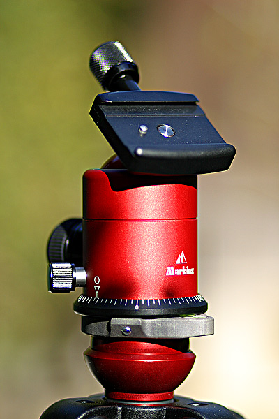

Here's a pic of a wine red M20L. I settled on another ballhead but that's another short story I'm guilty of making far to long.
