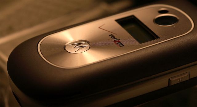

Here is a test shot with Nikkor 55mm/f2.8 Ais Macro lens on my 5D using an adapter cost $11.50
