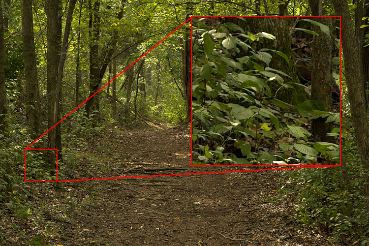

Here you go:
http://upload.pbase.com/douglasjmorgan/90tseframe
I broke it up into 4 pieces and included an overall down sized view.
The lens was shifted 11mm, fully left and is the left half of a panorama. It's converted from RAW with C1 LE, sharpness was at Normal 20,3 (mild) and nothing was done for contrast.
I added a last frame that has been sharpened with USM 300 .3 0. Signing off for the evening.....
Doug
Sep 19, 2006 at 12:32 AM

Samuli: Yes, the TS-E isn't good at the very edge when fully shifted. If you either crop afterwards or limit yourself to about 9mm of shift it is very good. Stopped down (as shown) the edges (below 9mm shift) are probably as good as your 85 1.8. This is also with a full frame camera so I would expect that you'd have no problem fully shifted with the 20D. On full frame it's fairly easy to focus at f2.8. Lens hood works very well since the front lens element is deeply recessed kind of like the Canon 50mm 1.8.
The only lens I've compared it to is the Hasselblad 100mm and this is just a simple flat target: http://www.pbase.com/douglasjmorgan/tslenstests
If you are also intending to use it as a normal portrait lens you might want to look elsewhere. I don't find the bokeh very appealing and f2.8 doesn't give you a lot of freedom for shallow DOF effects. On the other hand it tilts so you have those sort of effects possible.
Doug

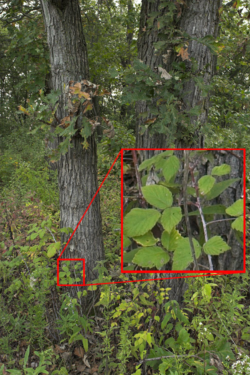

Couple of images what I actually I'm looking for - very small detail / texture (sorry about boring test images - haven't yet had time to do any serious photography with my new Contax and Leica):
LEICA SUMMICRON-R 50 mm f/2 (F8, 1/15s, ISO100)
http://www.vahonen.com/resources/External_FM_20060920LeicaF8.jpg
CONTAX Distagon T* f/2.8 28 mm (F11, 1/6s, ISO100)
http://www.vahonen.com/resources/External_FM_20060920CZF11.jpg
(Edit: Added text with my new Contax and Leica in to the end of chapter before pictures.)
