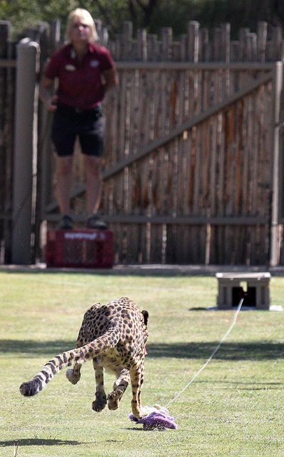

I have very little practice in AI servo shooting. Here, I put it in case 1, center AF point with 8 expansion AF points. I just point it and hit the button.
This is about 70% cropped away, 5D3, 100-400L IS. This frame was at the end of this smoking 3 second run, the cheetah was clocking 70 mph. Notice that all 4 legs are in the air at one time. Acquiring focus while running directly at you or away from you really taxes the AF system. The 5D3 AF is just amazing!
Cheetah at 70 mph
