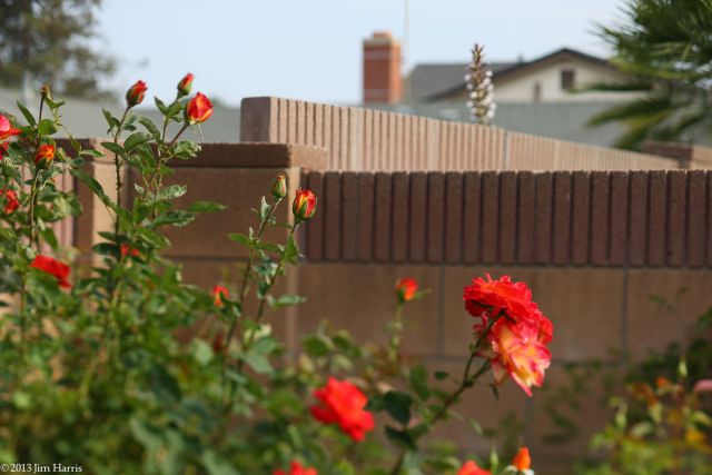

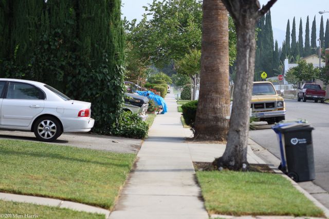

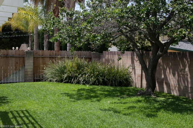

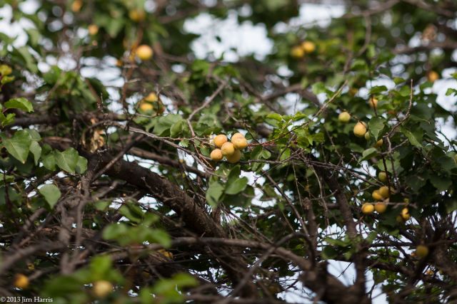

I'll start with the 45 alone, which provides the widest angle, then the 45 + 1.4X (63mm equiv.), then 90 alone, and finally 90 + 1.4X for the narrowest angle of view (126mm equiv.). So, the focal lengths provided by using the 1.4X are: 45mm, 63mm, 90mm, 126mm. A very nice range.
I've tried to make some adjustments to the color, but I've noticed some shifting between the 45 and the 90, and another slight shift using the 1.4X on both. Nothing extreme or out of the ballpark, but a challenge to eyeball for correction. Other PP included exposure, sharpening and check box for CA correction (none really needed on the 90, but the 45 benefits). All shots hand held.
No tilt or shift was used in any of the shots. Another time!

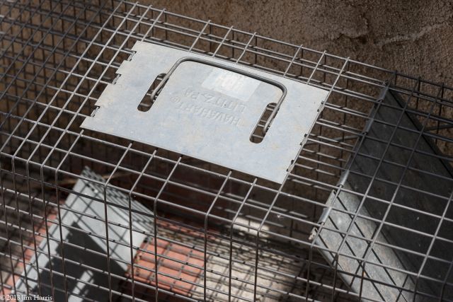

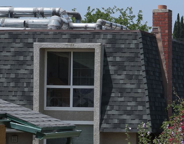

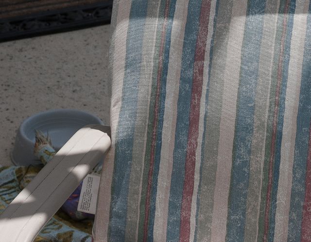

As you will see, resolution is pretty good even on the edge of the frame with the 45 + 1.4X -- see the tag on the cushion of the chair (further down the thread) -- completely readable in the original file.
Wrapping up, here is a little gallery of 90mm TS-E + 1.4X. Slightly more PP was done here, including minor contrast and clarity, and shadow and highlight adjustment.

Thanks folks! Glad to provide the comparisons. Today was much easier to pull off in my back and front yard with flat tables and surfaces, using one camera and two lenses plus Extender! (Yesterday was on location with three bodies and one lens and Extender -- what a juggling act for standing changes out of a camera bag!)
PhotoMax -- Thanks for your experiences. Yes, it is very much a TS-E "super-zoom range". Considering being able to use all the sensor sizes in combination with 1.4X brings the useful equivalent range to 17mm - 202mm (90mm with 1.4X on 1.6X APS-C sensor!).

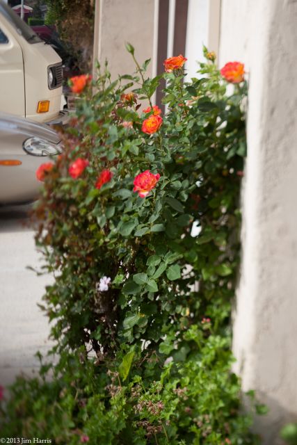

Here are some examples of the 90 TS-E in three tilt settings. The first shot in each set is at zero, not tilt. The following two shot the opposite extremes of tilt on the subject and surroundings.
These are SOOC jpgs with only minor exposure adjustment on a few. No attempt to equalize WB (shot at AWB setting).
No extender used here! Sorry -- rather than start another thread, I added off-topic info here about one of the lenses.
