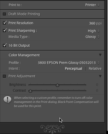

I received 2 custom color profiles and put them into /Library/ColorSync/Profiles. From Lightroom Print module, I can bring in these 2 profiles and they can now be choices. I select one of them as the Color Management Profile in the Print Module and then click the Print button.
In the dialog box that comes up with all the print choices, under Printer Setting/Advanced Color Settings, it does not display the custom profile I told Lightroom to use. I also noticed that the profile changed if I changed the Media Type. I don't want media type of glossy to use Epson's profile, I want it to use the profile I selected from within the Lightroom Print Module. I want to be able to create new Presets to use the custom profile.

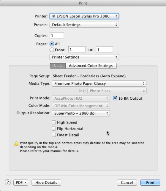

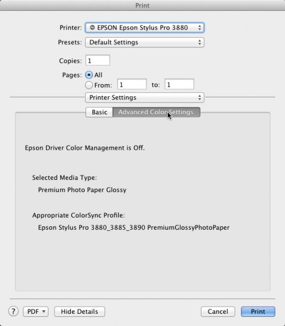

Here are screenshots to show what I was doing.
Even though I selected the custom glossy profile and Glossy media in Lightroom, and then in the Print Settings I choose default for the Preset and select the Premium Photo Paper Glossy, it shows in the Advanced Color Settings it is still using Epson's profile for this paper.

Lightroom using custom prfole
Print settings with default with paper selection
Print settings show wrong profile

You have Color Managment off in the driver. It doesn't matter what the 'appropriate' profile is, the driver isnt using it and Lr is using the profile that you selected.

So you are telling me that even though the Advanced Color Settings shows a different driver than what I selected in Lightroom, Lightroom is still using the custom profile I specified and when the photo prints, it will be printed based upon the custom profile, correct?

Color management is off in the driver. It isn't using any profile. Lr is using the profile.
Anyhow, it doesn't say that a profile as been selected, it says which one would be appropriate.
If you were to select a profile in the driver's dialog and one in Lr, you would be double profiling - something to avoid at all costs. It is difficult to this from a Mac, but very easy from Windows.
