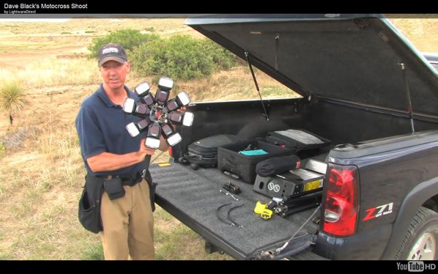

I'm NOT a fan of trying to use speedlights in a 'studio type setting', nor am I in agreement with considering them to be a replacement for portable multiple light set-ups on location. Speedlights are meant for bracket mounting (off axis) type lighting.
How people got pulled into a company's (Canon-Nikon's) idea that using 2 or 3 of these lights in a cluster to perform as a monoblock is purely hilarious. Even with Quantum lights it's a stretch.
To keep the overall cost of this down, and really, make sense in long term ownership. The E640s from Paul C Buff and the Vagabond power system is a pretty good start for a flexible kit for both interior and exterior lights. And whether or not your using Profoto, PCB, 4 SB-900/910s in a cluster.. Attach ANY modifier and use it in windy conditions, your going to need " 40 pounds of sand "... You gotta pick those battles.
The OP asked about a portable lighting kit to take portraits outside. The only reason you see people mounting 3 speedlites on a stand is to do action type shots, not portraiture. The easiest and most portable solution would be a speedlite kit. You can pack multiple speedlites, and manfrotto nano stands in a small shoulder bag. If you used canon 600exrt's then you also have the radio trigger solution included if you use two or more 600exrt's. Lower cost options can be strobist style with vivitar 285's and cheap triggers.

...How people got pulled into a company's (Canon-Nikon's) idea that using 2 or 3 of these lights in a cluster to perform as a monoblock is purely hilarious.
I guess you've got to pay to play. HSS gives you up to 5 stops of additional sync speed but at a cost of power where the flash pulses rather than one big pop like monolights. This pulse sucks up a lot of power which the speedlites are already low on compared to monolights which is why multiple speedlites become necessary. I saw a video on a guy that was big into action sports photography and he used a ranger and PW flex system and was able to get sync speeds of 1/1200-1/1600. He described what components were necessary and he described shooting a white wall and pushing his shutter speed until he saw evidence of the shutter in the frame and then backed off.
I'm sure this is completely overkill for the OP but a small speelite kit is hard to beat.
