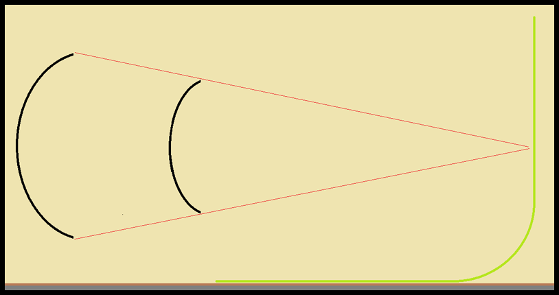

Yeah, it's (relatively) easy to make a large light smaller -- masks, etc. -- but it's harder to make a small light bigger.
I've had a few shoots already using the 5' Octa Softbox Profoto RFi. I just ordered the 3' version to play around with. I personally find the 5' too big for my needs and it is quite big and as I understand you can just move the 3' back a bit and increase power. the only way to find out is to try both of them. :-)
etchen wrote:
...I personally find the 5' too big for my needs and it is quite big and as I understand you can just move the 3' back a bit and increase power.
Moving a 3-footer back wouldn't simulate a 5-footer; to increase the relative size you'd need to move it closer.
I think what he meant is he can move the 3' octa away from the subject and increase the power to increase the coverage, i.e.. light full length images. This would work but it would completely change the character of the light. I still think the 5' octa would be the best choice for what he wants to light, but you should use what you are comfortable with.
