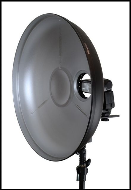

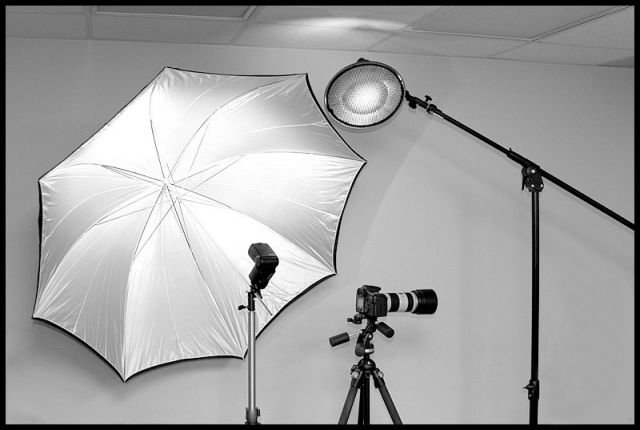

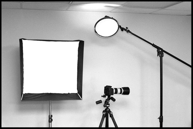

So, what modifiers do I like? I use a Westcott Medium Apollo, which is a 28-inch soft box designed for use with Speedlights (but it can also work with monolights or pack-and-head strobes if you go that route now or in the future). I also have two RPS Studio BeautiDishes; one is a 20-inch beauty dish designed for Speedlights, and the other is a similar 12-inch model that I use as a hair/accent light. Finally, I have the aforementioned umbrella, a 60-inch Photofelx Convertible. (See photos below.)
