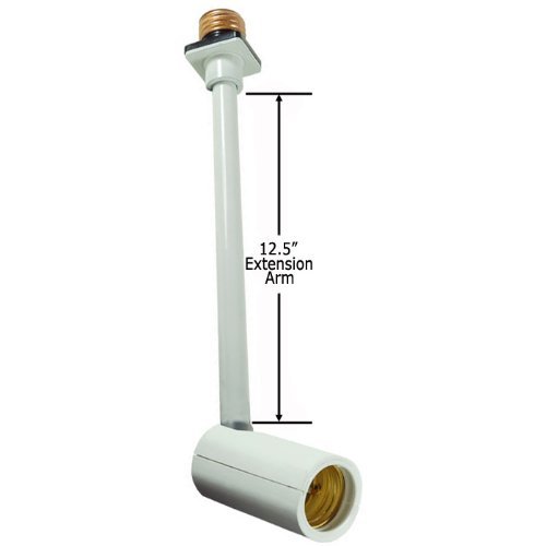

I have two recessed pot lights approximately 48" out from my seamless 9' background and about 5' between them. 8' ceiling height. If i picket up a couple Recessed light Extension Socket 13.25 inch (see pic below) and some kind of screw in AC slave strobe would this work to light background? How could I flag such a set up to avoid spill and would the slaves have sufficient power? As key and fill I'm using speedlites.
Any info would be great

"Sufficient power" depends on many factors, including the ISO setting you use, the aperture you shoot at, the power of your key and fill lights, etc.
The compact A/C slave strobes usually have built-in reflectors, so flagging to avoid spill isn't required. Most have fairly narrow spreads, but there are some that are 180-degrees or more.
As for tirggering, if you use Speedlites in Manual power mode (no preflash), then simple optically-triggered A/C strobes can be tripped in sync with the Speedlites.
Here's one light that would work in the extension device you show:
http://www.bhphotovideo.com/c/product/878203-REG/Impact_sf_ae56_45W_AC_Master_Slave_Flash.html
Note that these kinds of screw-in strobes are almost always single-power units, so you need to measure the background level and then adjust your other lights accordingly.
Frankly, I can see a number of problems with your idea, including relative difficulty in aiming and placing the lights, power level, etc., but if you want to try it the options are out there, and most aren't terribly expensive.

If you have two flashes put them on stands where the lights would hang dialed down to similar power and see what the results are without buying anything.
I don't think they will evenly light the background but with foil snoots the low power ceiling fixtures might work nicely as accent / rim lights.
An option for lighting background it tight space is to make V flats and bounce flashes into them.
V...........V
4 -6 of those little slaves inside the Vs on each side should give you even coverage and sufficient power.
