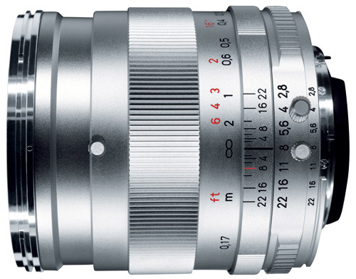

the sort of sealing will not prevent condensation within a lens. they are not airtight ambient air will get in during zoom or focus. they are not filled with inert gas. ambient humidity will reach equilibrium after time both in and out.
and that imposes a few limitations on them. definitely not for someone in a hurry.
since they are manual focus lenses that grow and shrink as they focus you need to disengage the seal manually (see knobs) and then reengage it. this includes removal and replacement of the lens to a body and aperture changes. it will then still allow or draw draw in ambient air containing whatever and seal it within the lens. reality is a multi bladed sword and mother nature will win everytime
