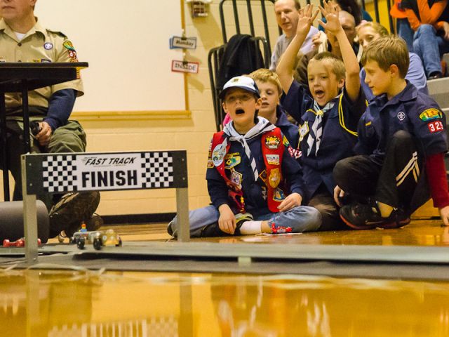

Thanks for the feedback - unfortunately I couldn't quite get it set up how I was hoping - I tried a few different combinations - rear sync flash / panning - but it just wasn't working out right.
The panning didn't work because when I pan a shot I want the background to blur giving the sense of motion - where I could get set up there was nothing in the background (think blank wall) so there wasn't anything moving in the background to give me relative motion.
The rear sync was odd - I figured out how to rear sync the flash but my camera kept giving me a "preflash" at the beginning then a full flash at the end. I'm sure it's a setting I need to fix.
So after about 10-15 raced I figured hey I better get some actual shots here and leave the creative ones for next time :-(

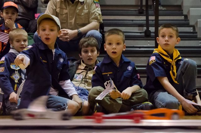

Nothing odd about it; that's the way it works. The preflash is for metering the scene in ETTL mode (just before the shutter opens), and the full flash is for exposure. In front-curtain sync the second flash happens so close to the pre-flash that you may not notice it, but in rear-curtain sync it happens just at the end of the exposure.
In Manual flash mode there would only be the flash at the end of the exposure; no metering pre-flash.
Your first shot shown was at 1/250 and the second at 1/200, so there's no motion blur. A slow shutter would have blurred the cars, but also blurred the boys (and who could expect a bunch of excited Cub Scouts to hold still), so I think they turned out well for capturing the moment.
The second is my favorite; I love the varied facial expressions! The selective DoF keeps one from being torn between looking at the boys and looking at the cars as the main subject(s).
Using a slow shutter and 2nd-curtain sync would have been good if you were shooting just the cars, from one end of the track as they sped toward you for example.

The best thing about the two shots that you posted isn't the illusion of motion but the fact you got down eye level with the kids and are showing the action from their POV.
