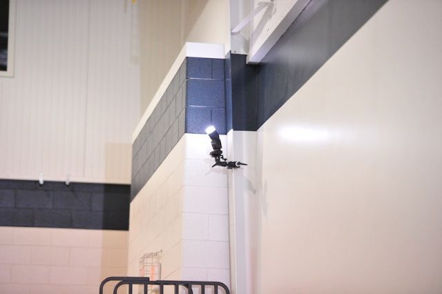

Appreciate the help on my last post. I took some advice from Max and set the 2 speed lights sb800 behind the basket and aimed at the Key, I gelled them green and set to fluorescent, I also shot a quarter with an CWB.

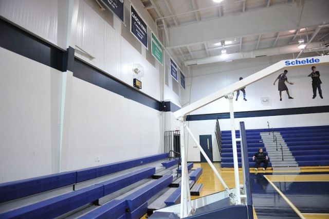

Ambient in this gym is 2.8, 640 iso 10k or 12,800, there are hot spots due to the pendant lighting. Set Speed lights to manual 1/2 power on TT5 and TT1 mounted on camera. Dropped Iso down a touch and also experimented with 500 shutter speeds. I was happier with the more consistent color balance, but still feel like the light isn't quite right? suggestions? Most of these are only cropped and straightened. All w the D3s 24-70, shot some with 70-200 and a few w the 300. camera set to 1/250(fp) Appreciate the help
light set up
second light

Looks like you are getting color shift off of those sodium lights.
In your second image, look at the difference between the 2 lights in the top of the frame. One is very pink/magenta. That is a big part of your problem, not all the lights are the same. I see waves of that magenta in the other images as well.
Overall the images look pretty nice (considering that color shifting), but I agree that if you are going through the trouble to strobe, you should not have to be at a high ISO. I would think that if you can't get under 2K ISO, you need to revise your tactics.

It looks like you have a diffuser on the speedlights. If you want to bounce the light off the ceiling I would take the diffuser off and zoom the speedlight to its maximum zoom setting.

pull the diffuser. you lose a lot of light doing that. Also, rather than bounce, have the light go direct.
