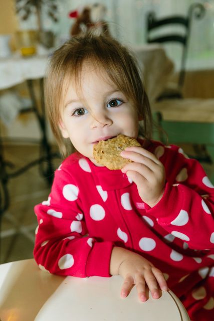

this won't win any award, but for a quick and dirty family moment it works for me. i used a bare 600EX and bounced of the ceiling. i believe i had the white card extended to get the small catchlight in her eye.
  Canon EOS 5D Mark III    57 mm    f/4.5    1/200 sec    400 ISO    +1.3 EV

Greggbhill wrote: ...i used a bare 600EX and bounced of the ceiling. i believe i had the white card extended to get the small catchlight in her eye.
That doesn't look like ceiling bounce to me; judging by the placement of the shadows it looks like the light is coming from low to camera left, like an on-camera Speedlite with the camera in portrait orientation, or maybe wall bounce.

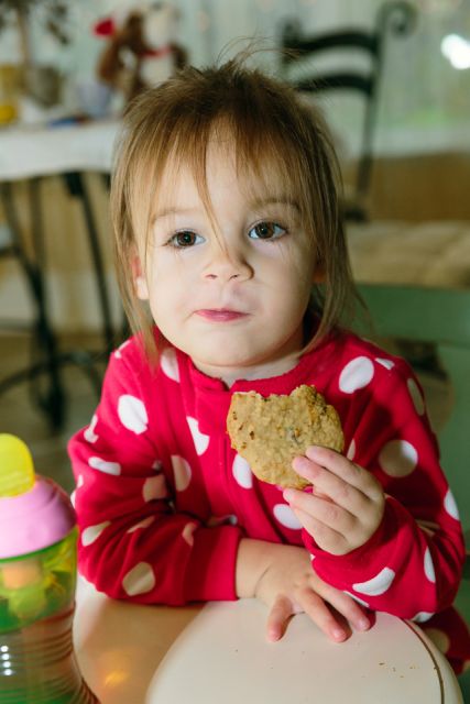

ok, i had to go back to the room and look at it again. i had the flash pointing up (on-camera), angled one or two notches (~ 45 degrees) for my other room where i was bouncing off the (tin) ceiling with the camera in landscape orientation (first shot). the cookie series was shot with the camera in portrait orientation. i don't think i swiveled the head, so you are right about it not being ceiling bounce.
i was trying to figure out what cast the shadow in the foreground - a prior shot shows it was her juice bottle (second photo).
  Canon EOS 5D Mark III    47 mm    f/4.5    1/200 sec    400 ISO    +1.3 EV
  Canon EOS 5D Mark III    61 mm    f/4.5    1/200 sec    400 ISO    +1.3 EV

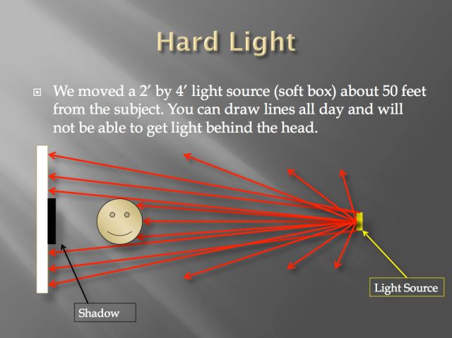

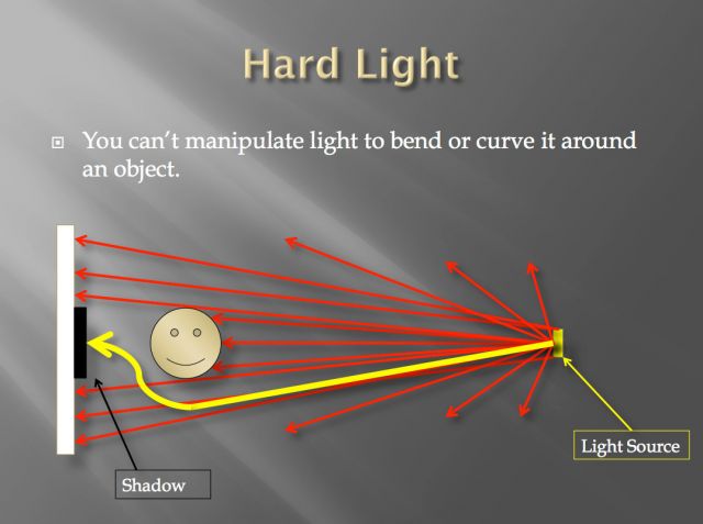

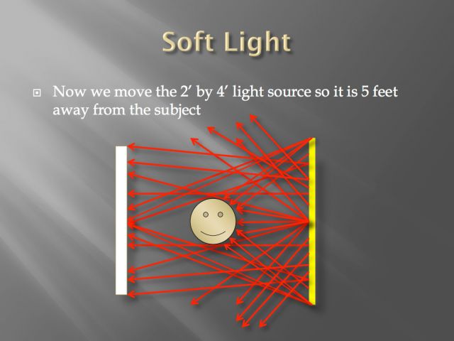

That is the exact problem - you are spreading light and most of it goes off in directions and does nothing for you. Light travels in straight lines. As stated it is all all bout the size and distance to the light source. "All" diffusers are bound to these basic laws of physics. There is no magic bullet.
I know that you can't correctly illuminate an object from 50 feet but just go with it for the demo.
