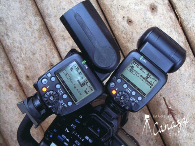

Yes you can do ETTL on camera (no remote unit) or in radio mode with two units (On-camera MASTER and one off-camera SLAVE). They just have to be set to HSS on the flash units. I have posted a photo here of what the units should look like when set up properly.
A bonus - press your DOF button and get the modeling flash feature.
600EX-RT Set up on Canon 5D2

p.1 #9 · Canon 5d mark II and 600ex flashes
Thanks again, I will be looking at this tommorow.
My slave is set to channel C, but obviously with the master set to "ALL" , it won't affect the outcome.
