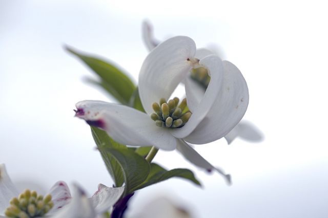

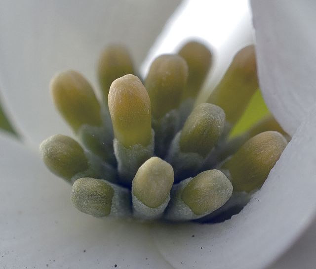

sjms
p.1 #5 · which longer macro lenses for D800?
Sigma 150mm/2.8 OS Macro
crop
  NIKON D4    150 mm    f/6.3    1/500 sec    100 ISO    0.0 EV
original
Edited on Dec 16, 2012 at 11:50 AM · View previous versions
Dec 15, 2012 at 11:54 PM
