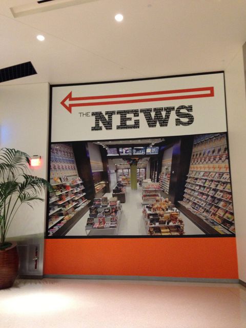

p.1 #15 · Large prints w d3s
file size means nothing, viewing distance is everything.
Where will this be seen? how far away are the viewers? ive shot billboards with 4mp cameras. ive also shot a 80x120 image (upressed with Genuine Fractals) for a shopping mall w my d700.
this was with a d700
Here is what it looks like up close, at an arms length away. Dont be fooled when people say you need X amount of MP to print big.
Edited on Dec 07, 2012 at 09:55 PM · View previous versions
