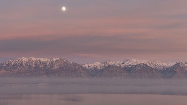

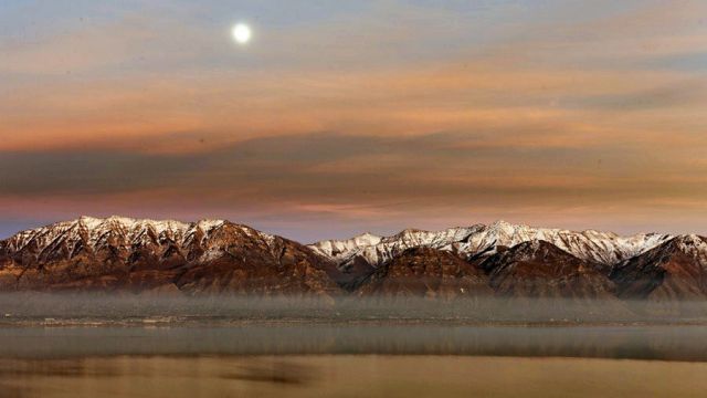

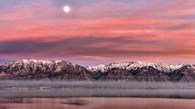

I was scouting for a good place to shoot The Wasatch range with a Utah Lake foreground. (This is not it) and on the way home saw a sunset developing. I stopped here for a shot. The longest lens I had with me was 70mm so here is what I got.
That is not fog over the lake, its smog. As you can see from the SOOC it is pretty flat, but that can be fixed with curves.
I am especially thinking about how to fix the color cast. I have already worked on magenta, but if I do it globally it ruins the sky so I just did the mountains.
I also worked to get rid of the moon halo which was caused by thin clouds. I used two tricks Karen taught us. Masking the moon and putting that on another layer then using content aware to clean up the halo.
This image does not respond well to processing without some NR even though its shot at ISO100.
Fix anything, and make any suggestions that apply, but my primary concern here is color cast.

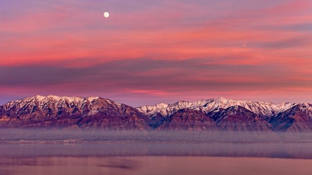

my version
sooc

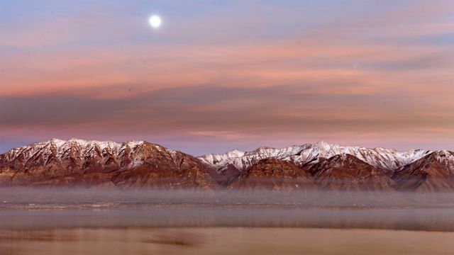

Ben,
This would be my take on your image, not necessarily correct, I basically removed magenta/added green in the lightroom white balance slider. I like your image a lot, by the way.
DISCLAIMER: remember I'm really new to photography and the image below is not guaranteed to be safe for viewing
EDIT: well it should be since it's Ben's image, however I did some editing and who knows how far I might ruin other people's work?
Edited on Nov 27, 2012 at 02:03 PM · View previous versions

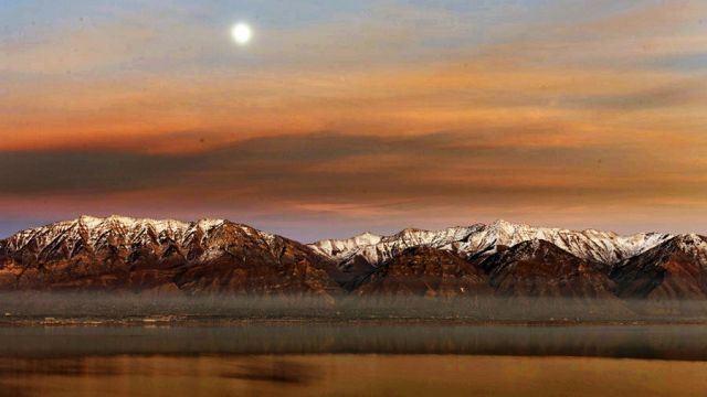

Oregon Gal
p.1 #4 · need some color help
Ben, a re-work in LR, warmed the overall color balance then broke the image into 3 parts and adjusted them separately, while not 100 correct, removed the color cast from the image. Barbara
Edited on Nov 27, 2012 at 06:30 PM · View previous versions

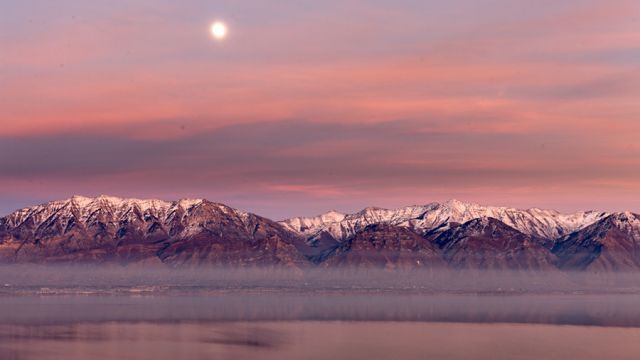

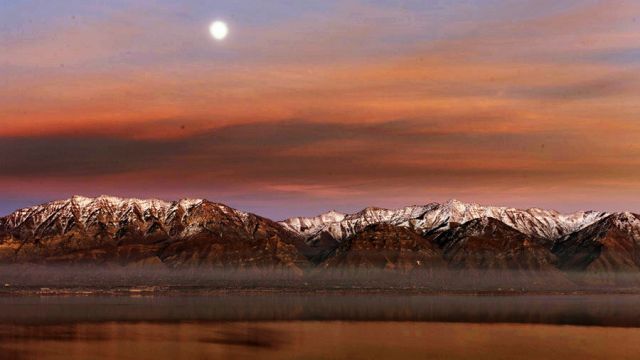

I didn't do anything with the moon or crayon play, but here's a stab at what I think you're asking for ... i.e. neutralize before play.
Then some curves / sat play afterwards.
Edited on Nov 27, 2012 at 03:25 PM · View previous versions

RustyBug wrote:
I didn't do anything with the moon or crayon play, but here's a stab at what you're asking for ... I think.
For the mountains yes, I really like the sky I got but not the rest. So what did you do? I could see applying that to the mountains.

gneto wrote:
Ben,
http://farm9.staticflickr.com/8065/8224996210_3589a17ab9_b.jpg
This preserved the sky color although at a different hue. I was not able to change the sky without losing most of the color I wanted.

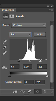

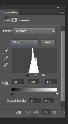

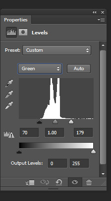

If you go into levels or curves and set your black/white end points in the individual Red, Green & Blue channels ... followed by adjustments to the RGB composite channel, it serves as a starting point toward neutral. Subsequent, layers, opacity, masks ... you know the rest.
I typically go into color balance and play by the numbers @ known neutral. This time, I went to the individual channels @ levels/curves. Here is the blue in levels first ... followed green & red individually. After setting all three, you might go back and tweak to taste either @ R, G or B ... or RGB.
Edited on Nov 27, 2012 at 03:39 PM · View previous versions

Here ya go, did I do this right? Still looks to brown to me.
This is just the individual RGB channels, I did not change the composite, wanted to take it one step at a time. I took each one right to clipping, looks like that's what you did.

p.1 #13 · need some color help
Essentially the same.
Now that you've got a baseline, tweak to taste via opacity, masking or other layers, etc. ... to allow the colors of light show through where you want them, or don't want them.
I thought you wanted to preserve the sky while changing the white balance, so this was the best I could do that still felt somewhat close to the feeling I had regarding the sky in your original image.
However, I believe the answer to the "correct colors" question can't really be given by anyone but yourself. You were there at the moment, so only you can remember how your brain rendered the image for you at that moment and try to reproduce it in the photo. Our brain plays tricks on us regarding color perception and white balance (as I'm sure most of the people posting on this topic already know). Probably that's why you feel the sky is very good in your original, but the mountains are off - your brain compensated the cast on the mountains while allowing you to view all those purples/pinks in the sky exactly as they were. Probably the white balance for the sky will have to be done separately from the white balance for the rest of the image.
Oh, and I'd like to say also that I'm amazed by how well RustyBug "recovered" the colors of the mountains. Perhaps a composite with his mountains? ...

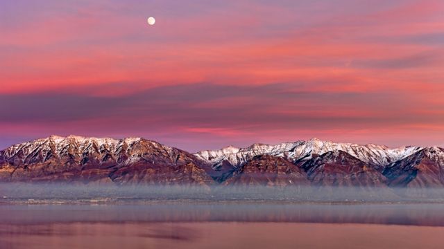

Ok, I applied Kent's method to the final image and applied it only to the mountains and smog. I left the water purple because I liked it better that way.
This is sort of what I wanted. Now that I have made a choice, whatcha think? There are two things here, how to do it and how to know when you are there.
here is a color corrected mountain version

I like your last version a lot, and find it to be a real improvement over the original version.
Just for the sake of comparison, if possible, I'd like to see one more version with the foreground/lower part of the image also color-corrected like the mountains.
There are some artifacts in the border between the mountains and the clouds, where some regions of the sky are color-corrected to match the mountains (by mistake I assume) and vice-versa.

Ok, I will do it. I painted the color correction in and did a crude job. This scene does not mask well because the color transition between sky and mountain are not sharply defined.
color correct including water
