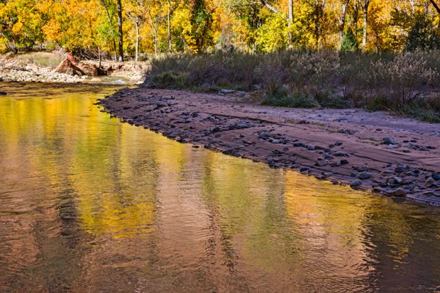

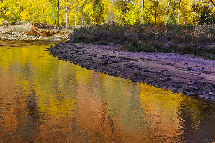

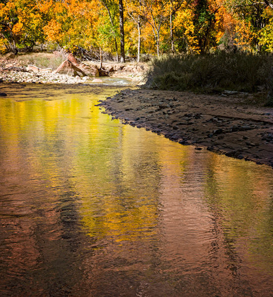

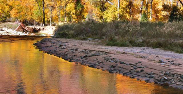

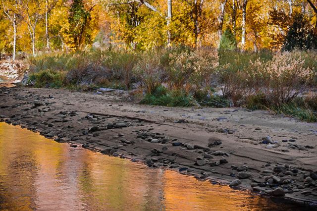

Ben ... yes, I understand you aspire to better show the red sand to your viewer, thus inquiring @ possibilities. I hope this doesn't come across as anything other than my sharing my philosophy regarding "blue snow". I just think that while it is true when people say that the blue cast naturally occurs in the shadows, that doesn't do much to help with the objective of showing your viewer what it is that you want them to see. I was actually a bit surprised to see the grasses reveal themselves as much as they did on this one.
I just wanted to toss out that you might consider bracketing a bit wider than you have been. As I embarked on the dialogue @ variance of exposure between front and shadow, it just seemed to naturally warrant the color variance also for those who might have not previously considered it (as I know your already have).
HTH
The red sand is a tricky one. Lacking a good neutral reference, I first tried to bring G & B into nearly equal value allowing R to be dominant. That didn't seem to render the "red sand" red enough, so I went into the blue channel for additional blue mitigation ... and just kinda eyeballed it from there. I probably need to revisit it, predicated on what I learned of it in "Round 1" ... but hopefully it at least shows some potential for the purple sand to become red.
BTW ... Barbara's sand color is in the right direction as well. Maybe she'll share her approach to the sand.
The really tricky part of this one is going to get the sand, reflections and background to harmonize (even after figuring out the corrections) into plausible realism with tonal & saturation adjustments etc. As a learning exercise / skill builder ... this one is quite the challenge. It might be one to visit & revisit as a litmus test to your PP skills as you learn new techniques.
As always, S&P to taste.
