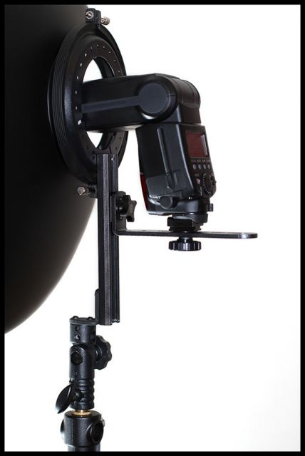

Note that the above only applies to umbrellas and to umbrella-type soft boxes like the Westcott Apollo (which I use). Other types of soft boxes have their own mounting devices that vary depending on the brand.
Some are similar to the device shown below on my BeautiDish. You'd only need to unscrew the cold shoe and screw the knurled nob into the PX bracket instead:
