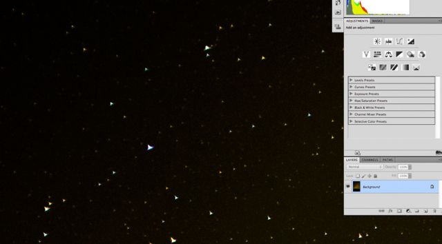

I've got a bad case of batwings going with my night time pictures of the Aurora Borealis. scaled down it's not so bad but at 100% (20.533" x 13.6") it's pretty bad. My setup is:
Nikon D7000
Sigma 30mm f/1.4 prime lens
tripod
remote shutter release
shooting in mirror up mode
I've attached a small image and also a screenshot of the upper left hand corner of the same image at 100%. I'm quite sure that the lens is the problem, what do I need to buy or do to correct this problem?

What is your exposure time? Does the whole image look like this at 100%? Or just the corners?
My first guess is camera movement, followed by a long exposure with no tracking set up, so the stars are starting to trail. More info would help...

It's the lens. Do a bit of research on "coma" and you'll find out what exactly causes this effect. BTW, many lenses exhibit this behavior to some degree. There are some lens reviews that actually look at this, for example: http://www.lenstip.com/190.7-Lens_review-Sigma_30_mm_f_1.4_EX_DC_HSM_Coma_and_astigmatism.html
To lessen the problem you could stop the lens down to f2 or f2.8. Of course this means less light.

The exposure time is 10 seconds I believe at f/1.4
The arrow looking stars are always in the shape of a V at the outer most portion of the images pointing away from the center of the image. I suppose I bought the wrong lens. Just wondering what lens would give the best results for what I'm doing.

I agree with plubbry - lens coma is your issue. Not much you can to remedy the problem other than stop down. It seems fast primes are prone to coma; I believe Canon's 24 f/1.4 L has this issue as well.

Looks like coma to me, but could also be a mixture of slight trailing too. It's challenging to get a wide, extremely fast lens on a crop camera (however I'm not too familiar with Nikon lenses). I would consider an ultra wide 2.8 zoom such as the Tokina 11-16 2.8, which will allow you to lengthen your exposure time without trails, especially at the wider end, however I have no clue how the coma is on that lens. I would also do a search about FL/FOV and SS time for stars to prevent trailing.
In this case here as well you could do a Vertorama and stack/stitch, then crop out the borders to remove the coma.

the nikon 14-24 at 2.8 shows next to no coma either.

Definitely you lens suffer from coma. You need a better lens with aspherical elements. Or at least stop down more and or crop out the edge of the frame.
Astrophotography is very demanding.
