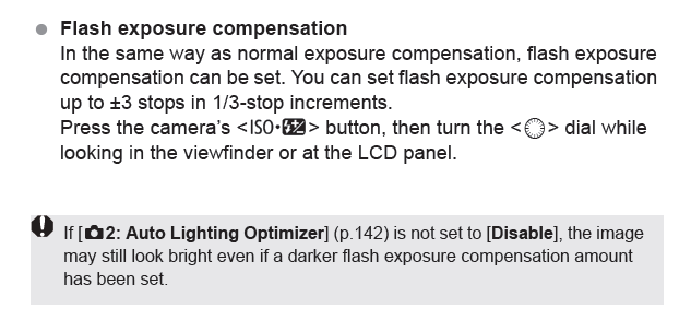

SwampYankee wrote: Whats FEC (Flash Exposure Compensation?) and how do I turn it on/off?
Yes, it's Flash Exposure Compensation. It allows you to fine tune what the camera thinks is the proper flash exposure, independently from the ambient exposure. If it's set too low you'll have under-exposed flash.
It's on page 188 of your user guide.
Nov 11, 2012 at 10:04 PM
Gochugogi
p.1 #8 · Original 580 EX flash does not work so well with 5D3
First, be sure the mode dial is set to the "Creative Zone," e.g., P, Av, Tv or M. Press the Quick Control button (between QCD & joystick). You'll see a screen showing most user controlled functions. The icon with a electric bolt and +/_ shows if FEC is set. If it reads, -2.0 or -3.0 you know what the problem was. Select the icon with the joystick, and turn the wheel to zero it out.
If you bought a used 5D3 the previous owner may be used a CF to assign FEC to direct QCD input. In such case it is easy to accidentally set it.
Nov 11, 2012 at 10:09 PM
