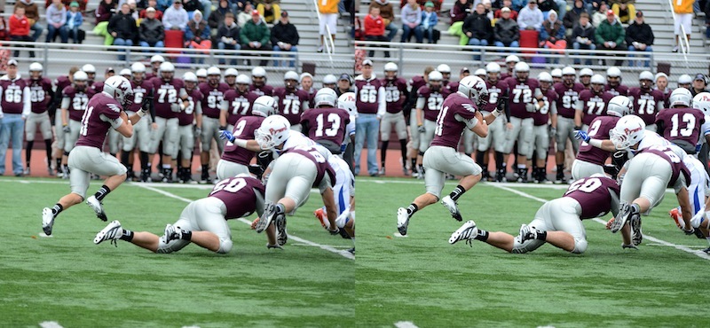

Work on getting that shot in focus...and these don't appear too far off. Mike...did you use any sharpening on these? I took you 6th shot and just ran a little USM on it and that is it and it addict a bit of crispness to it. The retouched on is on the right.

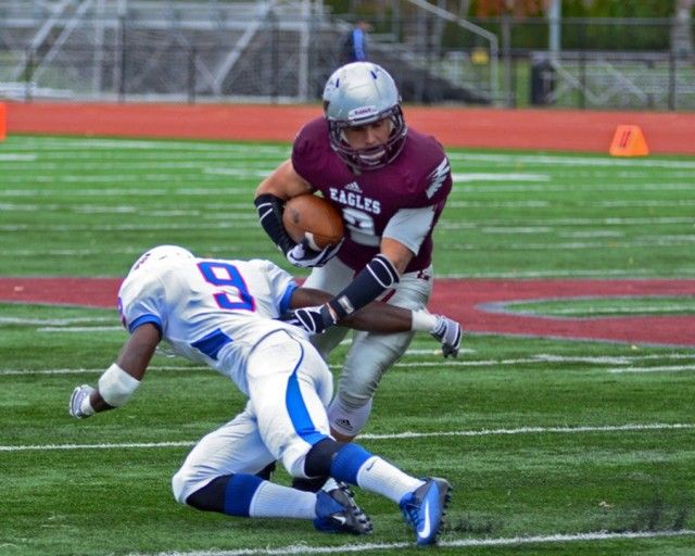

I shoot football with the D7000 & nikon 80-200mm 2.8 combo.
A few tips here to make you better on camera setup.
I use the 39 pt dynamic area setting.
I've tried the single, 9 and 21 pt. But the 39 gave me the sharpest pics. You just have to play with it and see what gives you the sharpest pics.
Turn it to M mode.
Set iso on auto and max at 6400.
Shutter set to 640 and above(preferred 800+).
Depending on light set aperture to f/2.8 - 4.
A couple of samples from my D7000 and setting used above.
